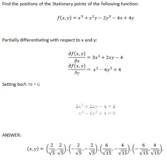

So i'm wondering if anyone can help with a problem i'm stuck with.
It's a Partial Differentiation problem and finding Stationary Points.
The problem:
https://i300.photobucket.com/albums/nn6/ElScampio/Maths_zps74166d91.jpg
As you can see, partially differentiating is no problem. I set both equations to 0.
The problems is now doing the maths where I have a singular value for either x or y which I can put back into the equations to solve for the other variable.
No matter which route I go down, I don't get anywhere near the answer.
Anyone any ideas?

This is of an revision sheet for exams I have in Jan. They do give answers to some of the questions. The idea of giving the answers is so you know you are doing it correctly and thus build up your confidence in what you are doing.
I'm only in the 1st year and the Maths part is vitally important for setting the underlying knowledge for the rest of the course. So I guess they do try and help so you understand as much as possible before we get hit with the complicated stuff in future years.
Im-a-Ridah wrote:
I know the process for doing it and can happily do it for less complicated functions. This one though is seriously tough. Unfortunately no matter how much I try, my algebraic manipulation skills aren't good enough Crying or Very sad

Use the first equation to find y in terms of x. Plug this into the second. Rearrange to find a quartic. NB x^4 = (x^2)^2

I fired it into Wolfram Alpha and it helps in show where the max,min and saddle points are on the plot.
Unfortunately it doesn't explain how they got the answer Crying or Very sad
Yep, I know the process of doing it and can do it with simpler functions. It's just this function is pretty tough and i've struggled getting from equation to 0, to getting to the stationary point co-ordinates.

3x^2 + 2xy - 4 = 0 gives y = (4 - 3x^2)/2x
Stop telling yourself this is difficult and just do it.
