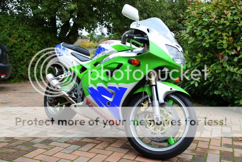

Bought as my first big bike, and to use as the daily hack while I'm at uni as my 205 was crazily thirsty on petrol.
Bought her in September after I had passed my test, reasonable price considering her age and milage (62k km) and a few issues to boot!
Here's a couple of pics of the ol'girl!
https://i150.photobucket.com/albums/s92/jamieanderton1/270398_10151072458806261_358995494_n.jpg
https://i150.photobucket.com/albums/s92/jamieanderton1/548424_10151072458851261_1005896163_n.jpg

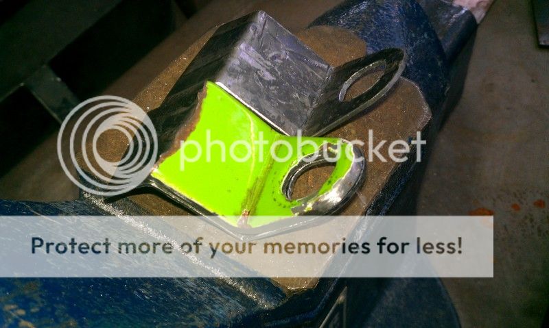

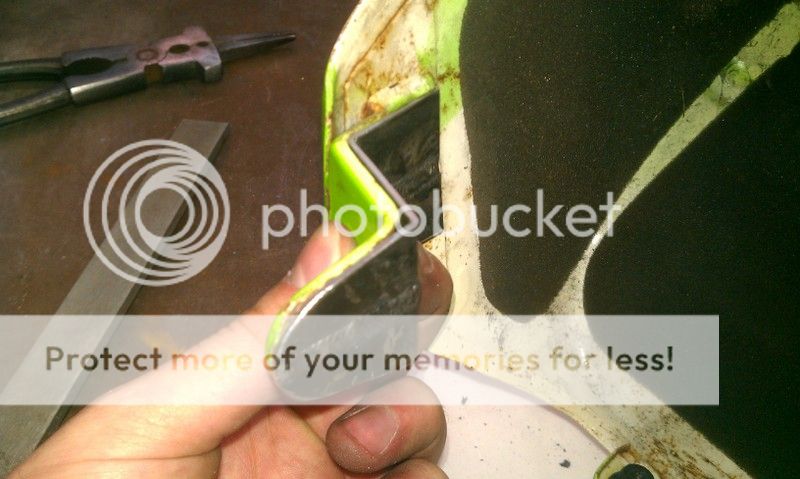

First problem was that the tank was loose and was knocking about when I went over any bumps, I was assured it was a missing bolt so thought it would be easier enough to sort. Upon checking I found that not only was the tank held in place by only one bolt, but the nearside bracket on the front had sheared clean off!
Top top all this off I managed to get a piece of 12mm long flint stuck in the rear tyre, which was nearing the limit anyway, but got to the bike one evening at college to find the tyre was flat....
Time to get a few things sorted on her! Luckily I hadn't yet sold the 125 so had transport for the week and managed to find a part work, almost new Dunlop sport qualifier II to replace the one on the back and keep the tyres matching!

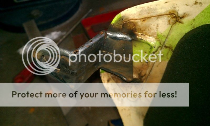

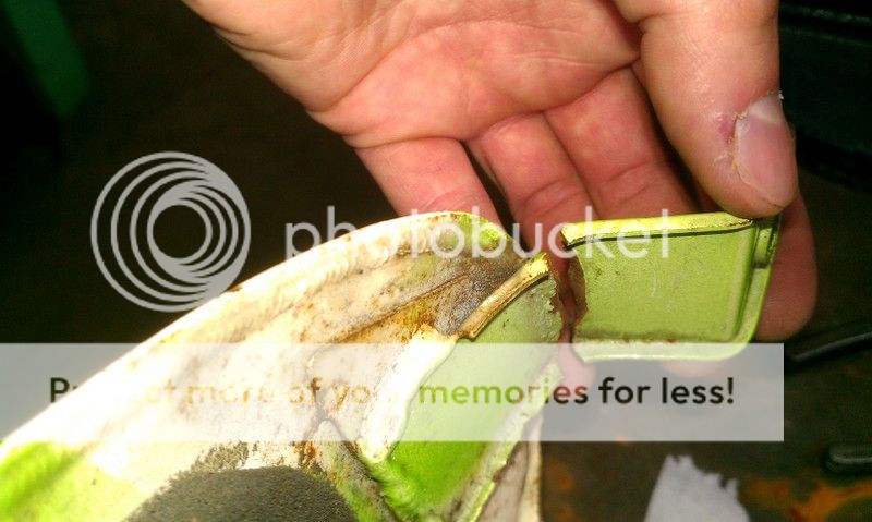

Pulled the tank off with the intention of getting away with welding the bracket back on! Found that was a no go because the repair would have been far too close to the seam on the tank (Boom) so with advice from my welding tutor at college a plan was formed!
https://i150.photobucket.com/albums/s92/jamieanderton1/IMAG0373_zps372c07eb.jpg
Broken bracket

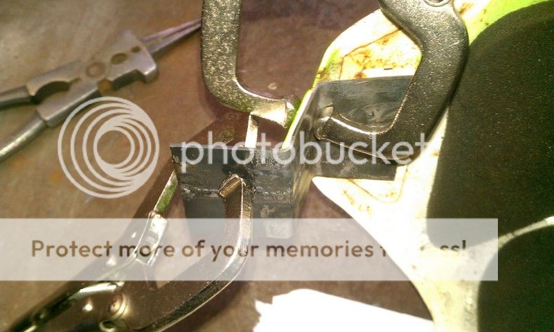

Couldn't weld onto the tank itself, but the remains of the bracket were still there, and a good 5-6mm away from the tank wall, so the plan was double skin the bracket!
I knocked up a pair of brackets to seat inside the originals using 3mm mild steel plate
https://i150.photobucket.com/albums/s92/jamieanderton1/IMAG0376_zps21ca4d99.jpg
Bending to shape
https://i150.photobucket.com/albums/s92/jamieanderton1/IMAG0379_zps540bff12.jpg
Profiled
https://i150.photobucket.com/albums/s92/jamieanderton1/IMAG0385_zpscb955005.jpg
Completed pair

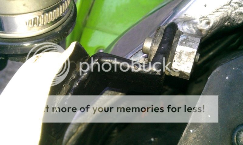

After a week of venting the tank I bravely allowed my welding tutor to attack it with the MIG welder (I quite like my eyebrows....and hair...and skin.....)
https://i150.photobucket.com/albums/s92/jamieanderton1/IMAG0389_zps9e19e0a2.jpg
Bracket seam welded in place
Then after a few coats of matt black to stop it from rusting, but brackets were sorted and far stronger than factory standard!
https://i150.photobucket.com/albums/s92/jamieanderton1/IMAG0392_zpsbfa85a1d.jpg
Finished article
Popped the tank back on and she's solid as a rock Very Happy

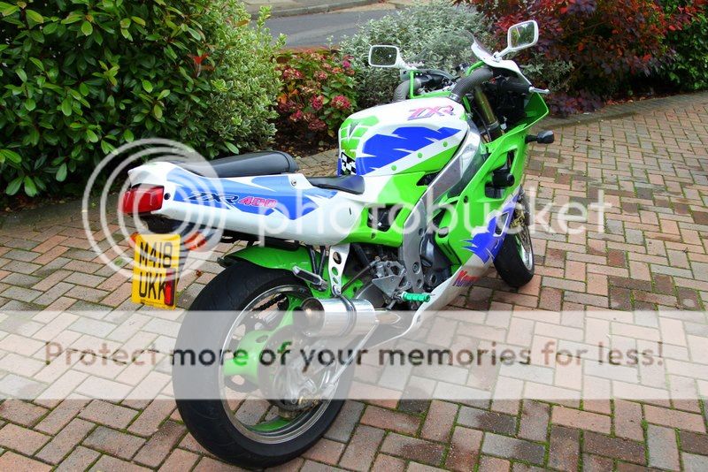

Oh, a quick snap of her in the new forest this evening, sun was out and I was home by 3:30, would have been rude not too!
https://i150.photobucket.com/albums/s92/jamieanderton1/841072_10151213881196261_1480224986_o_zps723fca0b.jpg
Got to love rush hour in the new forest Wink
