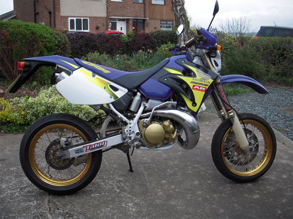

PostPosted: 19:59 - 13 Feb 2013    Post subject: Reply with quote
yes take a look on my site (crm250.com)
better suited to road and light trail, dont let the name confuse you with a CR250 - they are certainly not even close.
capable of being held flat out all day and will nudge 100mph with the right gearing / jockey.
reliable and low revving for a stroker.
swingarm pivots seize, balance shaft bearings can rumble, heavily used off road bikes rot the loom and can have PGM issues and borned out power valve motors with seized cables.
Fork tubes can turn to powder if the outer coating chipped.
Mk2's are cheap as chips and great fun
Mk3 the best of the bunch but comes in some lairy colour schemes.
AR commands big money for a nice one, no "better" than the Mk3 apart from being more complicated, but is the looker and the one collectors want.
I am out at oulton park this friday on my AR and while gets snotted on the straights, it makes a mockery of some other stuff around the corners.
