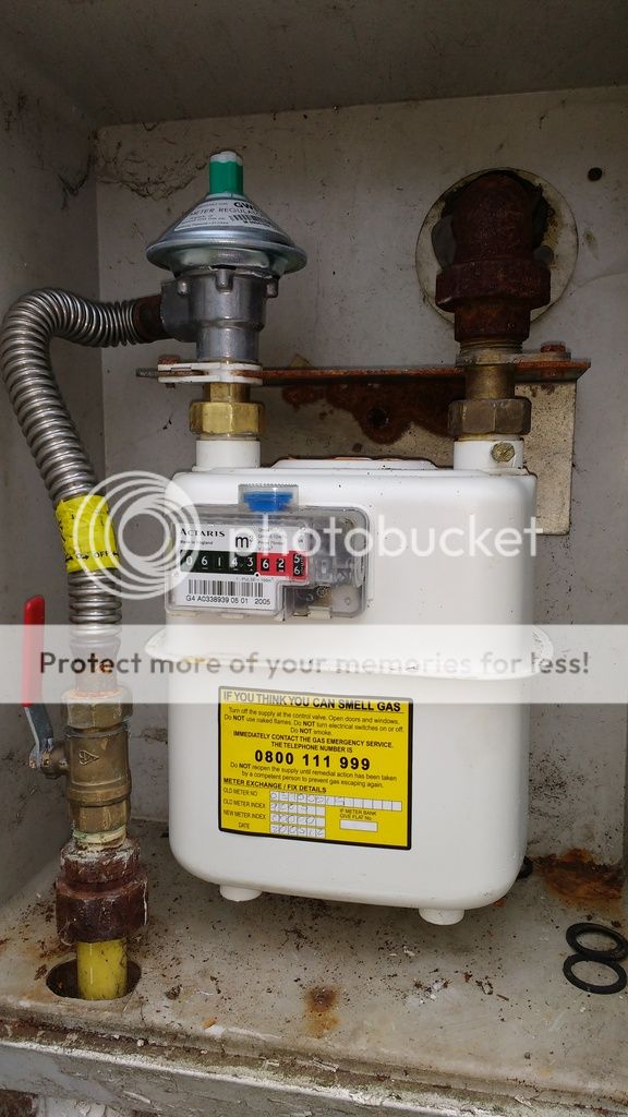

2nd "At risk" was that the gas meter doesnt have an earth connection, or an equipotential blergh...
https://i214.photobucket.com/albums/cc49/Evil_Sheep117/IMG_20160525_175514699_zps2qxly7oz.jpg
Gas meter, no earth here... but as soon as the pipe goes inside.

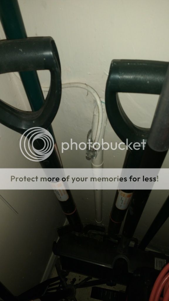

https://i214.photobucket.com/albums/cc49/Evil_Sheep117/IMG_20160525_175401252_zpsv6l7cokj.jpg
Theres a tab round the pipe, with a wire that goes into the fuse box, green and yellow wire

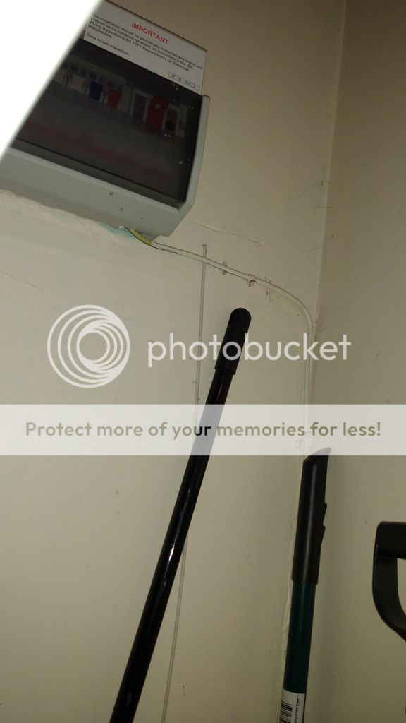

https://i214.photobucket.com/albums/cc49/Evil_Sheep117/IMG_20160525_175419656_zpskw9ucuk3.jpg
Is this not enough earth? Should there be one on the outside?

Earth bond is perfectly fine, within 600mm of where it enters the property.

Point of entry is acceptable for the earth so that's no problem. The cable should be 10mm aswell which it doesn't look far off that from photos.

as for earth its fine.

The bonding wouldn't be classified as 'at risk' even if it was missing, on the unsafe situations book it just says to
'Leave a bonding notice informing the responsible person that protective equipotential bonding work should be checked/carried out by an electrically competent person'
They did away with the 'Not to current standards' classification.
