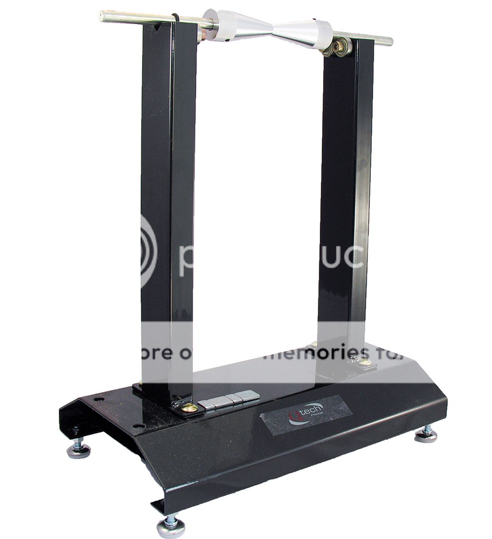

I have 2 tires to change on my WR250, 2 tires to change on my GSXR and my brother who has 2 bikes require new tires on both his bikes.
I often buy rubber off ebay and get a garage to fit tires to loose rims and often pay about £10 a rim on average which also involves 20 minute tip too and from the garage.
I like to do absolutely all mechanical work on any bike i have owned myself to gain experience, but have always paid others to do the tires.
Who on here changes there own tires?
Its going to cost me and my bro approx. £80 for tire fitting labor for the 8 tires that need replacing.
Should i buy this
https://www.ebay.co.uk/itm/Motorcycle-TYRE-CHANGER-Workshop-BEAD-Breaker-Stand-/230926055116?pt=UK_Cars_Parts_Vehicles_Other_Vehicle_Parts_Accessories_ET&hash=item35c443f6cc
https://i228.photobucket.com/albums/ee149/leaforge/Stands/Stand11.jpg
and this
https://www.squirrel7.f2s.com/Shop/BikeIt/TYC008.jpg
https://www.ebay.co.uk/itm/Motorcycle-WHEEL-BALANCER-by-Qtech-Stand-Track-Day-PORTABLE-/230926058412?pt=UK_Cars_Parts_Vehicles_Other_Vehicle_Parts_Accessories_ET&hash=item35c44403ac
When i am done i will have a set for changing tires that has cost me nothing in reality.
I go through at least 3 tires on a sports bike in the summer and probably 4 on the dirt bike and i would say my brother does about the same.
It seems like a good idea, but is it easy to do?

how confident are you that you can balance a tyre up on a manual balancer?
Not sure I could do it!

Cant be hard, plenty of youtube videos in HD giving detailed explanation.
Just never physically tried before. I only ever balance the front tire anyway so i save 50% of the work there.

I do my own. Bead breaker is a good idea. Get some Buzzetti levers too, I haven't nipped a tube since I got those many years ago.
The little pip you can see on the right hand end positions the lever in just the right place when putting the tyre back on.

A set of rim protectors is also a good idea.
Manual balancing isn't hard to do. Smile

It's a piece of piss. I've heard of those bead breaker stands damaging rims so cover it in soft tape.
Personally I'd go for the Abba bead breaker. I have that static balancing stand and it's decent. Balancing wheels is a piece of piss.

Not that easy especially when your rim is over 4inches wide and you are trying to be accurate to less than 2.5 grams.
I get what you mean but I'd say it's more time consuming more than hard.
I end up cutting weights smaller to get it exact. Laughing
Good to do it yourself though as you know someone else wouldn't be as exact.

You can only balance out the up and down on a static balancer not the side to side out of balance. The advantage of an electric dynamic balancer is these can sort the side to side part as well as tell you where to put the weight.

Yes seriously. You cannot truly balance a wide wheel unless you work out the side to side as well.

Yeah I know that this is done on car tyres in garages. Main reason I have my setup is to save me money though so I'm not all that bothered about side to side balancing. I do try and get the up and down perfect though, even if it may be out side to side.

I've used the manual balancer to balance a few tyres. It works a treat.
The lateral out-of-balance may not be so obvious.
The radial out-of-balance is normally what I notice.
Bead breaker is a must have to prevent rim damage from home made bead breakers.
And a ratchet strap to go around the tyres if you have problems seating the new tyre's bead on the rim.
Tyre Grease is good stuff to have or if you are tight you can use squeezy.

Unless you have a machine mountable wheel, like on the VFR400 etc, then it's easier to static balance a bike wheel, which just involves even weights placed on the lightest point of the rim.
Dynamic balancing gets a little more involved.
In fairness, if you fit the tyre 'correctly', and go for a half decent make.... AND your rim is true. Then wheel balance on a bike isnt really that necessary.
I had the R1 rolling on Racetec K1s, with no balance weights, as I didn't want to stick them on freshly powder coated rims.
I did drop a stack of stick on weights in with the rims, and had them powder coated the same colour, but still, didnt bother to fit them.
Had that bike out at 185mph, and really didnt notice a wheel wobble.
Plus, if you really do insist on balancing your own wheels, you can do them on the bike by taking the calipers off, and chain (if it's rear wheel), then paddock standing the bike, letting the wheel spin free.
Granted, it wont be quite as accurate as a proper balancer, but it will iron out any serious balance issues which will cause major wobble.

For some strange reason unknown to science wheel unbalance is only noticeable at around 60MPH. So to avoid wobble Never sit at 60. Thumbs Up

No need for any tools bar tyre levers for a dirt bike.
The times I've tried to break the bead on a sports bike tyres without a bead breaker, I've failed. (Me at 15 stone putting all my weight on a spade, etc.)
Have had some troublesome dirt wheels to, but always managed it in the end; sometimes using a tyre lever to lever it in.
It's generally not worth balancing dirt tyres.
I'd tend to do balancing off the bike, with some threaded rod between two chairs - might be slightly more accurate than binge's version, but not much in it.
I'm quite close to you and I do have an air tyre machine, but unfortunately don't have useful power to run a compressor where the tyre machine is at the moment.
have you tried the side stand of another bike?
The heel of an MX boot usually breaks the bead.
Tyre levers: te long ones are a bitch to pack. But I pack 3. The short ones are useless.
