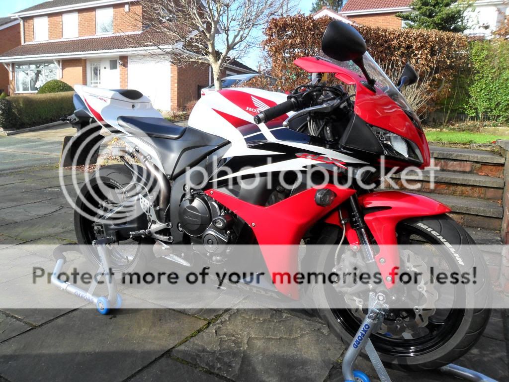

my 08 that was the one recently hit was very nice so spares/repair may be up for sale soon as honda reckon border line write off so far, they're pricing it in the morning, this pic was 2-3hrs before the crash:

Nice bike btw broo!!
