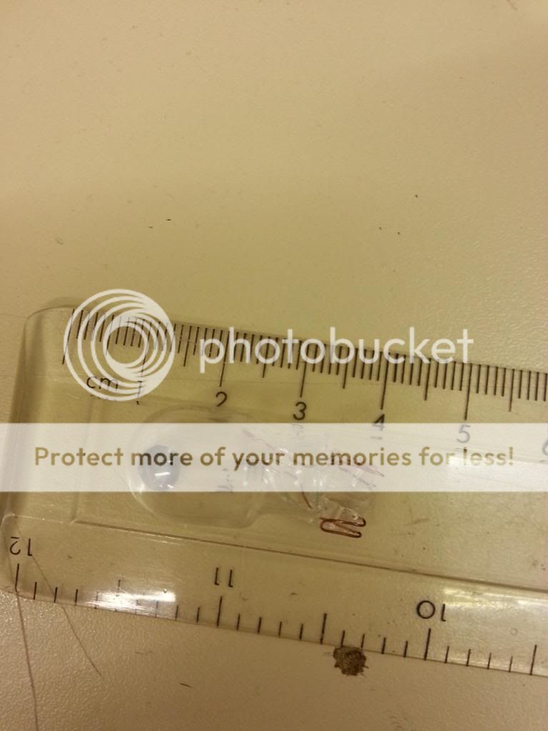

the bulb just snapped
heres a picture of it kinda rebuilt
https://i25.photobucket.com/albums/c81/mudcow007/20130308_155642_zpsbe8b4c19.jpg
these?

i suspect the offending bulb is really a 21w item
take your old bulb to halfords...
https://www.halfords.com/webapp/wcs/stores/servlet/product_storeId_10001_catalogId_10151_productId_212793_langId_-1_categoryId_165538
https://www.halfords.com/webapp/wcs/stores/servlet/product_storeId_10001_catalogId_10151_productId_187157_langId_-1_categoryId_165538
i think the 2nd is most likely culprit.. but take the old bulb with you.
