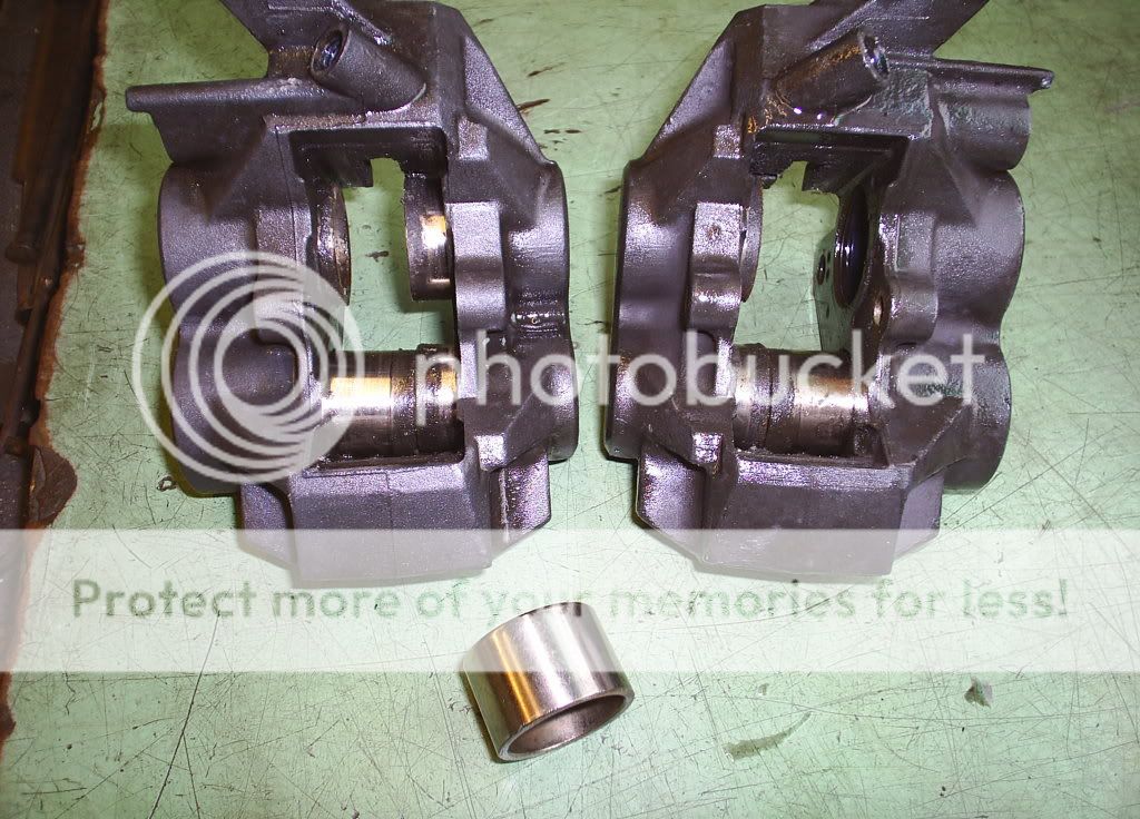

If the calipers started off looking like these R1 calipers,then give them a good clean externally first,removing the pins,pads and chrome plates
https://i666.photobucket.com/albums/vv23/WiNot_Rhencullen/Workshop/Picture383.jpg
Then pump out the pistons so that they are all about halfway out and almost touching
https://i666.photobucket.com/albums/vv23/WiNot_Rhencullen/Workshop/Picture382.jpg
Try not to let any of the pistons come all of the way out,but note which ones move the most freely and look to remove them last - for a good reason.Push the freely moving ones back into the caliper body and use an old file where the disc normally rotates to stop them moving too far out.Pump out the pistons that are not moving so freely and try and work them so that they both pop out at the same time.Clean the pistons,seals and seal grooves.Once done,reinstall the pistons using only the distortion seals and not the dust seals.Use either compressed air or hydraulic pressure to push out the other pistons,holding back the cleaned pistons.Remove the dirty pistons and seals and clean.Thoroughly clean the caliper body,paying particular attention to road and friction material stuck on the caliper.
