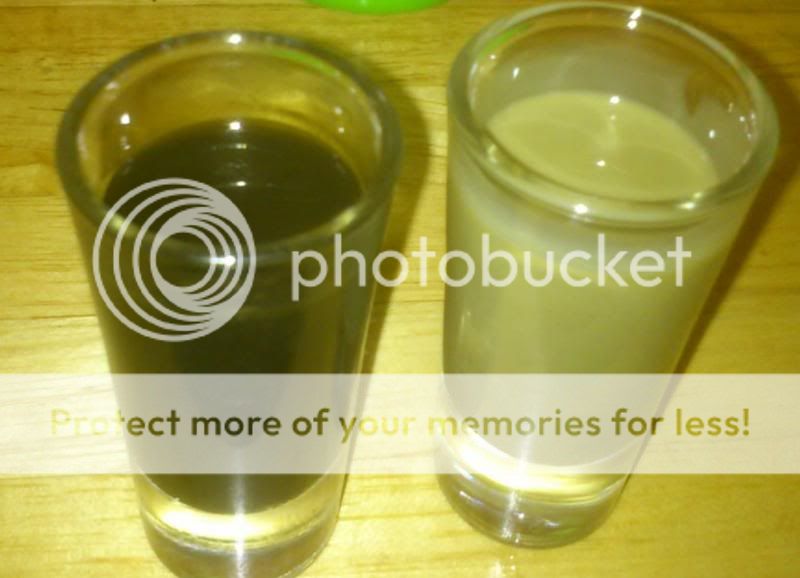

I pulled some oil out of the engine today.... and tried heating some of it for a few minutes:
No it isn't baileys and kahlua:
https://img.photobucket.com/albums/v320/andy36586/Oil_zps9cd80fc0.jpg
Now would I be right in thinking that the oil would be warmed up naturally by the engine to boil off the water (in a sense), and if so would I not be able to just do that on the cooker (since both engines need flushed out anyway and would mean only buying 10 litres of oil rather than 20 (well 16 really)

First of all, you need to establish the cause of the emulsified oil. Has it used any water from the radiator or expansion bottle? If not, Just change the oil and then take it for a long run to vaporise any water which may still be in the crankcase & sump. If it has used some water, fix that before changing the oil.

could even be the water pump seal letting water into the sump too, I would start by checking the coolant level first and go from there.
possibly a core plug as Pete says if it has been frozen up.

No, the oil/water is an emulsion now you need to replace it.
What jimspeed said is right about the waterpump seal except they normally have two seals and a telltale drain hole between them, that way if the waterpump seal goes the water leaks out instead of mixing with the oil.
Only other thing it might be is the oil cooler, if that bike has a water-cooled oil cooler fitted (like the fireblade).

Damn... thought I might have got away with the oil as a flush.... oh well. The thing I'm wondering about with the core plug is they are screwed in, so not sure they would go that easily.
Oil cooler is a seperate rad. I'll get the valve cover off tomorrow and see what it's like in there, then I'll start looking elsewhere for the problem.
