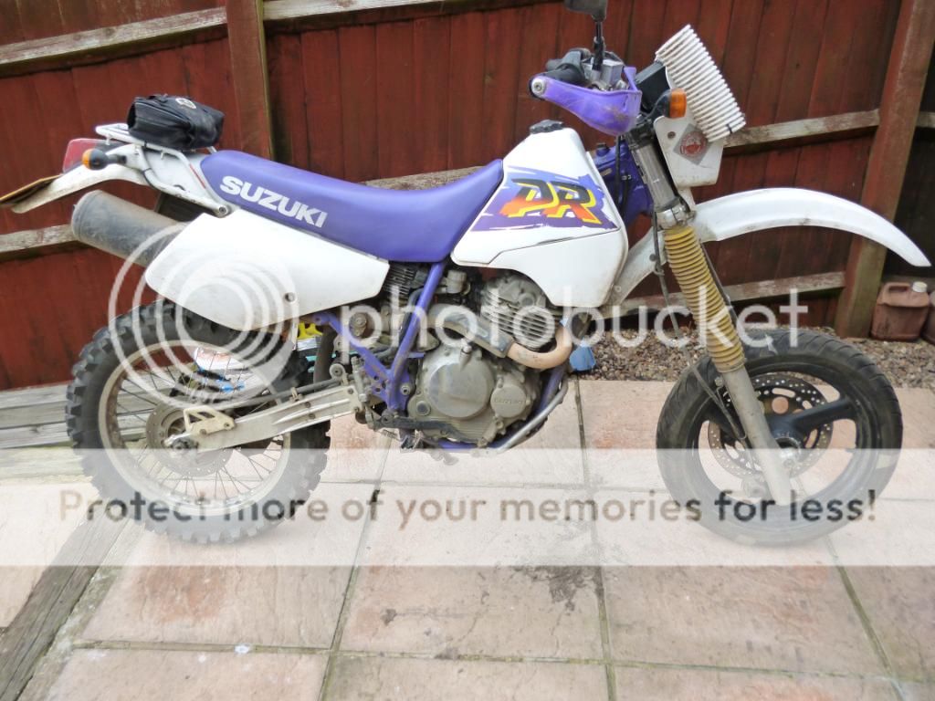

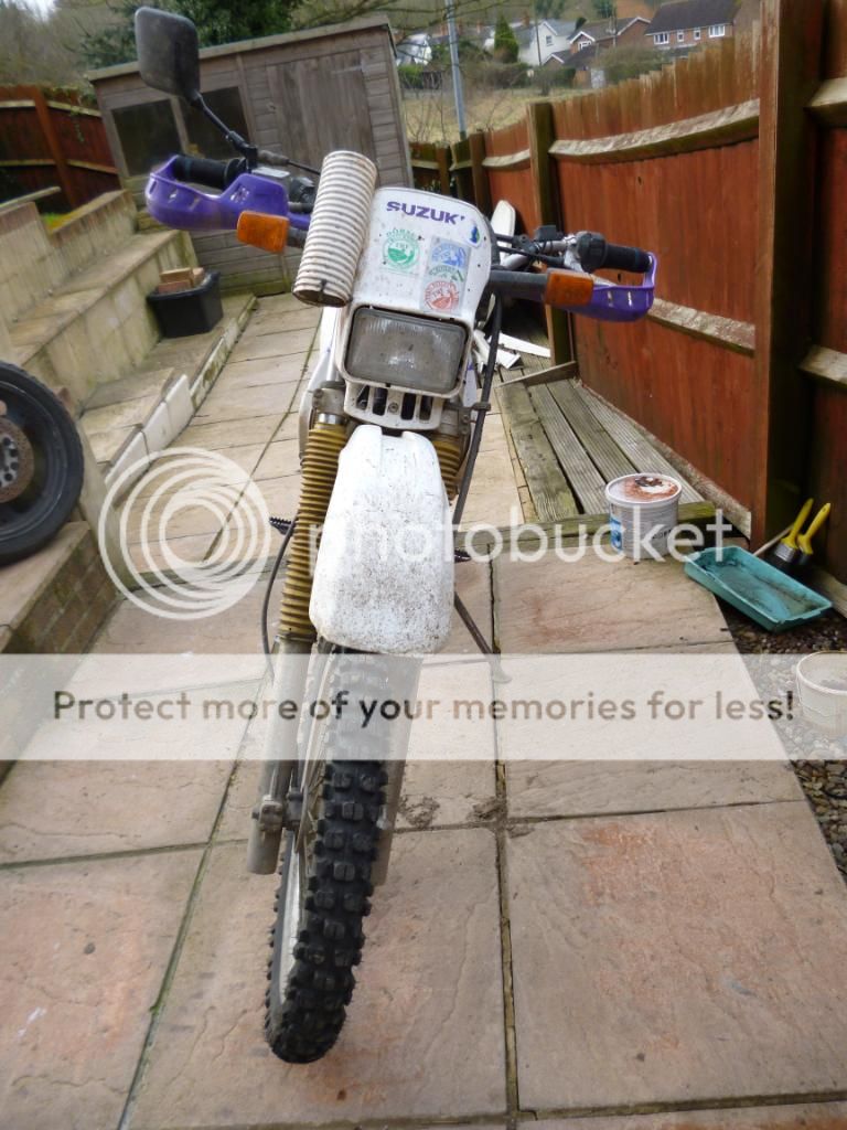

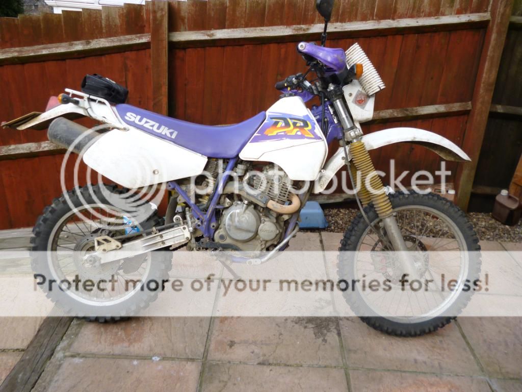

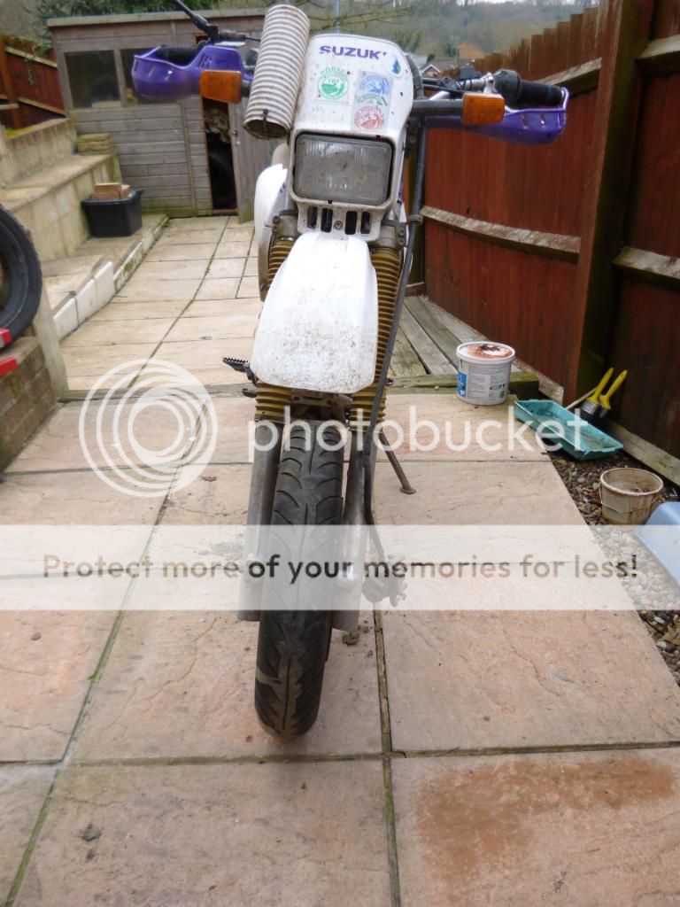

I bought a DR350 after getting my 33HP licence, as i wanted to do a bit of green laning. However i also need a road bike as knobbly tyres on the road aren't much fun.
The bike,

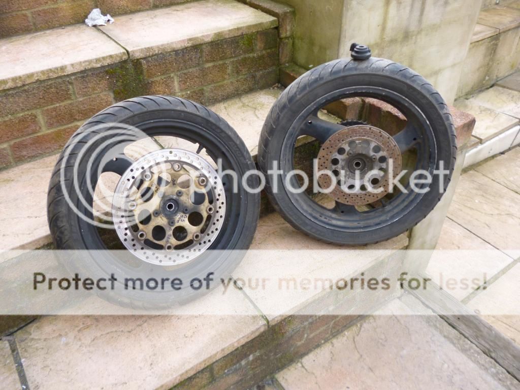

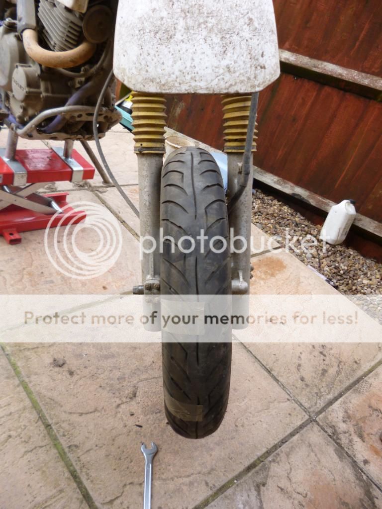

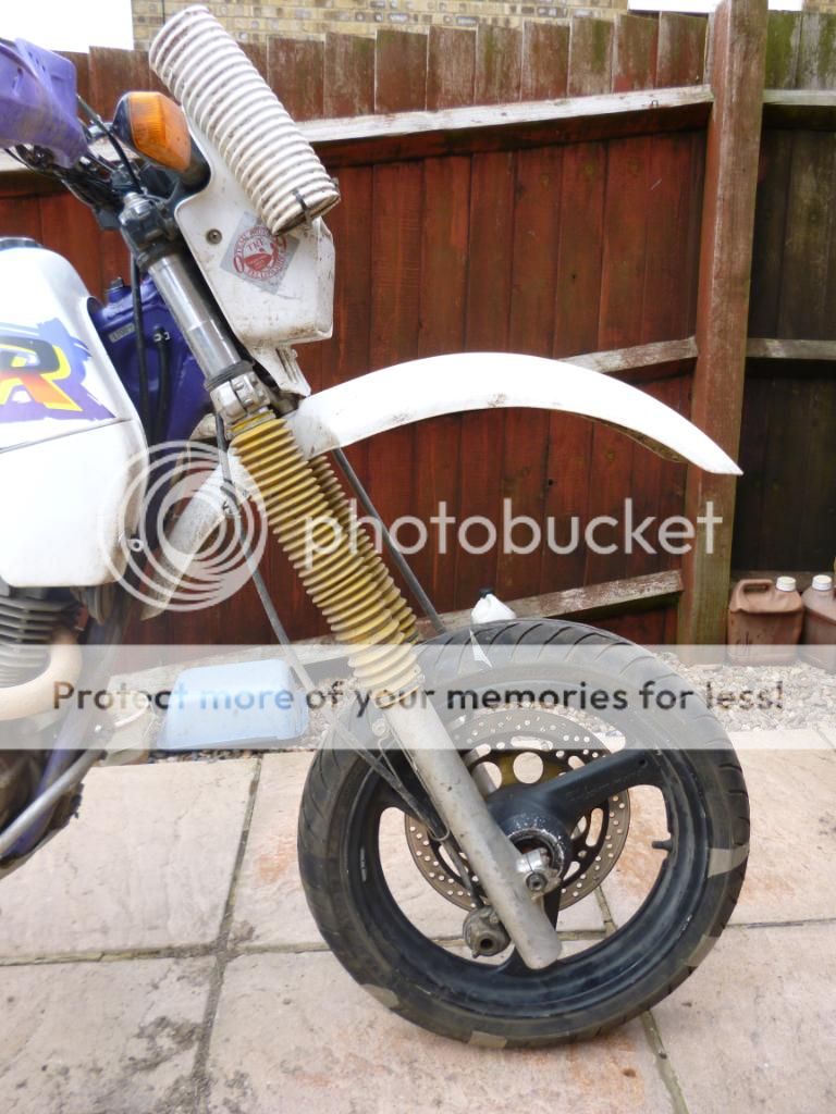

GS500 wheels, disks, sprocket and speedo drive,
https://i448.photobucket.com/albums/qq202/at106/Picture004_zpsbc308307.jpg

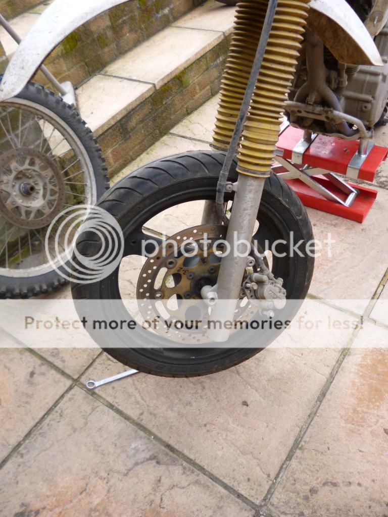

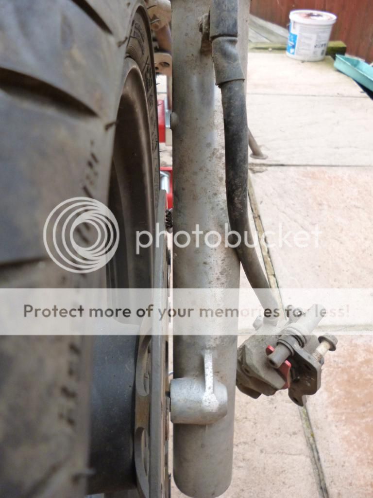

The front wheel fits perfectly, however the speedo drive doesn't as it is too wide so i'll just use a bicycle speedo.
https://i448.photobucket.com/albums/qq202/at106/Picture006_zps0f27ee8f.jpg
https://i448.photobucket.com/albums/qq202/at106/Picture008_zpsa4b11ff3.jpg
There's just enough clearance between the disk and forks,
https://i448.photobucket.com/albums/qq202/at106/Picture010_zpsc7a6fee6.jpg
I made up a couple of spacers out of copper pipe to see how it looked (i'll get proper spacers made next week),
https://i448.photobucket.com/albums/qq202/at106/Picture011_zps80304bb0.jpg
https://i448.photobucket.com/albums/qq202/at106/Picture012_zpsc93e5220.jpg
https://i448.photobucket.com/albums/qq202/at106/Picture013_zpsa1d8d5c4.jpg

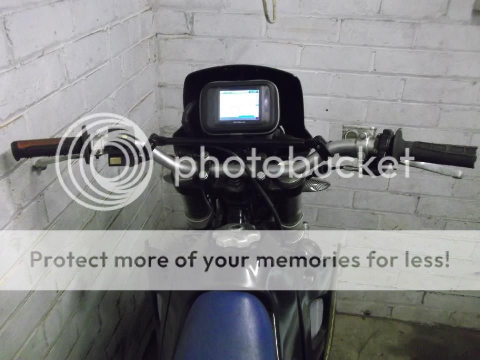

just purely limited space. i went with a sat nav to replace my speedo. looks cool and is useful and probs more accurate
husky sm610
TUG
Joined: 12 May 2007
PostPosted: 19:17 - 23 Feb 2013    Post subject: Reply with quote
Ahh right I see, yea your probably right there.
Haz ER-5, innit!
suzukirider19...
Joined: 30 Jan 2013
PostPosted: 19:26 - 23 Feb 2013    Post subject: Reply with quote
this is what mine looks like and only cost arouns £20 for the satnav and the waterproof case
https://i1341.photobucket.com/albums/o743/pitbiker1987/735015_10151349493568363_1737419430_n1_zps0a2231a6.jpg
husky sm610
mysterious_rider
Joined: 11 Sep 2010
illegal. highly suggest a koso speedo, i have one

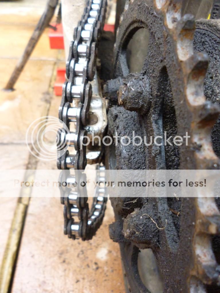

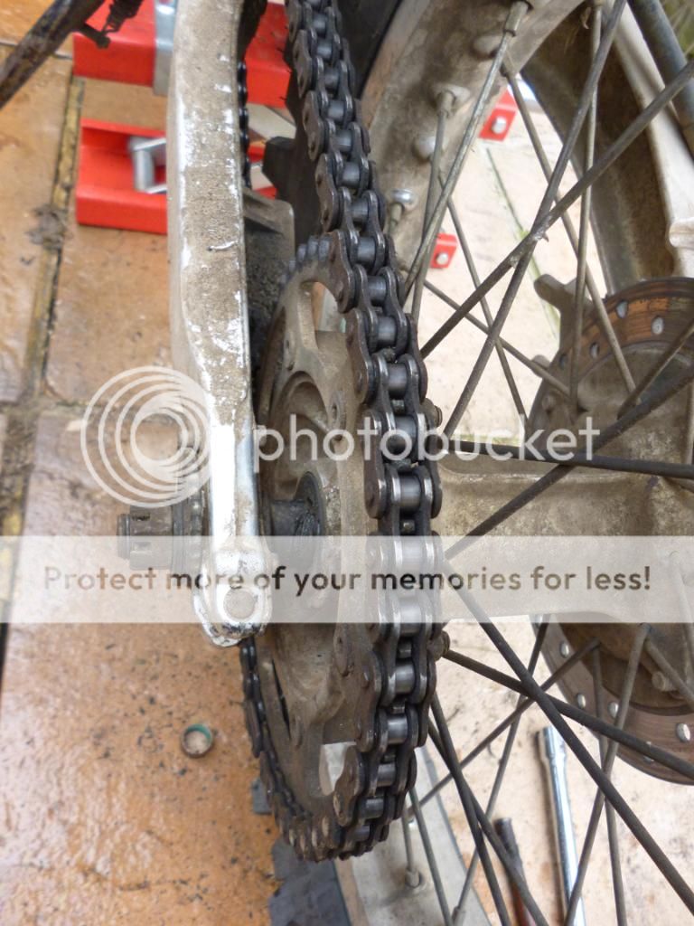

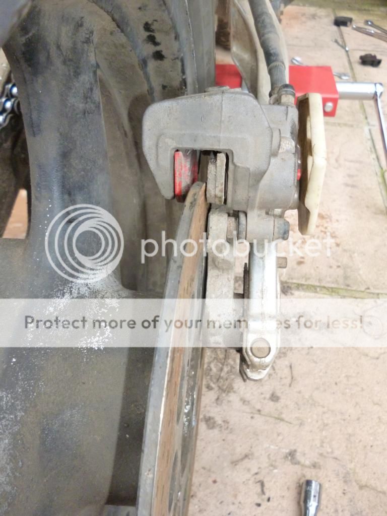

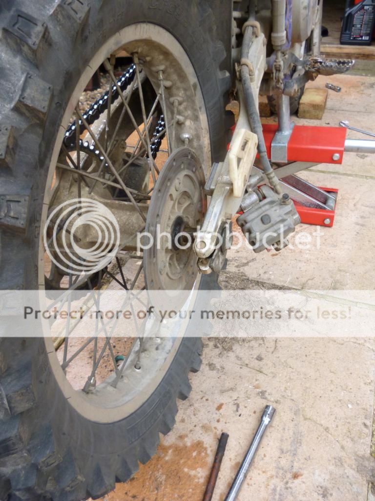

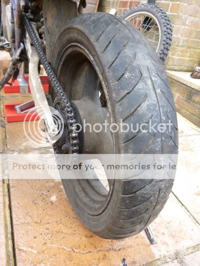

This afternoon (in the freezing weather) i attempted to fit the rear wheel. The rear wheel isn't as easy as the front because it needs bigger bearings and it is slightly too wide.
I started by removing the rear caliper and then measuring the distance between the sprocket and swingarm of the dr350 wheel so i could get an idea of the sprocket alignment.
https://i448.photobucket.com/albums/qq202/at106/Picture015_zps3502d25f.jpg
https://i448.photobucket.com/albums/qq202/at106/Picture014_zps4dec6a76.jpg

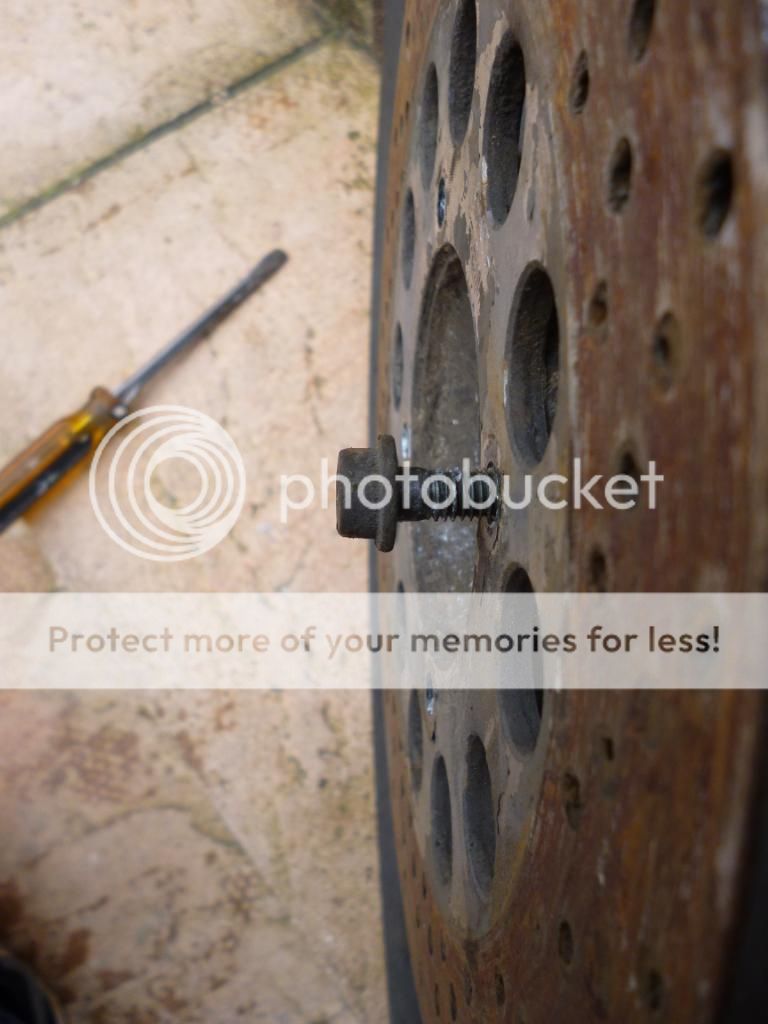

Next i removed the bolts which hold the brake disk on as they need replacing for countersunk ones due to clearance issues.
https://i448.photobucket.com/albums/qq202/at106/Picture017_zpsb8031aa8.jpg

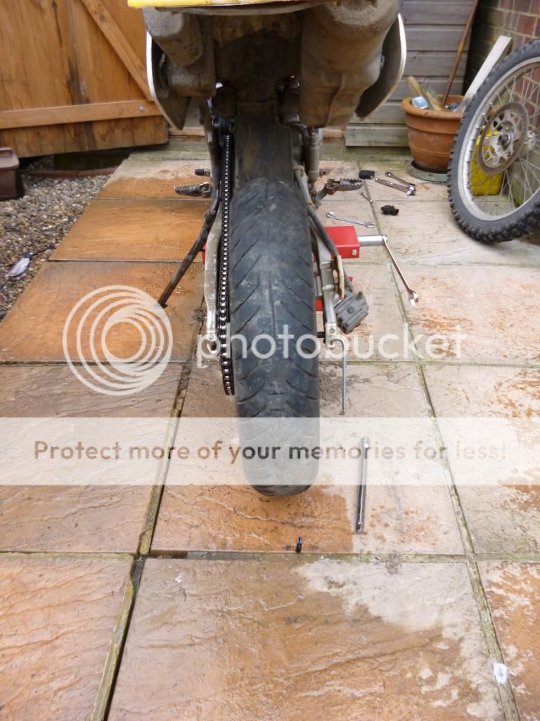

I got the wheel fitted, made up a 13mm spacer and the chain aligned perfectly Smile
https://i448.photobucket.com/albums/qq202/at106/Picture018_zps889f0c59.jpg
https://i448.photobucket.com/albums/qq202/at106/Picture019_zps8478eade.jpg

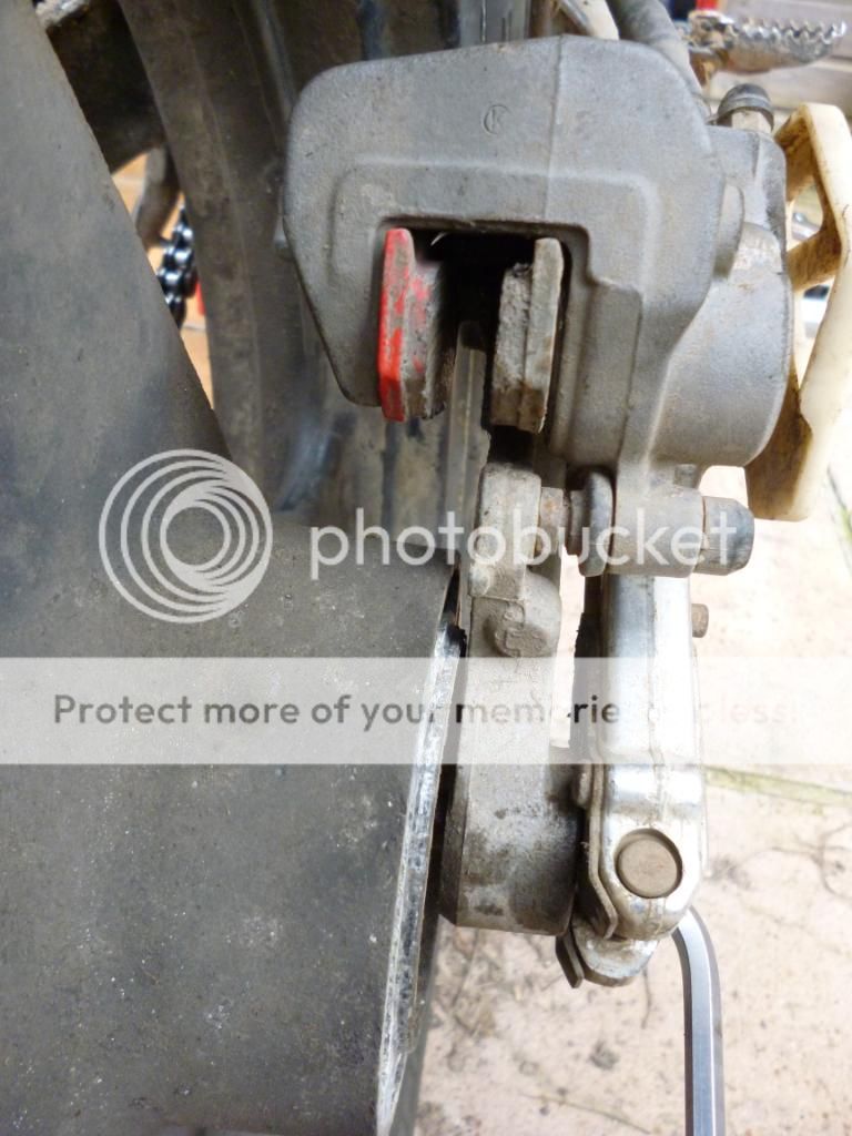

Now onto the brake side Sad With the caliper fitted the wheel wouldn't slide in because it's too wide. To overcome this i removed the disk so i could measure how much material needs to be removed.
https://i448.photobucket.com/albums/qq202/at106/Picture020_zps8c76d93d.jpg
https://i448.photobucket.com/albums/qq202/at106/Picture022_zpse506b950.jpg
https://i448.photobucket.com/albums/qq202/at106/Picture023_zpsd8157bbe.jpg
It needs about 5mm removing, i can either remove it from the brake side of the wheel, or the sprocket carrier but it depends on how the front and rear wheels align. So next week i'll get the correct bearings ordered and some proper spacers made up.
