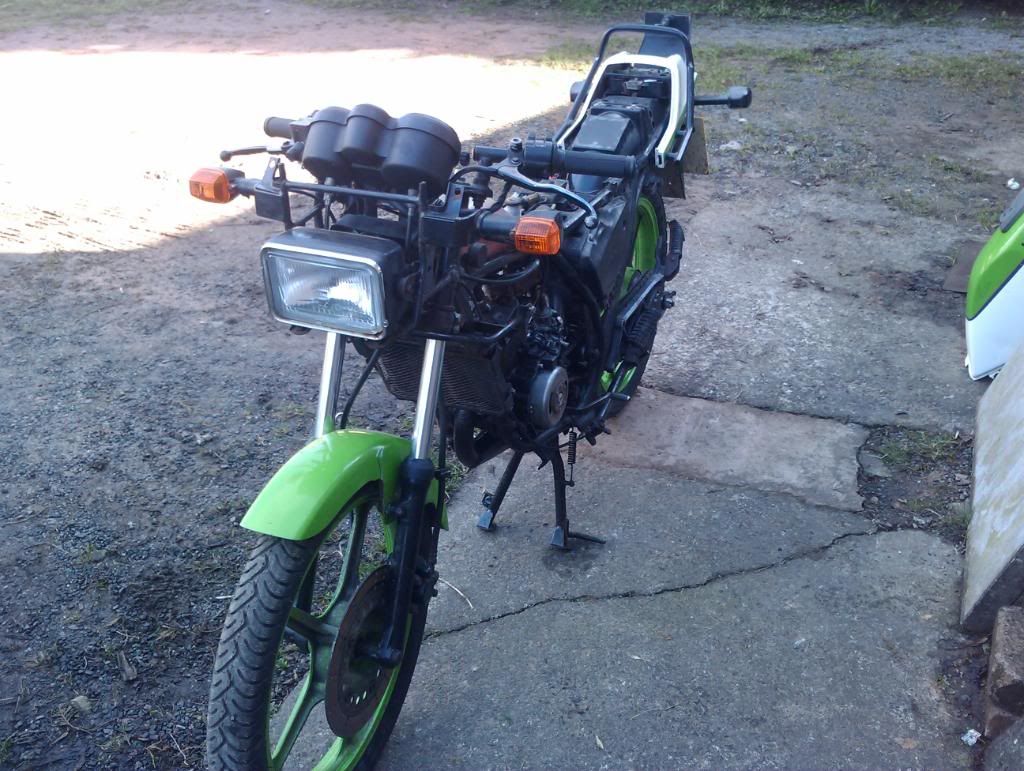

Here is my AR125 B8 1994...I'm very proud of it Cool
This is my first 125 (still not ridden it yet properly)
I bought it a couple years ago as a impulse buy to replace my scooter when I turned 17. When it arrived it looked like this:

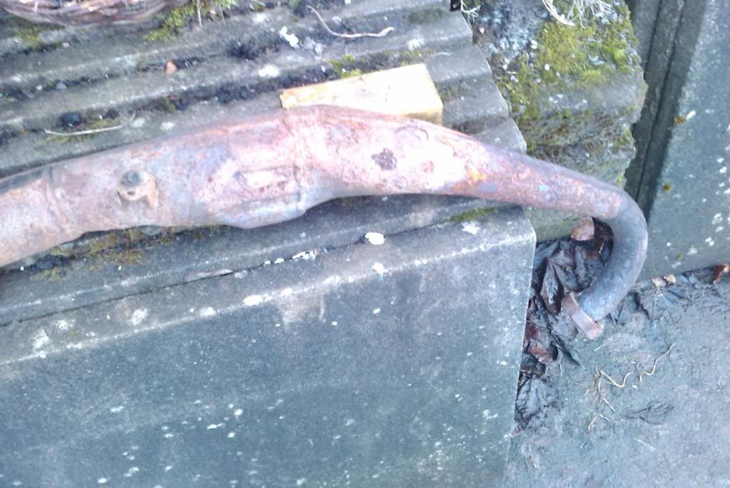

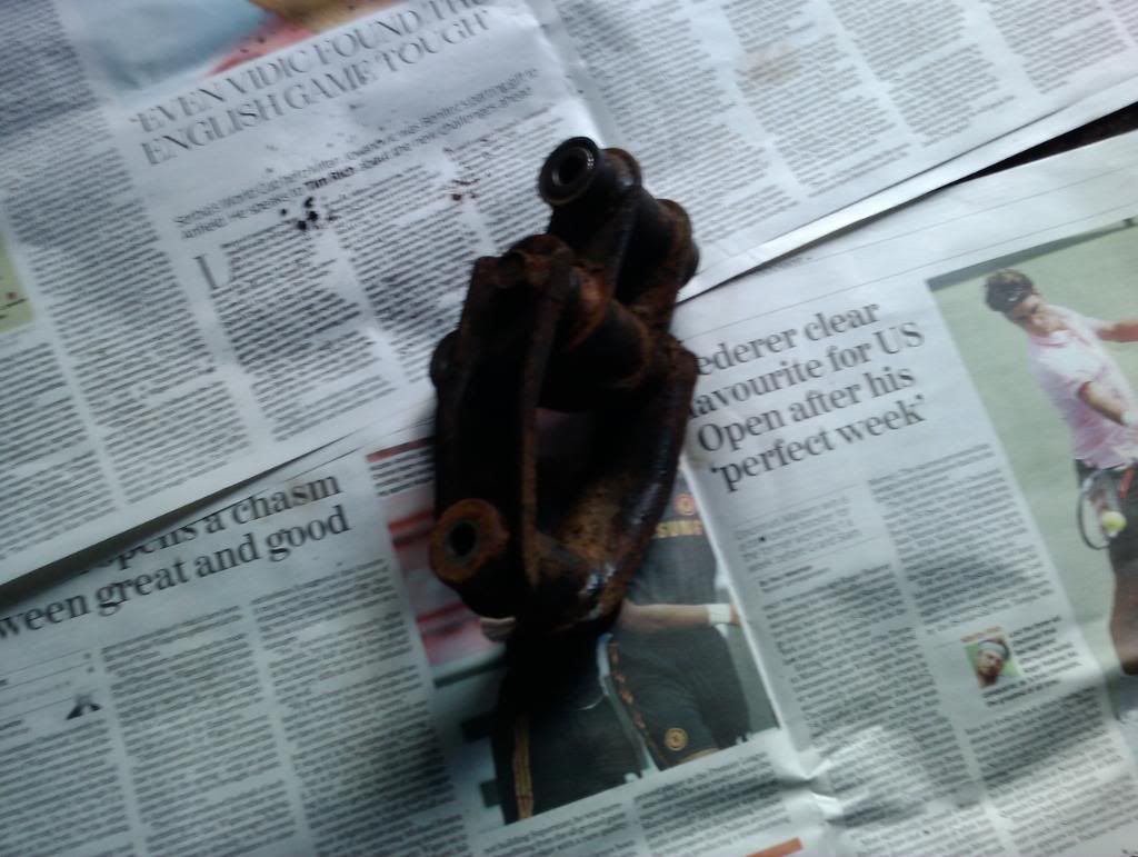

First thing was to hear it running...which due to this:
https://i1105.photobucket.com/albums/h346/Avora1/IMAG0034.jpg
made it very loud and silly. This was soon fixed by heating a metal plate which we moulded around the bottom of the exhaust and welded on. And painted up.

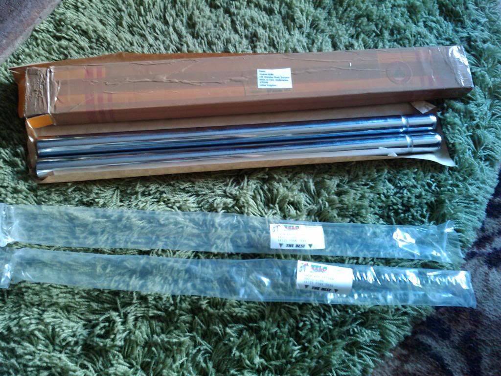

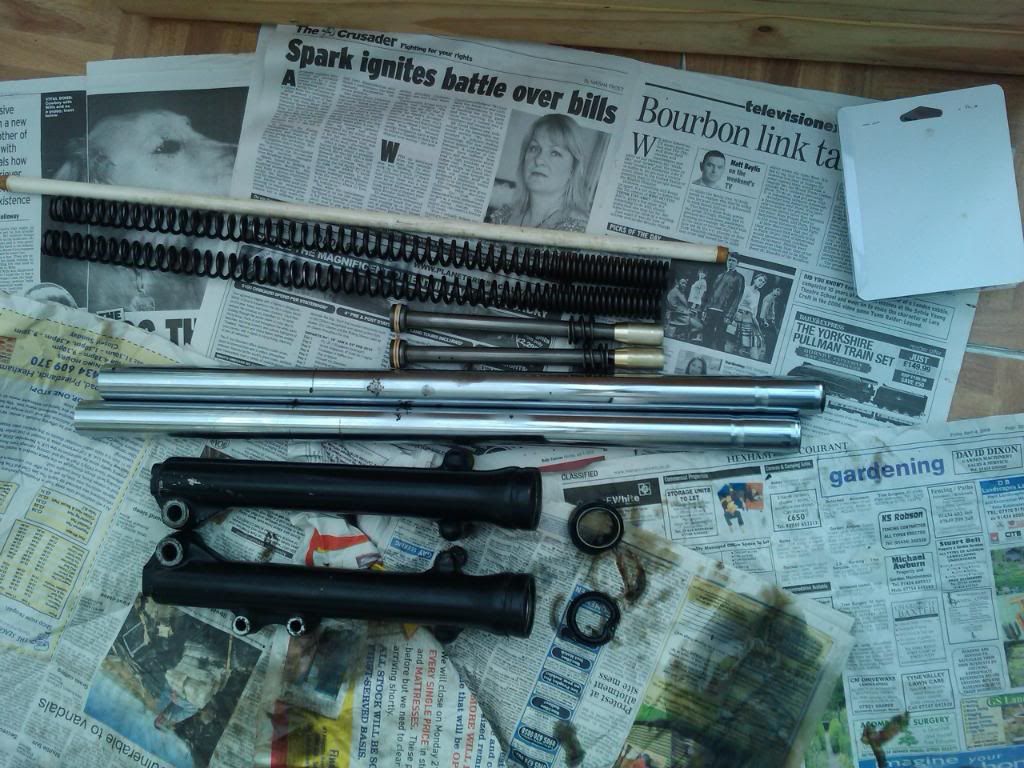

Next I noticed the forks were beyond repair, pitted and leaking. So I ordered these at first chance:
https://i1105.photobucket.com/albums/h346/Avora1/2010-07-03110103.jpg

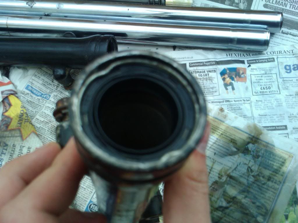

I knew at £30 for a NOS set of stanchions I was laughing. Bought new fork oil and seals. Then I promptly stripped for overhaul.
https://i1105.photobucket.com/albums/h346/Avora1/2010-07-06192543.jpg
I found this to be somewhat difficult on one fork as one of the bolts had been "secured" with some household sealant before I got it. Fixed this and fitted them.
https://i1105.photobucket.com/albums/h346/Avora1/2010-07-08145458.jpg
Mmmmmm shiny and new. Smile

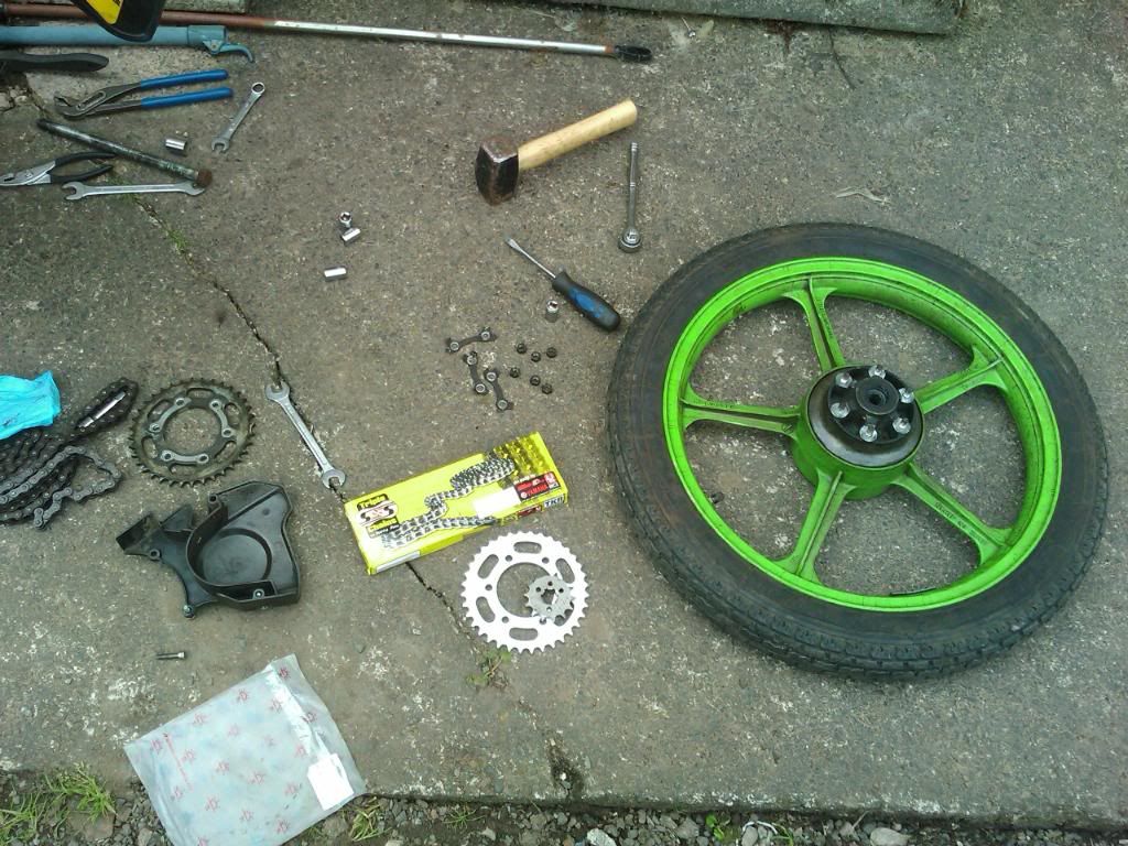

Figured I might as well change these
https://i1105.photobucket.com/albums/h346/Avora1/2010-06-17110621.jpg
https://i1105.photobucket.com/albums/h346/Avora1/2010-07-24122212.jpg

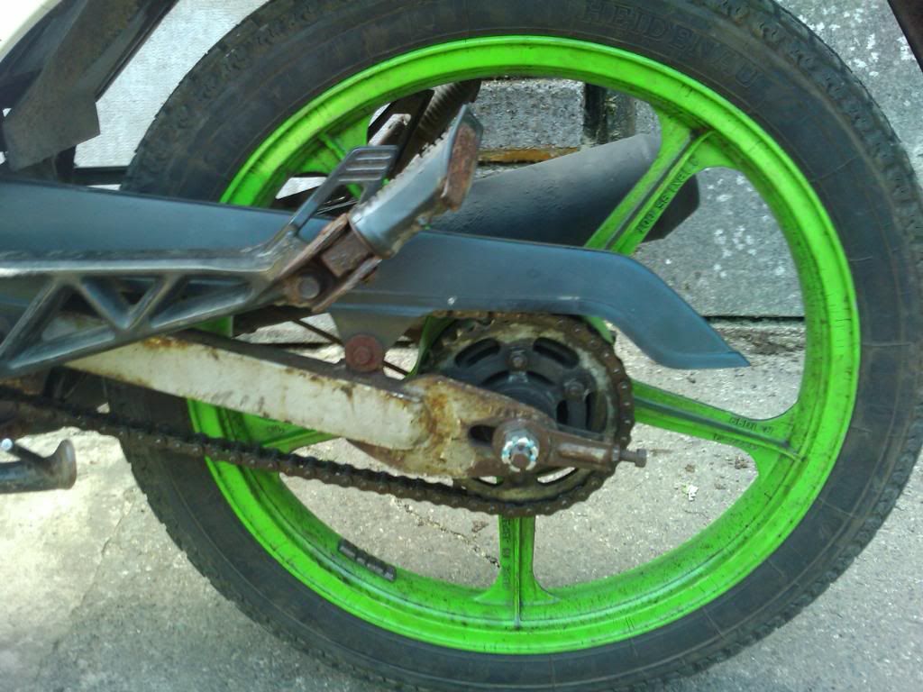

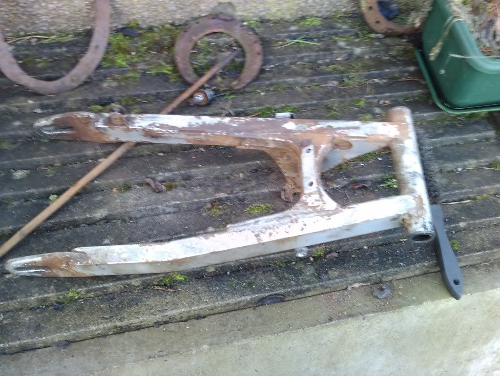

Will also give you an after shot of this once I had tackled the rust when I find it Rolling Eyes
https://i1105.photobucket.com/albums/h346/Avora1/IMG_20110212_115646.jpg

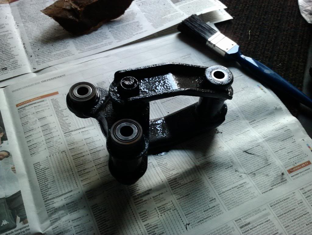

Hammerite is a glorious thing even if all it does is stop the corrosion and decay until one day I strip and powdercoat everything.
https://i1105.photobucket.com/albums/h346/Avora1/IMG_20110130_153925.jpg

Hammerite is alright for short periods, but you need to wire brush the hell out of things before you put it on. With bits that rusted you might want to check the electrics are okay. A roll of wire and a bored afternoon can have most as new.

Haha, yes, with the swingarm I started to rub the whole thing back (by hand) to bare metal to check the welds and for any cracks. Turned out fine. And had several coats. With the linkage I had a wire brush attachment with my cordless drill for a good while. The mirrors, well, it only came with one...which was buggered up. And my garage is full of crap, so it was easier whilst I knew it wasn't on the road to take it off. Will buy new ones before the MOT Very Happy
Also all the electrics function fine, and have checked all the earths too.

That swingarm is shocking! Bet it looks much better after a lick of paint though. Good project, post more pictures Thumbs Up

Thats what happens when 17 year olds that don't care get these and leave them outside!!! Will pursue these damn'd photos, I know they are on one of my hard drives.

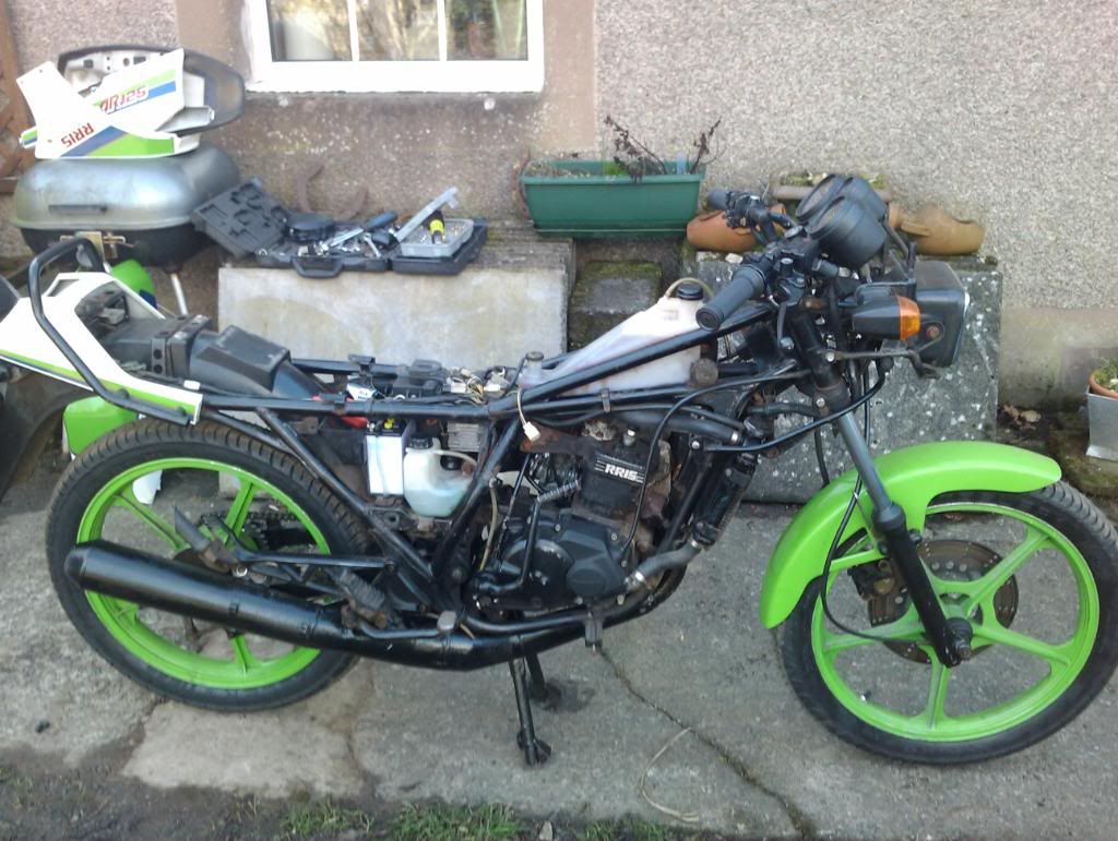

Aha more photies!
https://i1105.photobucket.com/albums/h346/Avora1/IMG_20110221_114343.jpg
Looks much better I thought Cool (for a hammerite jobby)

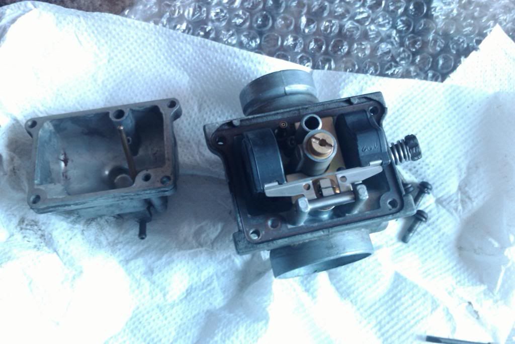

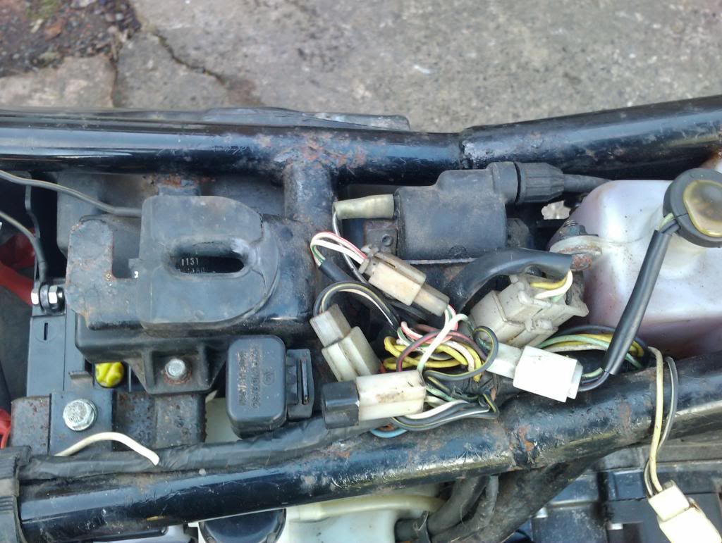

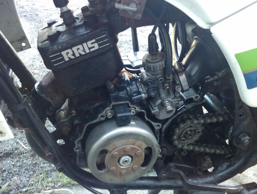

I stripped this carburettor more times than any other part of this bike, thinking the idling issues I was having was its fault. Turned out to be an O ring on a piece I will picture up today.
https://i1105.photobucket.com/albums/h346/Avora1/IMAG0038.jpg
https://i1105.photobucket.com/albums/h346/Avora1/IMG_20110319_094030.jpg

Apologies! I have been busy elsewhere. But good knews! It runs and idles perfectly now. And has the back wheel back on it. I think I could take it for an MOT as it stands and only need some split pins...anyone know if they are needed?
Either way, I have a short video and some more piccies which I will upload later on. I am desperate to get it on the road...but I know that theres little point as I should hopefully be going to uni at the start of september.

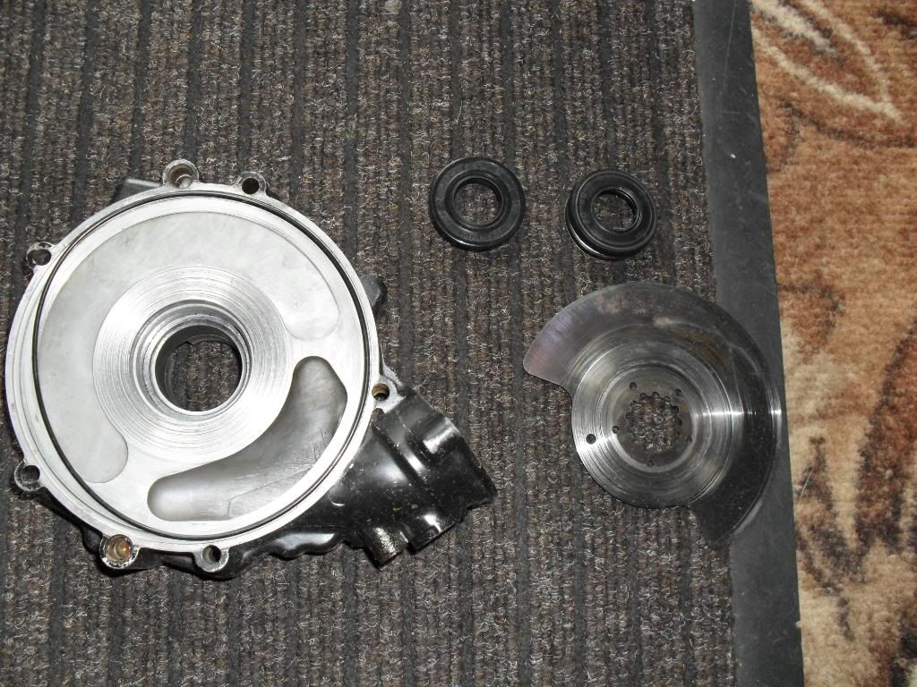

Today I have had the side of the engine off and sorted out the Oring causing my poor running, and taken a chance for now with the warped Disc Valve. Shouldn't be a problem, but I will order one soon, and seen as its not going to be going anywhere shouldnt matter.

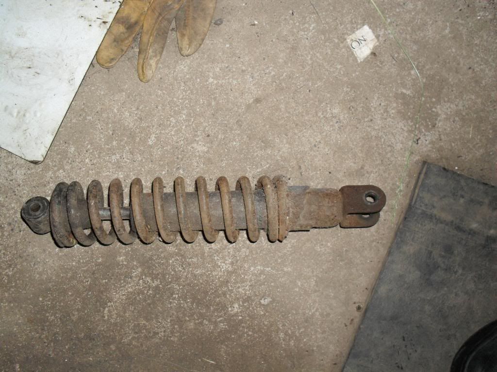

See how warped this is? Maybe can't tell from the picture.
https://i1105.photobucket.com/albums/h346/Avora1/SAM_0003.jpg
Old shock...mmm rusty

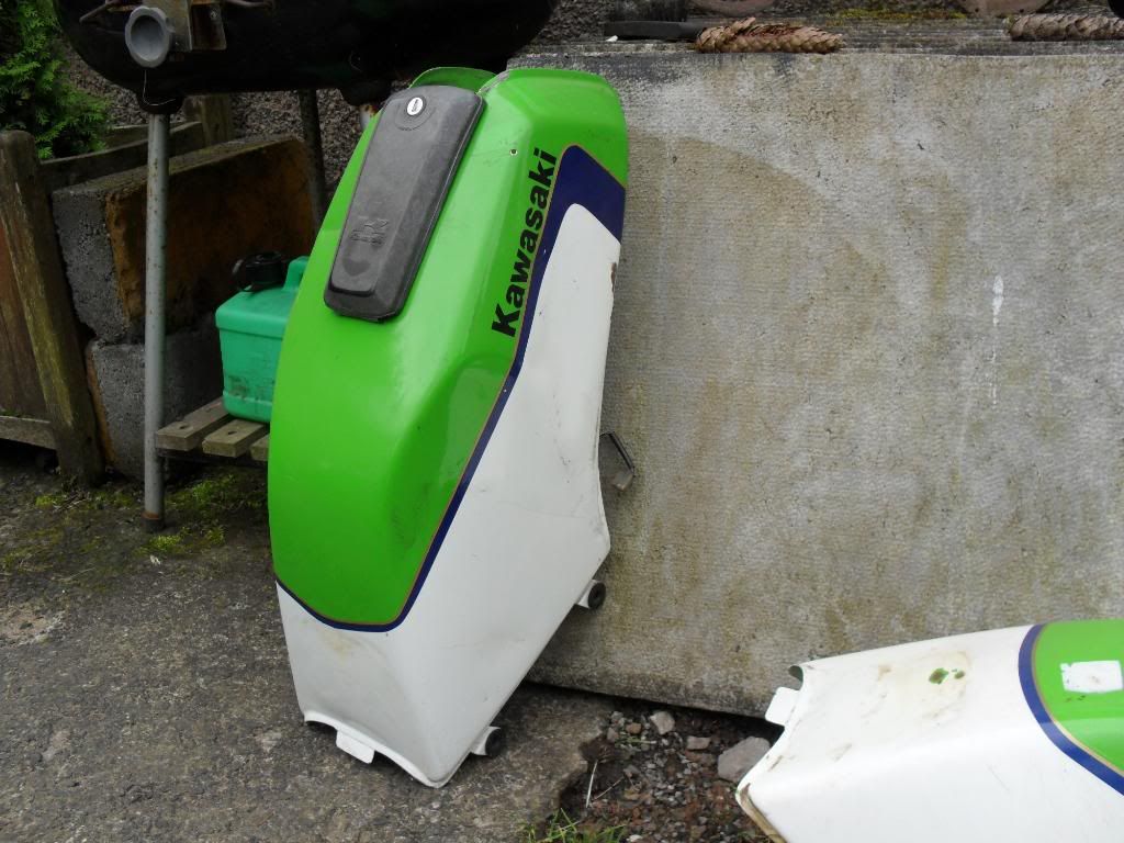

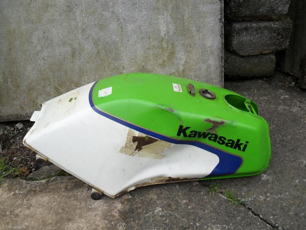

Old tank
https://i1105.photobucket.com/albums/h346/Avora1/SAM_0069.jpg
New..er tank

I think that shock might be beyond saving, try looking on German ebay, they have plenty of parts "stossdaempfer" is what you need.

Thanks, I bought an OXON shock which is on it now. But when you push the bike down, it returns fairly slowly. Like its leaked. The rusty one had a leak, would hiss when pushed. I thought the current one was the linkage, so it has been apart and regreased. Still does it...hmmm. Might need to replace the shock again. Damn!

Likely the old one has leaked and had no oil in it therefore just making it a spring. It would have returned very rapidly when pushed down. A shock needs to have what's known as rebound damping where the shock is slowed in the speed at which it returns. I suspect that either you're just not used to a shock with damping, or that the damping is set too high on that shock. Another possibility is incorrect fitting, stiffness in the linkages or not enough preload. Stick both preload and rebound damping on the middle settings and work from there.

The shock only has preload settings, which I had set to the middle set before installation. But it is unusally slow. Thats what I thought, hence I took the thing apart again. Oh well, I will have to have another look at it Rolling Eyes . Thanks Karma
