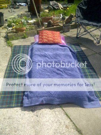

Our patio is higher than the garden on one side too, we used paving slabs on their side. I'll see if I can find a picture.
Edit: here you go. Not a brilliant pic but you get the idea. The sideways slabs form a retaining wall which has a sloping rockery down to the grass level alongside it. There are 2 steps down just behind the black chair, and a step in the concrete on the other side.
https://i12.photobucket.com/albums/a229/Yambabe/Facebook/Mobile%20Uploads/485538_10151363649155940_1039755270_n.jpg

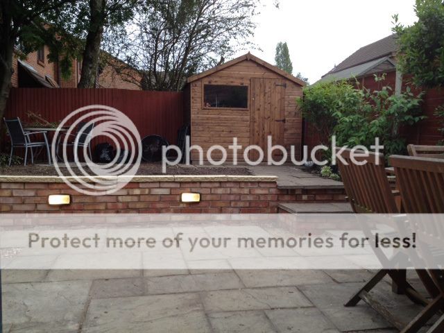

Mine's the other way round (patio at the bottom) but I just built a regular wall. The missus wanted some lights in it too. It's brick where visible and breezeblock where hidden, with 2 runs about half-way up to add strength to hold the ground back and then just single brick higher up where it emerges above the lawn (the soil is now lawn).
https://img.photobucket.com/albums/v404/angryjonny/wall1_zps7b7d7825.jpg
Looks sweet dude. Thumbs Up
Would want a ramp not steps though cos that shed looks just right for a couple more bikes. Laughing
