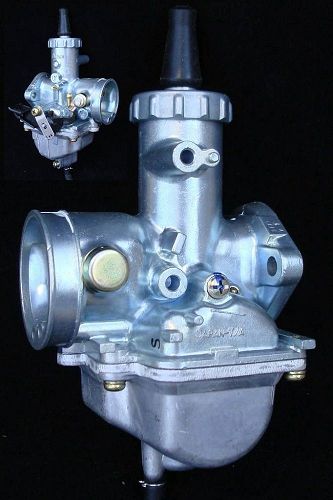

Yup. Carb looks like this?
https://tboltusa.com/store/images/MIKUNI26mmCARBURETOR_1.jpg
The cap screws off (the bumpy bit just under the black sleeve), and the throttle cable goes in there.

Rogerborg...he thought that it went in there as well, but when he took the cap off, there was already a cable in there!
The cable that is hanging is definitely attached to the throttle somehow, as when you turn the throttle itself, the cable moves Confused
Oh well, we've phoned a bike mechanic to come round in the morning to have a look at it, because not only have we got this conundrum, the damn thing seems to have seized up and wont even kick start to tick over now!

Ye that second cable is connected to a black wheel shaped thing that turns and has a spring on it, I cant remember the terminology, but its so the throttle cable snaps back when you let go.
https://faq.f650.com/GSFAQs/Photos/FuelInjectorPhotos/ThrottleCableGSConnection.jpg
It's not crucial, but it reduces the chances of your carb sticking open at speed.
Good luck with it.

Cheers, Linux. He's had a look at the picture, but says there's nothing like that part on the side of the carb, so maybe it's dropped off! When the bike mechanic came round, he couldn't find anywhere to put it either.
