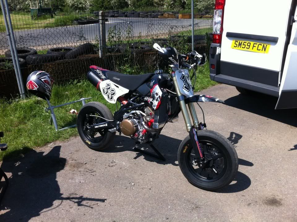

I've not ridden my Mini-pit since the Pit bike club weekender at the start of the year, when this happened. :icon_lol:
(Hard to see in the picture, but it's bellowing smoke out)
https://sphotos-e.ak.fbcdn.net/hphotos-ak-ash3/577302_10150865983695606_303904741_n.jpg
It would literally run for 3/4 of a session, before nipping up tight. Then when I pushed it off the pit lane back to my car, it would take 600ml of oil (Literally a full engines worth).
The cause was a scored barrel and some damn sh*gged piston rings.

PostPosted: 01:43 - 05 Jan 2013    Post subject: Reply with quote
Mine is based around a MonsterMoto Mk1, but with shortened forks, and a custom made shorter Shock. So it's about the same sort of size as an early Thumpstar 110, or an original Mk1 FYM Xsport. Very small. Razz
With the 140 hybrid in, mine was pretty fooking fast. With the 155z in, it should be a bit of a weapon. I've not ridden for a good 8 months though so It'll take some getting used to.
