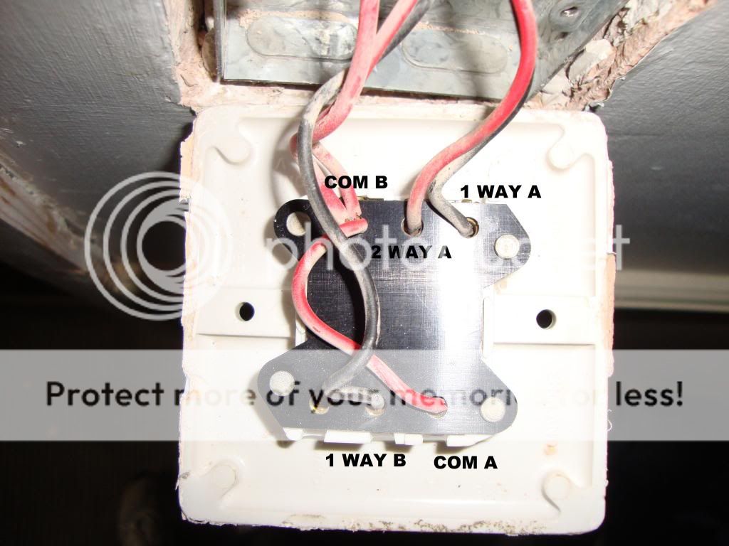

Firstly I'm trying to replace this old double switch:

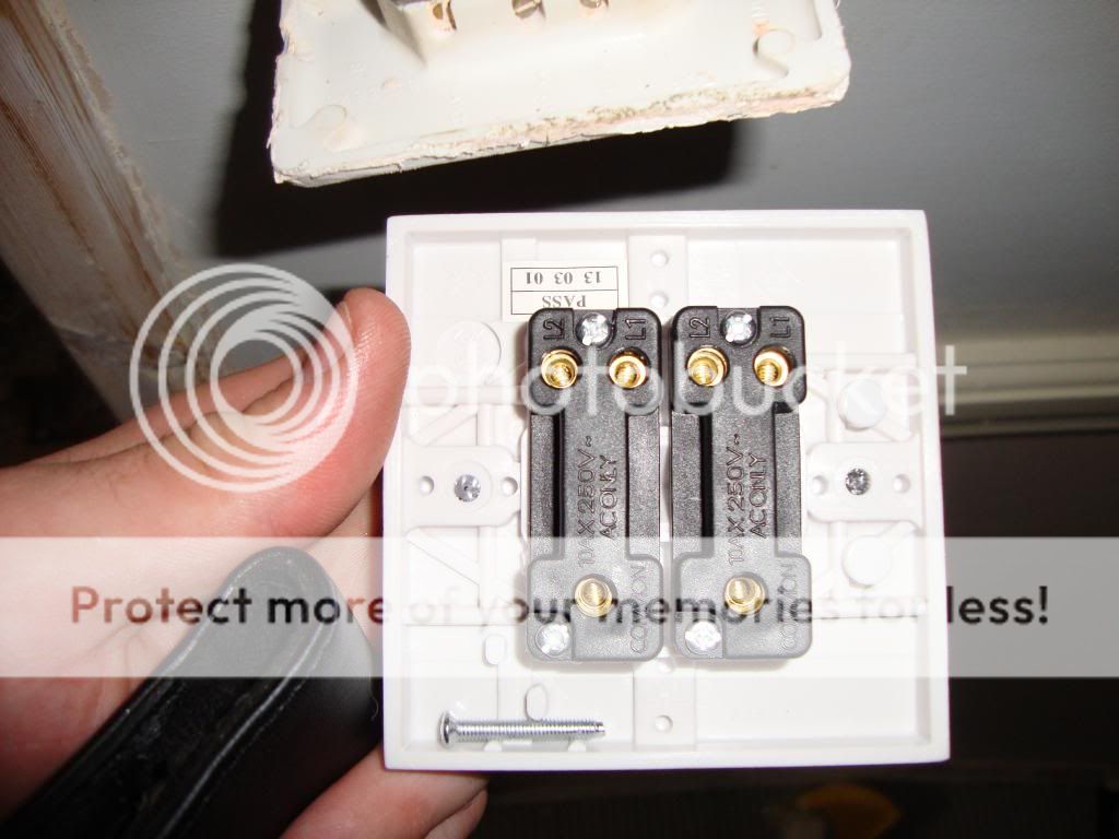

With this new double switch:
https://i1292.photobucket.com/albums/b577/Shaun_N_Roberts/DSC03217_zps939745d6.jpg
Which wires need to go where?

Just imagine the left half of the switch was round the other way and it will exactly match the switch you have, if that makes sense?

Hey,
I came to that conclusion too Smile
So all COM A into COMMON AND COM B into separate COMMON and 1 way B into L1?

Hey,
Done and it works.
