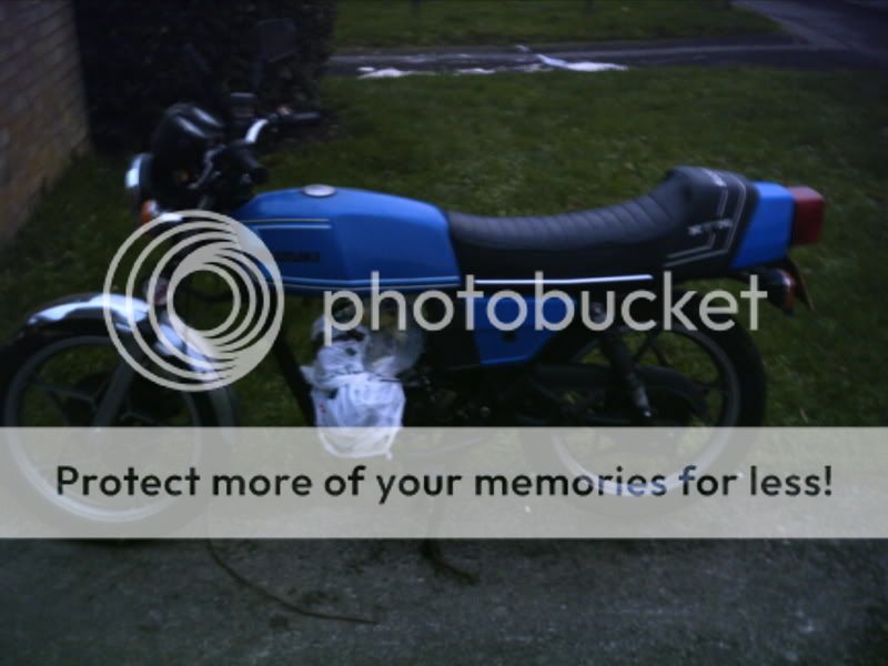

I just got this one, gonna strip it and use it for sprints:
https://i46.photobucket.com/albums/f107/motostunter/PICT0325.jpg
See you on the road, scag!!!
