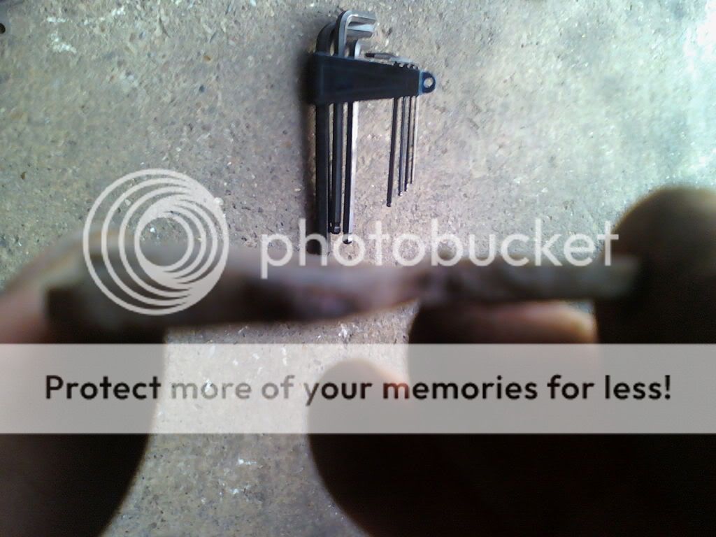

So I pulled out the pads on my project gixxer, they are totally ruined with the friction material contaminated. God knows when they were actually last used.
I was just wondering what the deep scoring marks in the pic might be? Have seen something similar before, but nothing that deep or symmetrical, so if anyone could offer an explanation that would be awesome.
ta Thumbs Up
https://www.bikechatforums.com/download.php?id=90205
PostPosted: 17:37 - 21 Aug 2013    Post subject: Reply with quote
Almost looks like screwdriver/lever marks, trying to get the pistons pushed back in when the caliper is off.
Yep thats it. No other rational explanation for it.
Jeez, so I guess sliding the pads out and using a nice soft bit of wood was too much hard work eh?
Wouldn't surprise me, this poor thing has suffered quite a lot of bodgery. Both r-clips were missing from the pad pins on the front, and on the rear there is supposed to be two metal plates that go between pistons and pads to stop them twisting, they were missing too. Guess safety wasn't an issue for this dude.

PostPosted: 18:20 - 21 Aug 2013    Post subject: Reply with quote
Ditto for the screwdriver causing the marks.
Have a good look at the state of the pistons as well!
If the pads have been bodged that much to push the pistons
back..................and bits missing Rolling Eyes Rolling Eyes Rolling Eyes
