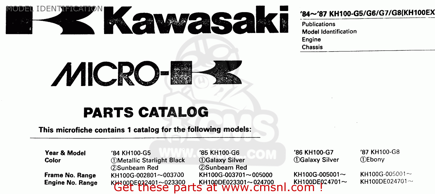

Rtwo
Joined: 17 Aug 2013
PostPosted: 20:55 - 19 Aug 2013    Post subject: Reply with quote
Looking at this, I think you can at least say its pre 84
https://images.cmsnl.com/img/partslists/kawasaki-1984-g5-kh100-model-identification_bigkae0549title_3616.gif
Shippyman52
Joined: 17 Aug 2013
PostPosted: 21:35 - 19 Aug 2013    Post subject: Reply with quote
Thanks - yep, it does. That would seem to narrow it down.
Just an idea, but I'm wondering if the KE could possibly have been fitted with this KH engine from the off? I think it may have been originally sold as an off road bike, without lights/ indicators etc, so I'm wondering if the KH engine might have been more suitable for that??? (purely guessing here). The paint - including engine casing - looks like factory quality paintwork, not a respray, and I've come across a 1981 KE125 with a very similar - (mostly green) frame/ body paint scheme.
jcewright
Joined: 13 Dec 2012
PostPosted: 11:24 - 20 Aug 2013    Post subject: Reply with quote
According to my Haynes manual, it is a 1983 KH100 G3 engine.
If you have the frame number i could tell you the year of that too.
For the frame to be 1983 aswell, the numbers need to be between KE100B-004001 and KE100B-07100.
hope this helps
josh
