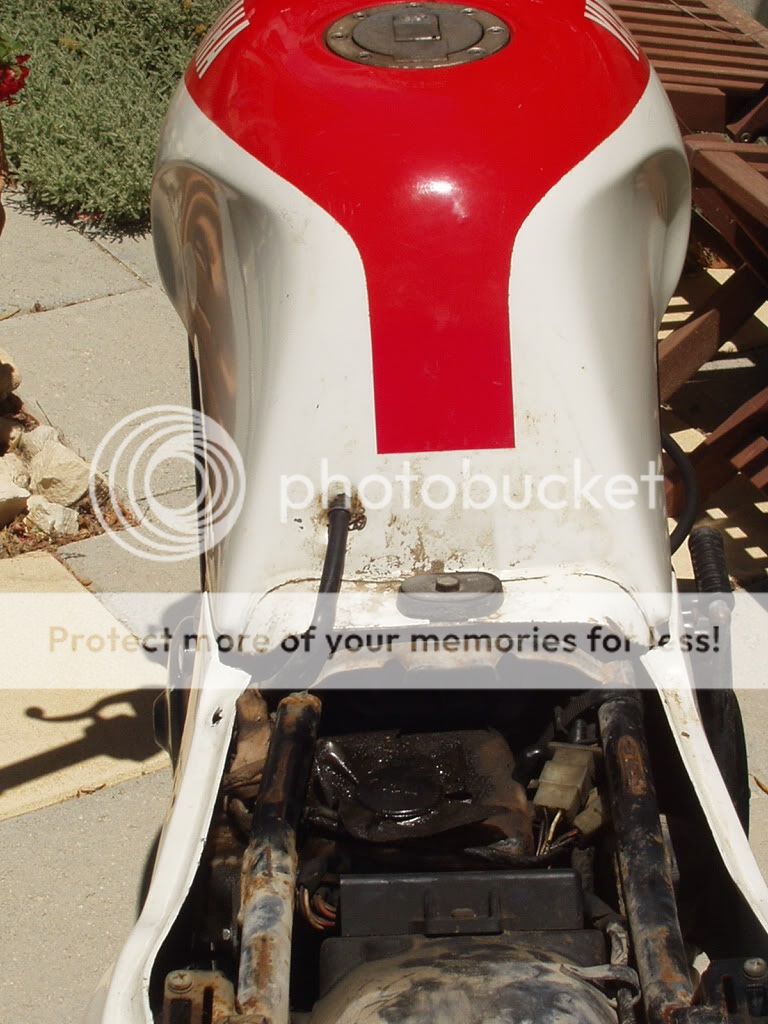

Is this pipe from the fuel tank really supposed to be there?

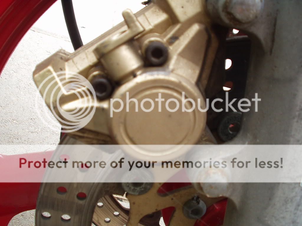

First job was unseizing the front brake callipers, which I achieved, however not having a manual, and after extensive “Googling” I can’t identify these callipers.
https://i645.photobucket.com/albums/uu172/Troodos-Pool-Guy/RZR%20250/P1010196.jpg
https://i645.photobucket.com/albums/uu172/Troodos-Pool-Guy/RZR%20250/P1010195.jpg
I would like to overhaul them but what part numbers do I need for new seals etc.?
Secondly do I need to split these callipers to get the pistons out?

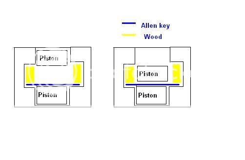

The pipe on the tank is supposed to be there.
If the seals in the calipers aren't leaking, I wouldn't replace them, just give the grooves in the caliper a good clean like I did on mine.
I've done 2,400 miles on my rebuilt calipers without any issues.
You don't need to split the caliper to get the pistons out, what you need is a couple of pieces of wood and an allen key.
https://i15.photobucket.com/albums/a376/ms51ves3/Pistonremoval.jpg
So push the pistons back into the caliper then pump one out like demonstrated above. This is how I did my rear caliper which looks the same or very similar to yours.
As you have disconnected the caliper, you will need a compressor to get the pistons out. Depending on how seized they are, you may get away with using a 12v compressor like I did.

That's roughly how I got the pistons moving, I was wondering will one piston have enough room to be removed without splitting the calliper?
Do you know what these callipers are, I've looked at loads of parts fiches over the weekend but couldn't find them?
If you push a piston all the way into the caliper body you should be able to get the opposing piston out.
Not sure what calipers they are. Could you not measure the piston and find out from that?

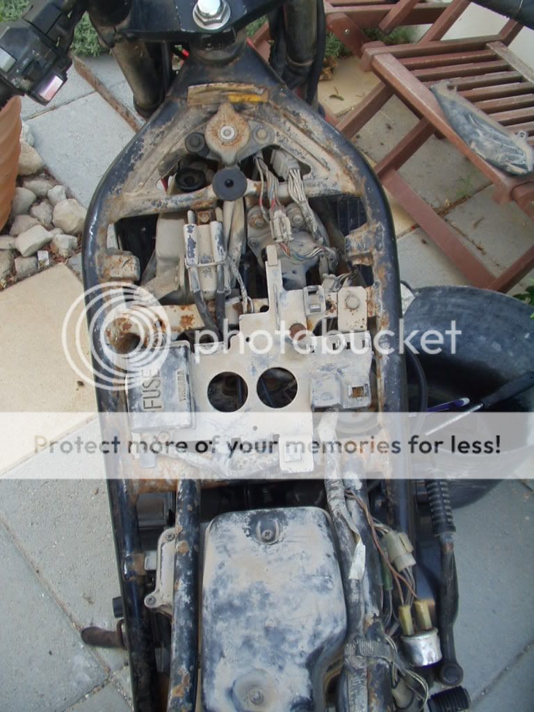

There is a thick layer of Two stroke and dust covering virtually everything:-
https://i645.photobucket.com/albums/uu172/Troodos-Pool-Guy/RZR%20250/DUST2.jpg
Unfortunately no air filter present:-
https://i645.photobucket.com/albums/uu172/Troodos-Pool-Guy/RZR%20250/DUST3.jpg

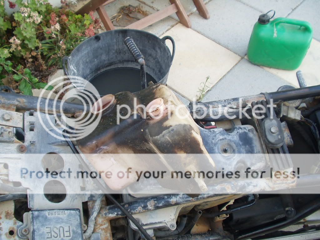

2T Oil tank, errr oily!

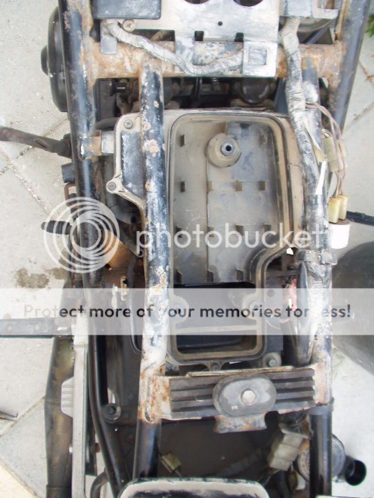

Got the air box out of the frame, had to call a gynaecologist in though:-
https://i645.photobucket.com/albums/uu172/Troodos-Pool-Guy/RZR%20250/AIRBOXOUT.jpg

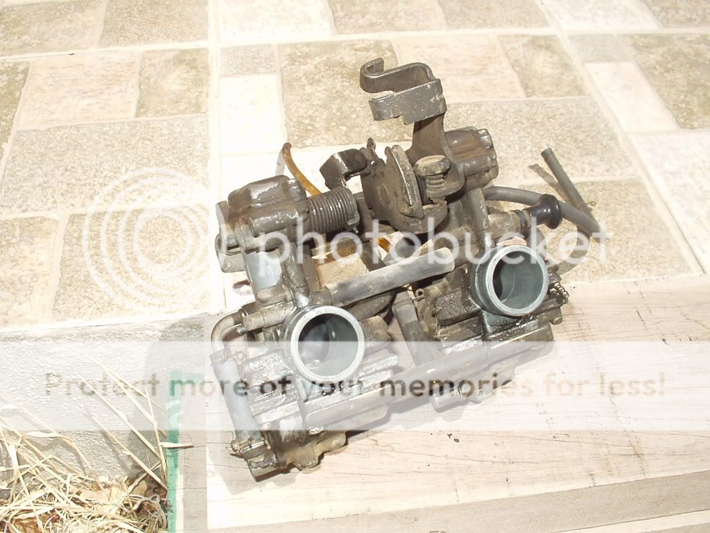

Carbs off, surprisingly all the rubbers are like new, amazing considering the climate out here, can anyone identify these carbs? I cant find any numbers on them.

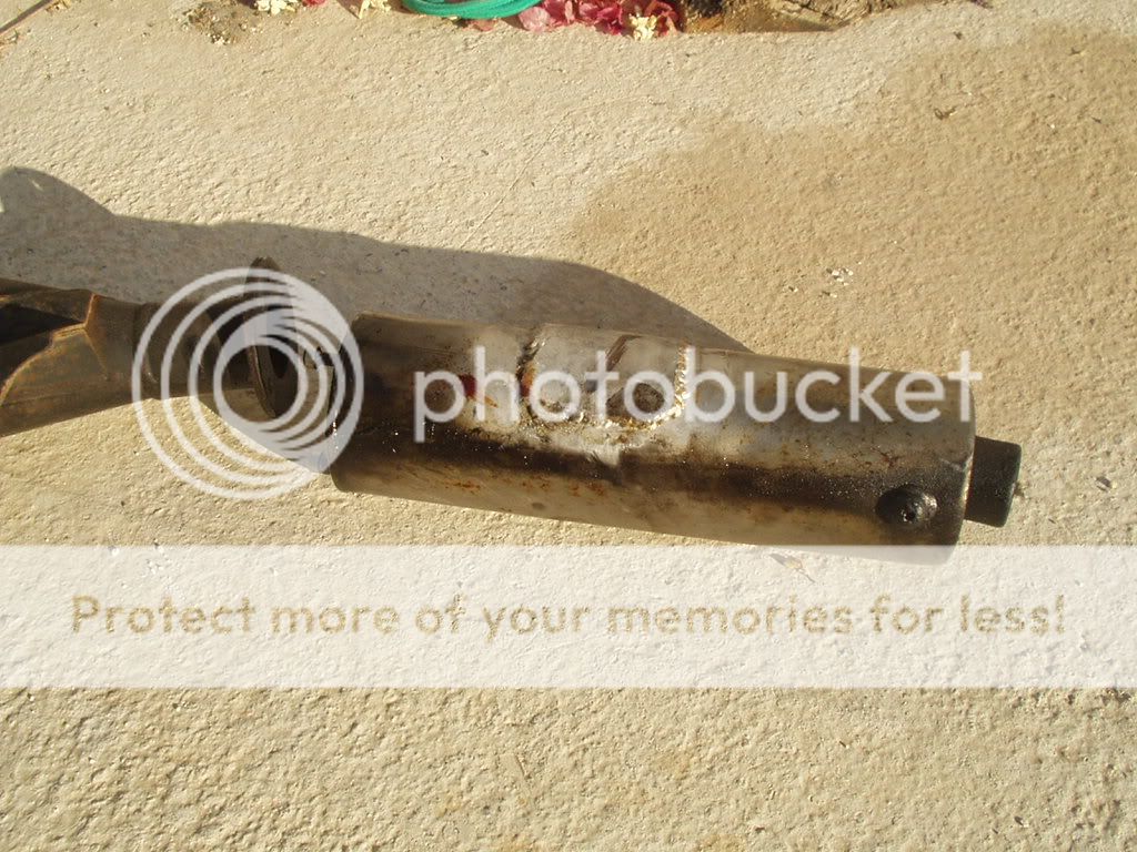

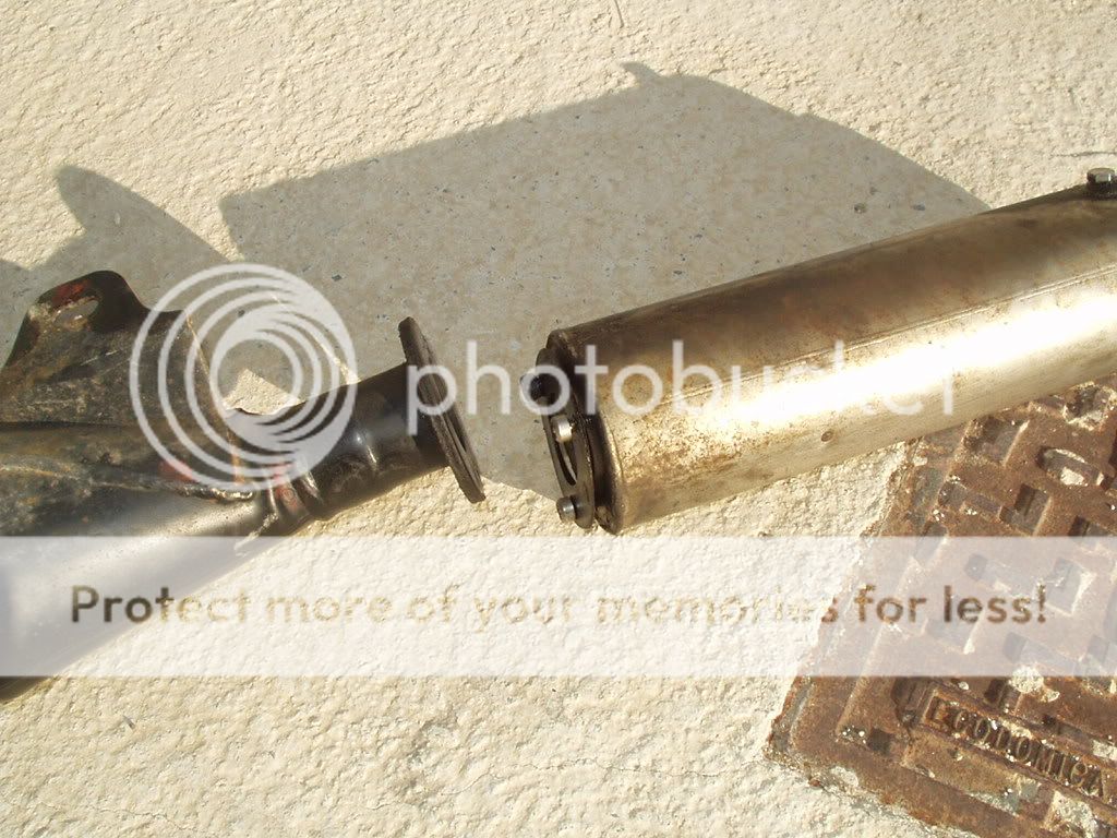

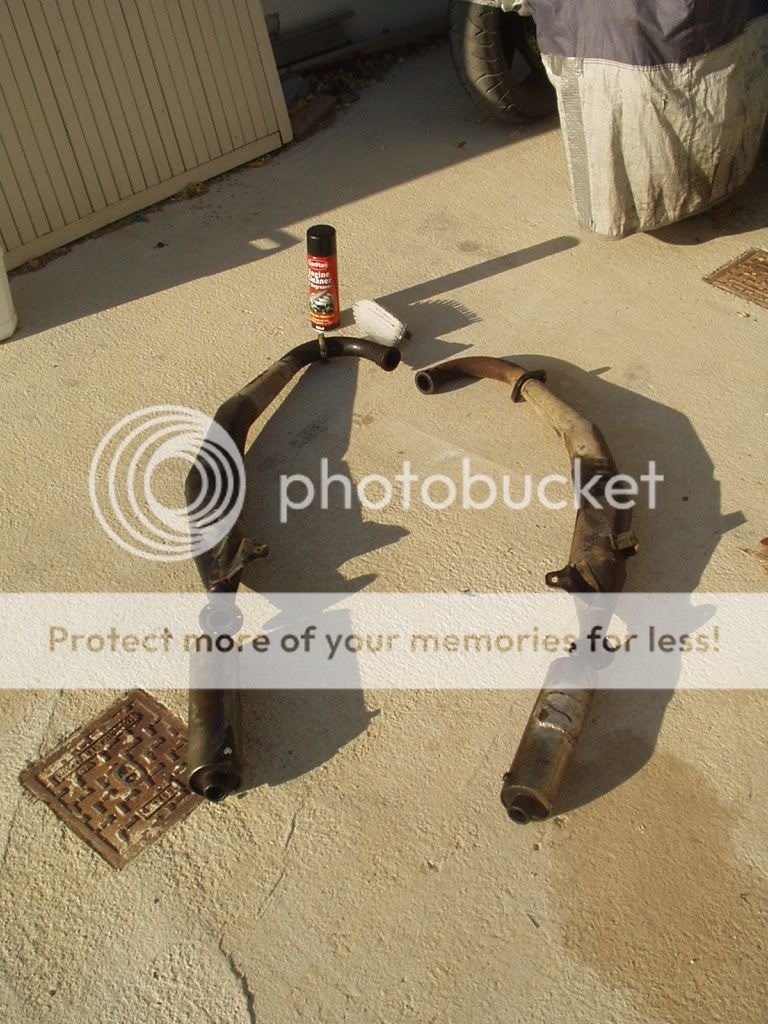

Here's the exhausts as they came of the bike:-
https://i645.photobucket.com/albums/uu172/Troodos-Pool-Guy/RZR%20250/EXHAUST1.jpg
https://i645.photobucket.com/albums/uu172/Troodos-Pool-Guy/RZR%20250/EXHAUST2.jpg
https://i645.photobucket.com/albums/uu172/Troodos-Pool-Guy/RZR%20250/EXHAUST3.jpg
There are a couple of minor dents, not a lot I can do about them!
Can I buy aftermarket cans for these pipes?

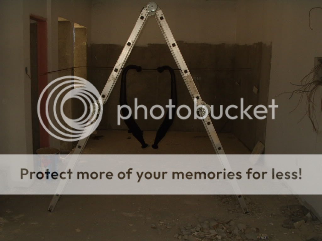

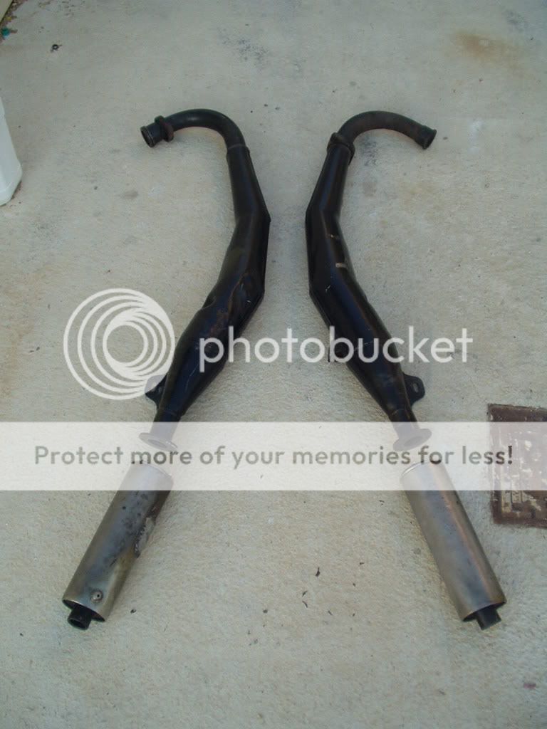

After degreasing:-
https://i645.photobucket.com/albums/uu172/Troodos-Pool-Guy/RZR%20250/EXHAUST4.jpg
during painting with high temp paint:-
https://i645.photobucket.com/albums/uu172/Troodos-Pool-Guy/RZR%20250/EXHAUST5.jpg

PostPosted: 22:59 - 14 Jul 2010    Post subject: Reply with quote
Not sure, but might be worth measuring them up and asking DEP. They look fairly similar to lower RD500 silencers which they do

The brakes look exactly the same as the ones on this model, can anyone confirm this?:-
https://i645.photobucket.com/albums/uu172/Troodos-Pool-Guy/RZR%20250/548.jpg
calipers /discs on that 350 look like the same ones as the xj600 which i believe are different to yours as they have the pad pins on the top with a removable cover to slide the pads out of, would need a close up of that 350 to be sure.

The brake issue: I've measured the pistons, they're 38mm diameter, does this size ring any bells?
Thanks for the feed back, I'll keep you informed of any progress, (likely to be slow). Cool
