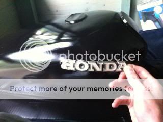

Update so far.....Ok so tank has its first coat of primer on, Airbox is on its second. Should get those finished tomorrow.
Tank after first coat:
https://i6.photobucket.com/albums/y211/kyranxxx/IMG_1146.jpg

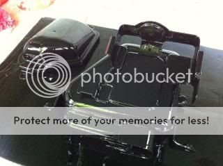

Airbox after second:
https://i6.photobucket.com/albums/y211/kyranxxx/IMG_1135.jpg

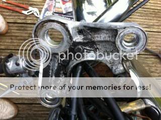

Cleaned up the front end a little aswell..
https://i6.photobucket.com/albums/y211/kyranxxx/IMG_1136.jpg

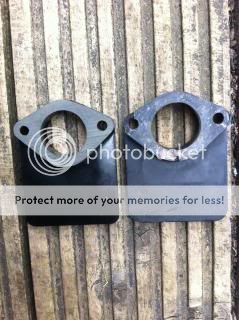

And here is the new heat-shield compared to old one on the right..
https://i6.photobucket.com/albums/y211/kyranxxx/IMG_1128.jpg
