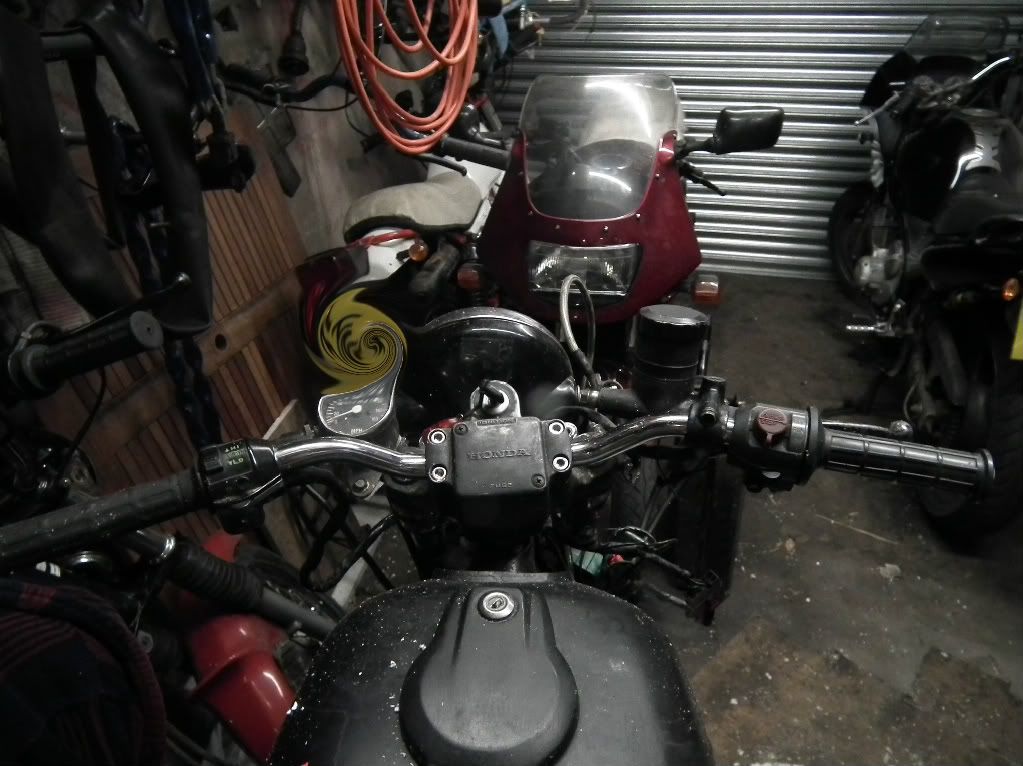

here is a picture of the seat the way it is, I will get some photos of the bike out side where I took the first photo from.
I have also included a picture of the handel bars im going to use as with clubmans, they look a bit stupit, lets be honest.
and with clipons the old handle bar holder is exposed leaving a great big empty space.

I think the biggest things to make it look more like a racer are clip ons, and longer shocks.

I would like clip ons, but apart from the thing i said before, but have you seen the price? :O

ahh spose.. the ones I were looking at were stupid money.
I have found some 35mm clipons which are about ooooooo. 99p Smile but the postage is £7 so i might just pick them up as they are not far from me.

An idea on the bars, if you flip them over and then turn upside down it should give you the look and feel of clip ons without the cost.
I see what you mean but I have seen other peoples bikes and they ruin the look Rolling Eyes
here's my attempt
https://i56.photobucket.com/albums/g164/Blurredman/P1060776.jpg
personally I think it looks related to this... https://i56.photobucket.com/albums/g164/Blurredman/3769139.jpg
and definatly ruins my Cafe look Laughing
so it's definitely clipons I'm afraid
