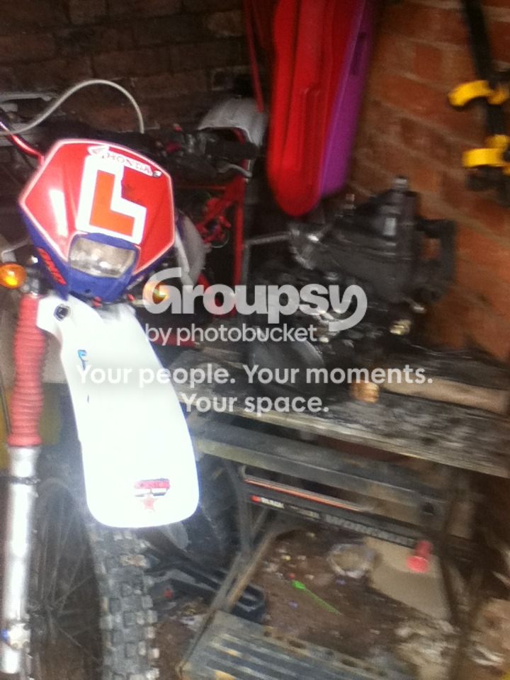

THANKS bikenut iv orderd a puller iv taken the engine out and started striping it down taken the head and pistion looks all good not much pitting on it and the bore looks clean but turning the fly wheel it still very bad and grinding ..
is it worth doing the small and big bearing theres not much play in them

so you didn't take the opportunity of carefully jet wash the engines outside and area,.............. its a runner so could have been left running to dry............ so no outside crap to join the inside crap..........more crank checks like up and down flywheel and endfloat............test for big end play.... rings........little end.........it was well held by the frame so making the flywheel nut and the lhs crank nut loose was easy, it has brakes...........but a breaker bar, really good socket and possible supported ......and a good purposefull w2hack with a mallet in the right direction.......but don't go over the top......
what did you learn from the g/box oil draining and dregs.......
now remove or open engine.......
so with stationery crank in a position to allow the conrod as much angle movement as poss......does it turn smoothly, don't catch, don't grab, don't stop?!.........or crunches for kellogs!.........can you see any metal flakes........if rod positioned you may be able to see thru a slit .......how is side to side tilt and side to side movement of the conrod/b/end assembly.........any up and down movement or play in the big end and rollers......
how is flywheel magnets.............
pics pics and more pics....also what you find out about bearing lube and prices etc......you have studied the cmsnl exploded views for the engine yes.........

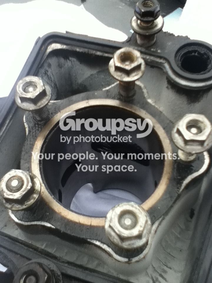

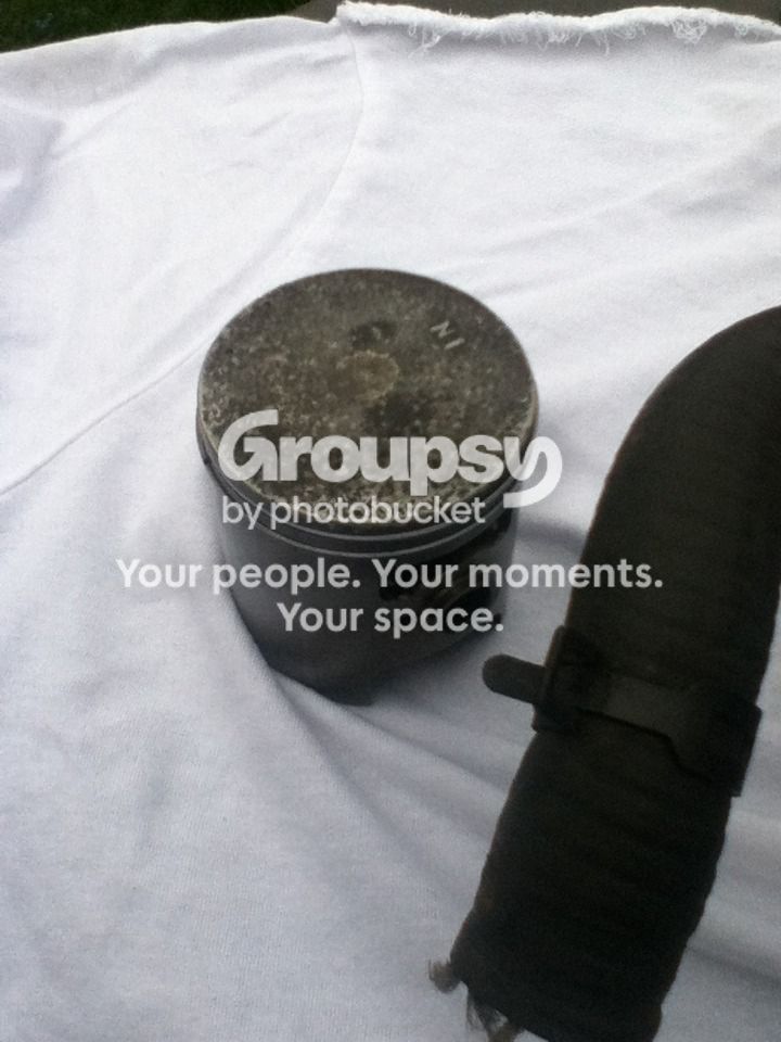

PostPosted: 17:54 - 13 Sep 2013    Post subject: Reply with quote
the gear oil was clean but on the conrod theres metal flakes . Theres no movement in the fly wheel but when moving it around by hand it grabs and feels rough.
When moving the conrod left to right theres less than .5mm of movement looking at the rollers and they look good .
piston looks good and the rings
https://i154.photobucket.com/albums/s267/jimbob005/null_zps8aa5769a.jpg
bore looks good
https://i154.photobucket.com/albums/s267/jimbob005/null_zps317e2c5a.jpg

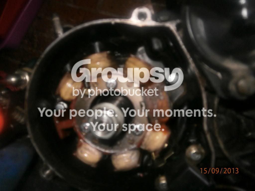

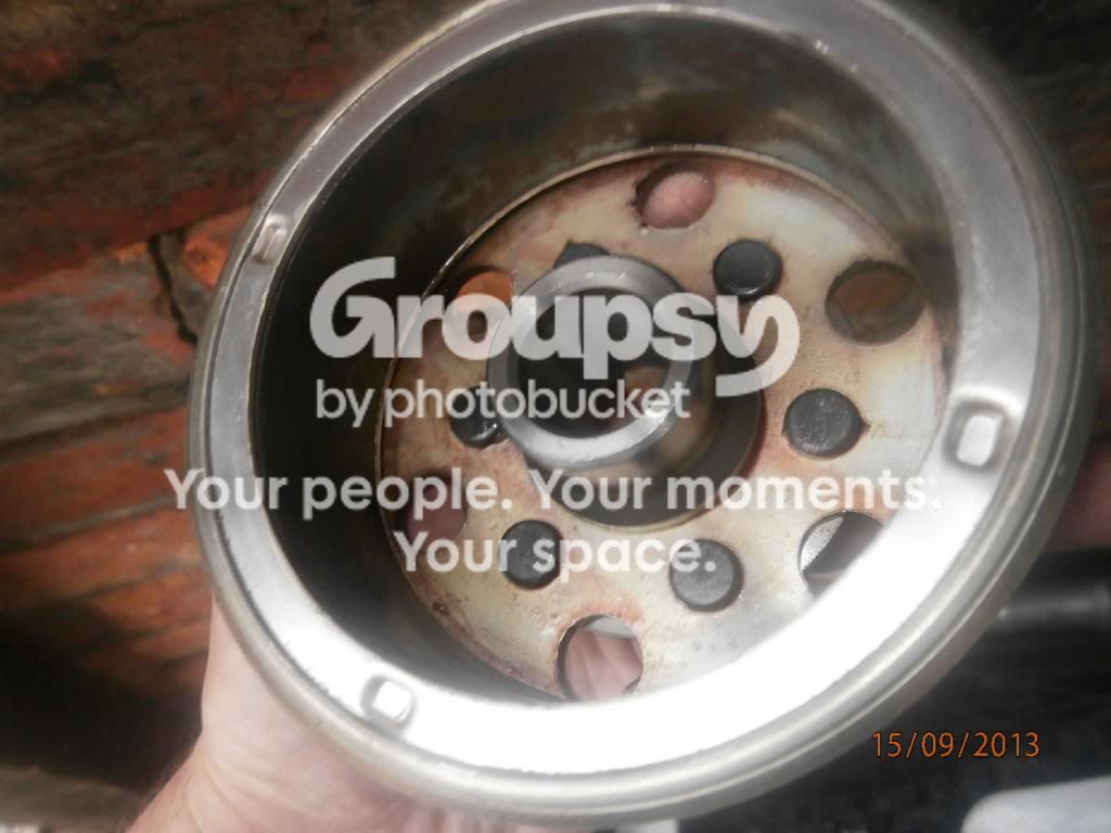

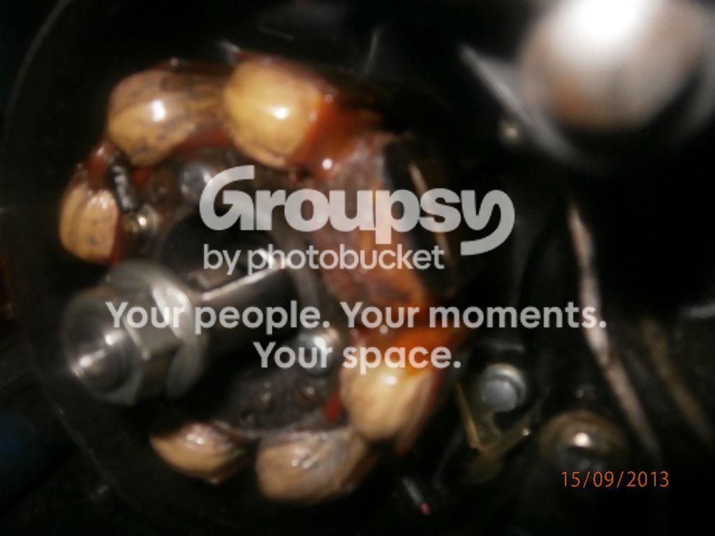

PostPosted: 17:45 - 15 Sep 2013    Post subject: Reply with quote
when spining it by hand it still jams up
nothing on the magnets
https://i154.photobucket.com/albums/s267/jimbob005/P9150011_zpsbcdb7079.jpg
https://i154.photobucket.com/albums/s267/jimbob005/P9150006_zps265bc093.jpg
https://i154.photobucket.com/albums/s267/jimbob005/P9150010_zps7e64c7a7.jpg
thanks james
bikenut
Joined: 21 Nov 2011
PostPosted: 12:01 - 16 Sep 2013    Post subject: mtx Reply with quote
hi james,
so big end ok ( hopefully )?? and mains jam..........
see cmsnl for how mains are lubed........crank seals will be a clue......

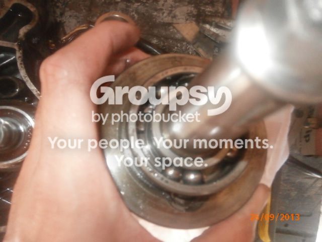

PostPosted: 14:38 - 26 Sep 2013    Post subject: Reply with quote

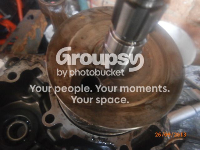

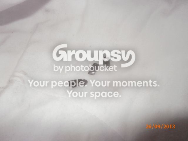

hi there not had much time to carry on with this till today and i can say its one of the main bearings have failed
when opened up found this
https://i154.photobucket.com/albums/s267/jimbob005/P9260119_zpse527682b.jpg
https://i154.photobucket.com/albums/s267/jimbob005/P9260124_zpsc2aa0f2b.jpg
and then i taped out the over side to see that bearing
https://i154.photobucket.com/albums/s267/jimbob005/P9260126_zps0e433f48.jpg
https://i154.photobucket.com/albums/s267/jimbob005/P9260125_zpsa7450630.jpg
[/list]
bikenut
Joined: 21 Nov 2011
PostPosted: 15:23 - 26 Sep 2013    Post subject: mtx Reply with quote
8o) wwwwwww lovely...........just as well you didnt run the engine again.........any damage to casings, gears etc and did you find out about the non f/wheel side main bearing lube method........ 8o)
nuts about bikes
jimbob005
Joined: 25 Nov 2012
PostPosted: 15:49 - 26 Sep 2013    Post subject: Reply with quote
no damage to the casing but its riped the oil seal so will replace this and the lh bearing
all the bits have been kept up at the crank end of the engine all the gears look good
iv not looked how the bearings are oiled ill having a good look at the haynes
PostPosted: 16:54 - 26 Sep 2013    Post subject: Reply with quote
jimbob005 wrote:
No it doesn't.
It looks like someone's been battering the crown with a ballpeen hammer.
bikenut
Joined: 21 Nov 2011
PostPosted: 19:33 - 26 Sep 2013    Post subject: mtx Reply with quote
see cmsnl and look at the crank seals.......have a good look........stinkwheel suggests you look at the piston also.........will look 2morrow, hope i can zoom in to see............check rings, barrel......ports
if bits have ended put in the piston crown, they wiil have gone via ports etcc........
nuts about bikes
bikenut
Joined: 21 Nov 2011
PostPosted: 10:49 - 27 Sep 2013    Post subject: mtx Reply with quote
8o) having looked at an mtx piston crown this morning, the crown has a mottled appearance ( sand cast? ) as normal,
but your piston does have more than this, all the bits of bearing cage etc. having made there way to the combustion chamber......
you can see at more or less 6 o clock, marks ( flats ) made by debris........2 smallish "flats"..........right on the edge of the piston crown.........
any chunks missing on the rings and where they fit into the piston....or imbeded debris.....use a magnifying glass.....
how is the cyl head..........
and how is cylinder bore........any chunks missing by the ports or gawjes, tram lines, deep grooves etc.....anything that will break the rings.....etc.....
how is the inner crankcase chamber ( where the crankshaft lives ) for embeded debris and any cracks...........
how is the big end bearing, can you see the roller surfaces through the conrod "slit".........
and how is the little end caged roller bearing and the gudgeon pin, not to mention the little end eye in the conrod........
all the debris has gone somewhere ( some down the exhaust pipe ) .........
