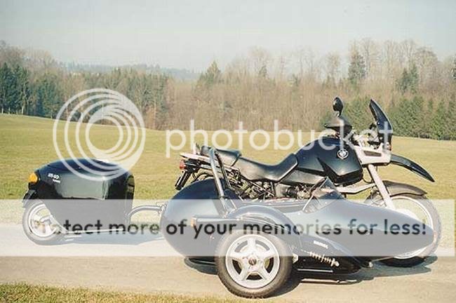

to be honest I looked into this a number of years ago - the idea of touring with zero luggage 'on' the bike itself was very attractive... but the costs were too high for me to bear at the time.
I liked this set-up. Its a shame the sidecar obscures the 'hitch' - but hey ho.
https://i172.photobucket.com/albums/w40/motobiker/fullyloaded.jpg~original
all these years later Im still 'thinking' about it.. if a second hander appeared at a reasonable price then I might be tempted. but other than that its just an idle thought.
