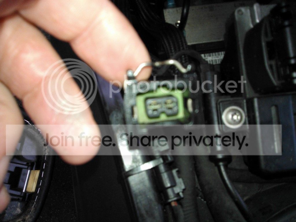

Someone gave me this last night, saying they thought it would fit my bike, and let me power accessories.
https://img.photobucket.com/albums/v616/THXII38/temporary_zpsc8ab9e06.jpg

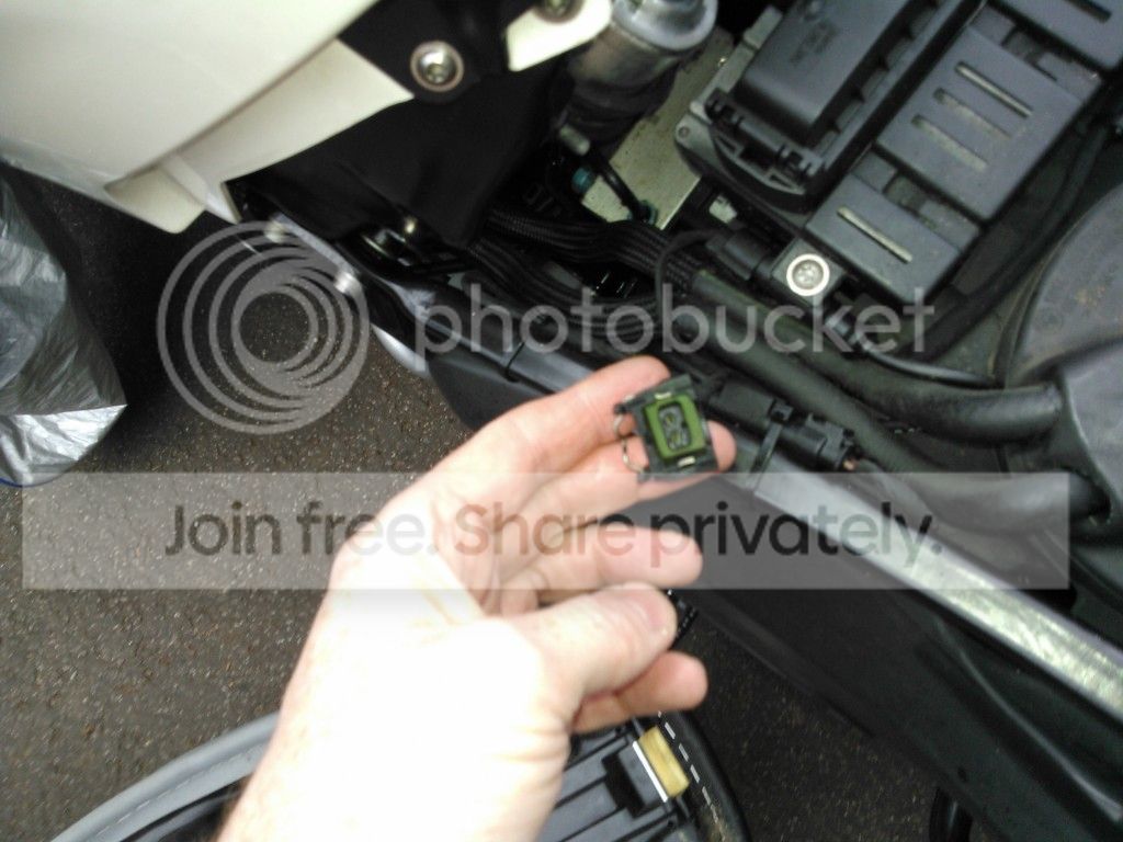

It was dark in the carpark last night, couldn't find where it went. Today, I looked in my manual this morning, and after a search found what I assume is the power socket? Doesn't fit of course.
https://img.photobucket.com/albums/v616/THXII38/temporary_zpsa8a636a8.jpg
https://img.photobucket.com/albums/v616/THXII38/temporary_zpsabc3ce7c.jpg
Do these have particular name?
I want to be able to plug my phone in, so I can charge it on the go, and use the sat nav facility / and or the garmin sat nav, both which have USB chargers. Not sure what cable/wire I need?

I think that is the diagnostic socket for your bike.
I'm not sure what you have photographed in the first pic but to charge your phone etc you will need a 12v socket sometimes called a cigarette lighter socket it should come with two wires (positive and negative)

You have been given a powerlet plug, many European bikes including BMW and KTM come with them fitted and even more have a take off point on the loom to plug the socket into. Unfortunately the accessories for them cost more than ones for cigarette lighter sockets so many people fit those instead.
If you don't have powerlet sockets on your bike it would be considerably cheaper to just fit a cigarette lighter socket.

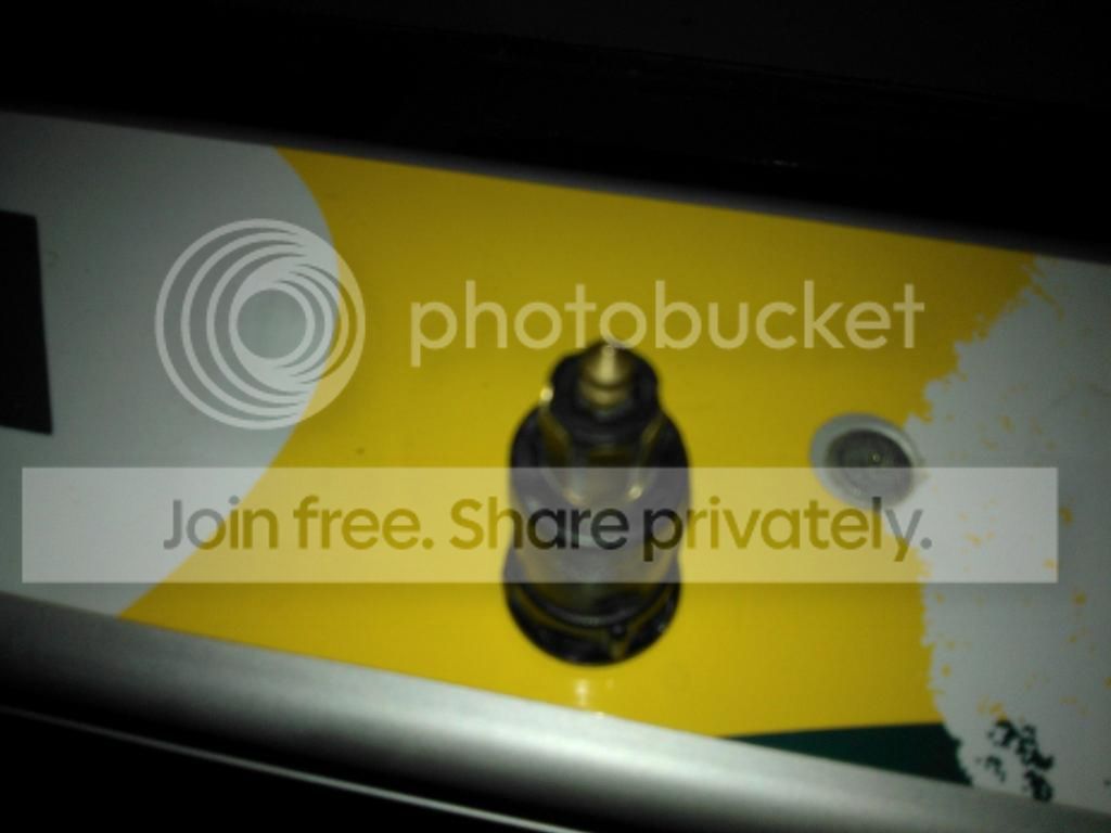

Dunno about your thumper, but my GS has a Hitler-DIN power socket to the left of the ignition barrel, with a flappy cover over it.
Above the "m" at the end of .com:
https://i40.tinypic.com/2rnvm0l.jpg
It's a silly fiddly little thing, so I've put a proper Chuchillian lighter socket up on the bars as well.

What you were given looks like the BMW plug that you attach accessories to.
You will need the corresponding BMW socket somewhere on your bike.
That socket could possibly be connected to the accessory power output that is possibly the green connector in your second pic.
As said above, the BMW socket is not the same as cigarette lighter type socket (and plugs). However, they are considered more secure.

Ignore the thicko? Have you read what you just wrote? You basically said what I said but explained what the part is? Are you saying you know what every single part on every motorcycle is? That socket looks very much like the diagnostic socket which you plug a diagnostic scanner into.

I am a BMW Poseur, all BMWs have the power socket somewhere on the 'outside' of the bike on the left.
Usually under a wee flap. They supply power outside of the CANBUS so anything connected and switched on will draw power.
You will deflate the battery if left on with the engine off.
Look under the seat edge or near the area infront of where your shin would be.

The F800GS and variants have it up on the fake tank next to the ignition, and it switches off a minute or so after the ignition is turned off.
Eff all that though, just wire a proper lighter socket straight on to the battery, via a relay switched from the lights if you really can't trust yourself not to leave something plugged in. Wink
