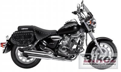

Oh lordy...
https://www.bikez.com/pictures/keeway/2012/35543_0_1_2_superlight%20125_Image%20credits%20-%20Keeway.jpg
Could be a new engine just being a bit tight, could be that the fuelling is off.
What I found on my Chinese carbed 125 was that the idle mixture was set a bit lean, presumably as part of scamming Euro 3 emissions. Backing the idle screw out half a turn improved the response when pulling away.
If you have an obvious idle mixture screw (sorry, I'm not familiar with your carb) you could give it a go. Warm it up, tweak the mixture until you find where the revs are highest, it's just simple trial and error.
The dealer can probably do it, but they may just trot out the usual "Oh, they all do that, come back when it's out of warranty and we'll look at it then." Wink
