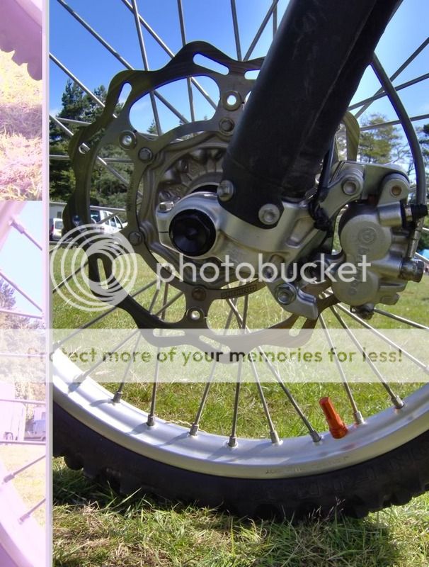

The 'Braking' front disc on my KTM enduro has similar amounts of movement and has never been a problem with my MoT tester
https://i666.photobucket.com/albums/vv23/WiNot_Rhencullen/Dirt%20bikes/20090726_3.jpg
Talon Engineering are importers for these discs so if you have any problems I would ask them for their advice
