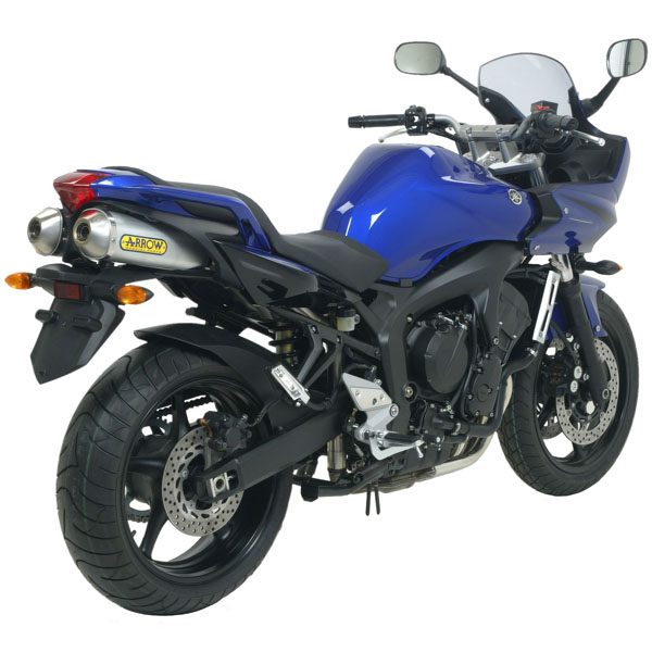

Where's the peg in relation to the pipe? That would usually be the limiting factor in how much they might be lowered.
I'm not familiar with the peg-hanger arrangement on the FZ, so there could be some curiouse feature about it; but my initial reaction, would be some dural-plate of e-bay... a drill, hack-saw, and a couple of M10 bolts.
Just make a plate with two holes in, to drop the mounting point an inch or two... bit of channel section might do job even better.
Matt B
Joined: 01 May 2012
PostPosted: 09:30 - 11 Dec 2013    Post subject: Reply with quote
Quite a long way off due to the underseat nature of the exhaust!
Under the seat, but surely you're just playing us a long as you would have known that due to how familiar you are with modern 600s?

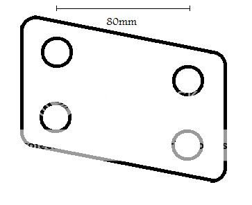

Is she really really tall or something?
I just sat on the FZ6 pillion and to me (@ 6ft) it feels pretty roomy compared to some bikes I've been on.
Make yourself some brackets, or get some made up, then you can drop the pegs as much as you want. Just needs to look like this:
https://i1077.photobucket.com/albums/w462/MattB70/BossPegLoweringBracketDesignMk74_zps5100918b.jpg
Alternatively, just stop taking her out on the bike...
