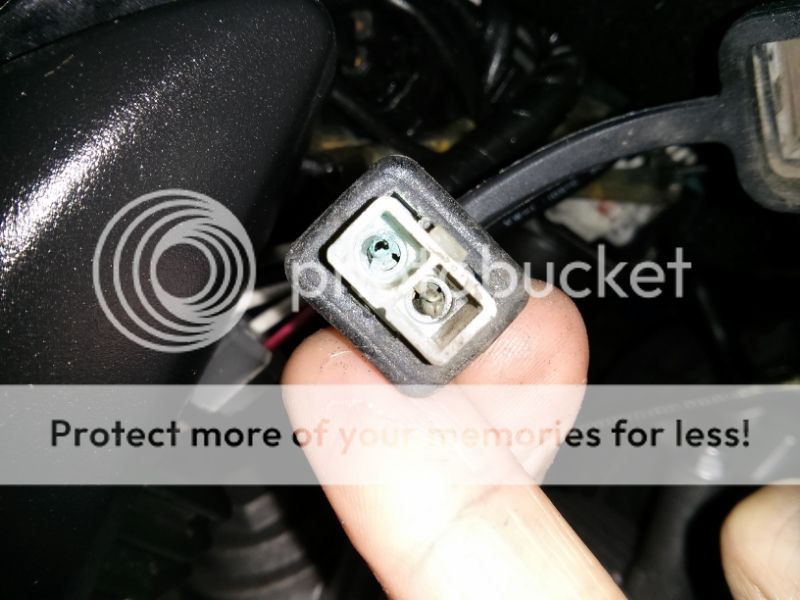

Hello folks, first post on here and new to biking. I played it safe and bought the test centre's favourite to learn on; a 2008 YBR 125 - with the power of ten snarling Shetland ponies at my disposal, I'm loving biking so far. Smile
Anyway I've been searching for the name of this plug and what its used for. It isn't connected to anything and has a rubber cover over it. I'm guessing it's a battery charging plug? but just wanted to be sure.
https://img.photobucket.com/albums/v519/Ben90/Mobile%20Uploads/IMG_20140206_143247_zpsrtxqwpas.jpg
It looks just like one of those white plugs for RC car battery packs I had as a kid.
The bike is injected if that makes any difference.
Cheers!

Could be the interface connection for a fault finding device, follow the cable back see if it goes to the battery.

It is indeed for a battery charger to be connected.
Trace it back into the side fairing on passenger side where the battery sits and you'll see it's just connected to the battery and nout else Smile

Thanks for your replies Smile I did think it might be a diagnostics port at first but it only has two pins?
If it merely connects the two battery terminals together might it be better used for a tidy DIY accessory socket install? Hmmm. Rolling Eyes

That's exactly what I use it for. I plug it into a charger at home and then plug in a cigarette lighter-style socket when out and about so I can power my sat-nav or charge my phone.

Brilliant. So I'll just need a tamiya male plug and a 12v socket and wire them together?
It seems male plugs have female pins and vice versa, this will make ordering the part online interesting..

Just thought I'd suggest cleaning it up and
adding a dab of dielectric grease (OK, vaseline) to keep it protected
from the elements

Ordered the bits I need. The 12v-to-5v USB socket I bought already has eyelets for hard wiring to the battery so will probably just use them.
Thanks WD. I've removed the worst of the corrosion and applied a bit of ACF 50 in there, should do the job! Thumbs Up

It's called an SAE plug, they are somewhat more common in the USA but seem to be cropping up more here recently.
Optimate chargers have moved to this more sturdy SAE connector recently.
What you have there is sometimes called a battery tender lead, you can easily plug in a charger or use it with a range of adapters for accessories such as heated clothing, work light and USB charger.
Just be aware it is always live so there is a slight risk of discharging your battery.
