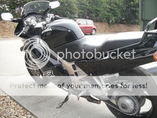

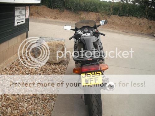

Anyway. A 1992 VFR750 with 14k miles on it. I called up and asked specifically about the condition of the plastics, if there were any cracks or missing lugs and the source of the dent on the tank. I was assured the panels had odd scratches here and there but were in overall good condition and that the tank looks like something's been dropped on it, no scuffing on the plastics or signs of it having been down the road.
It came with the following pictures:

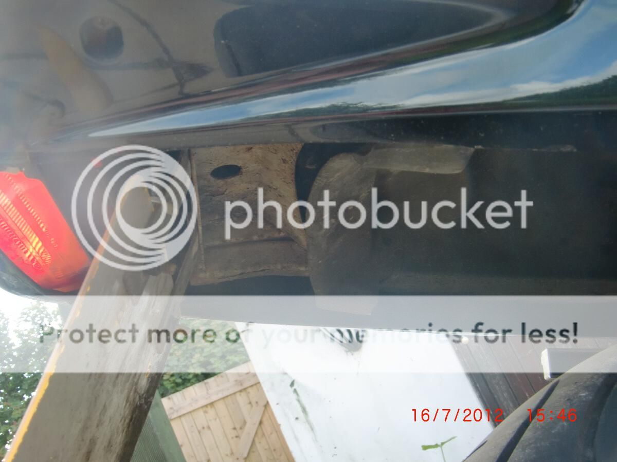

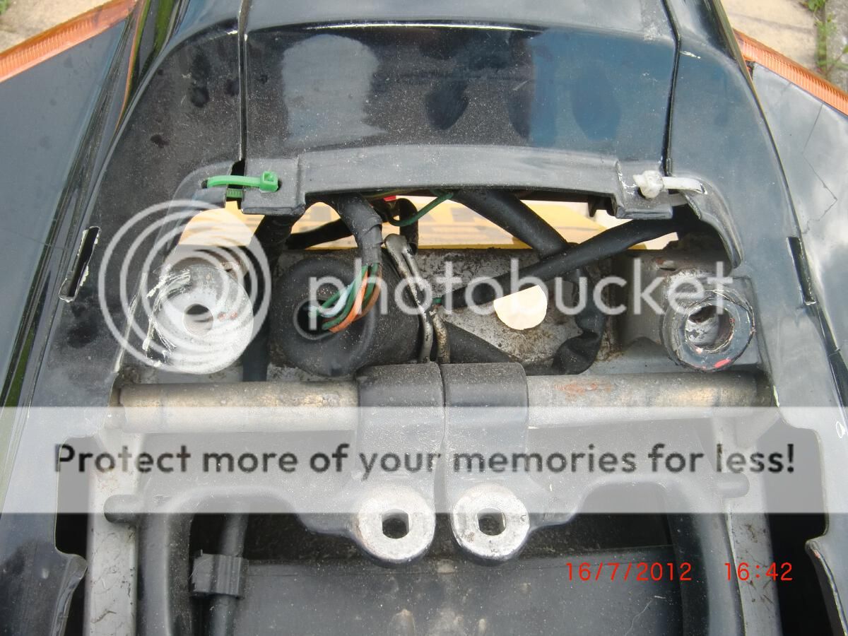

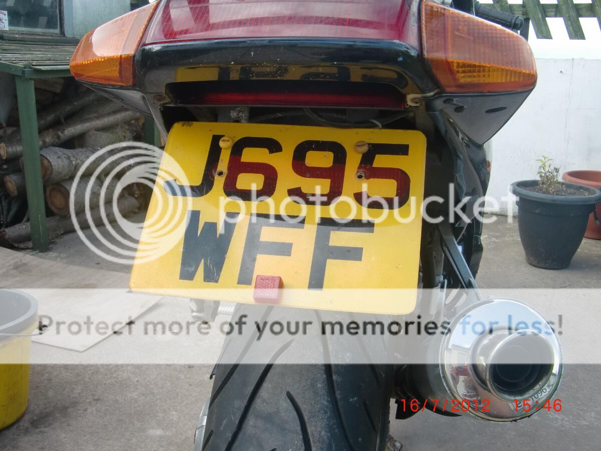

First thing that struck me was a general feeling of tattiness when it arrived.
I started having a poke about. Something seems odd and why is there a reflector on the plate? Confused
https://i48.photobucket.com/albums/f216/stinkwheel/VFR/CIMG0621.jpg

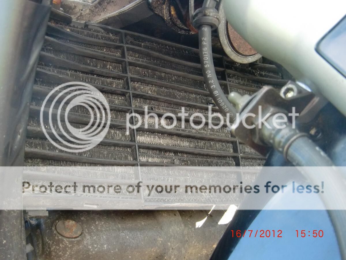

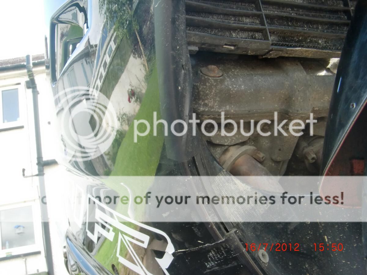

Now those are nice and shiny fork stanchions but the radiator is in a shit state. It's worse than the one on my old VFR with 60k miles on it. How can you have clean stanchions and a fucked radiator?

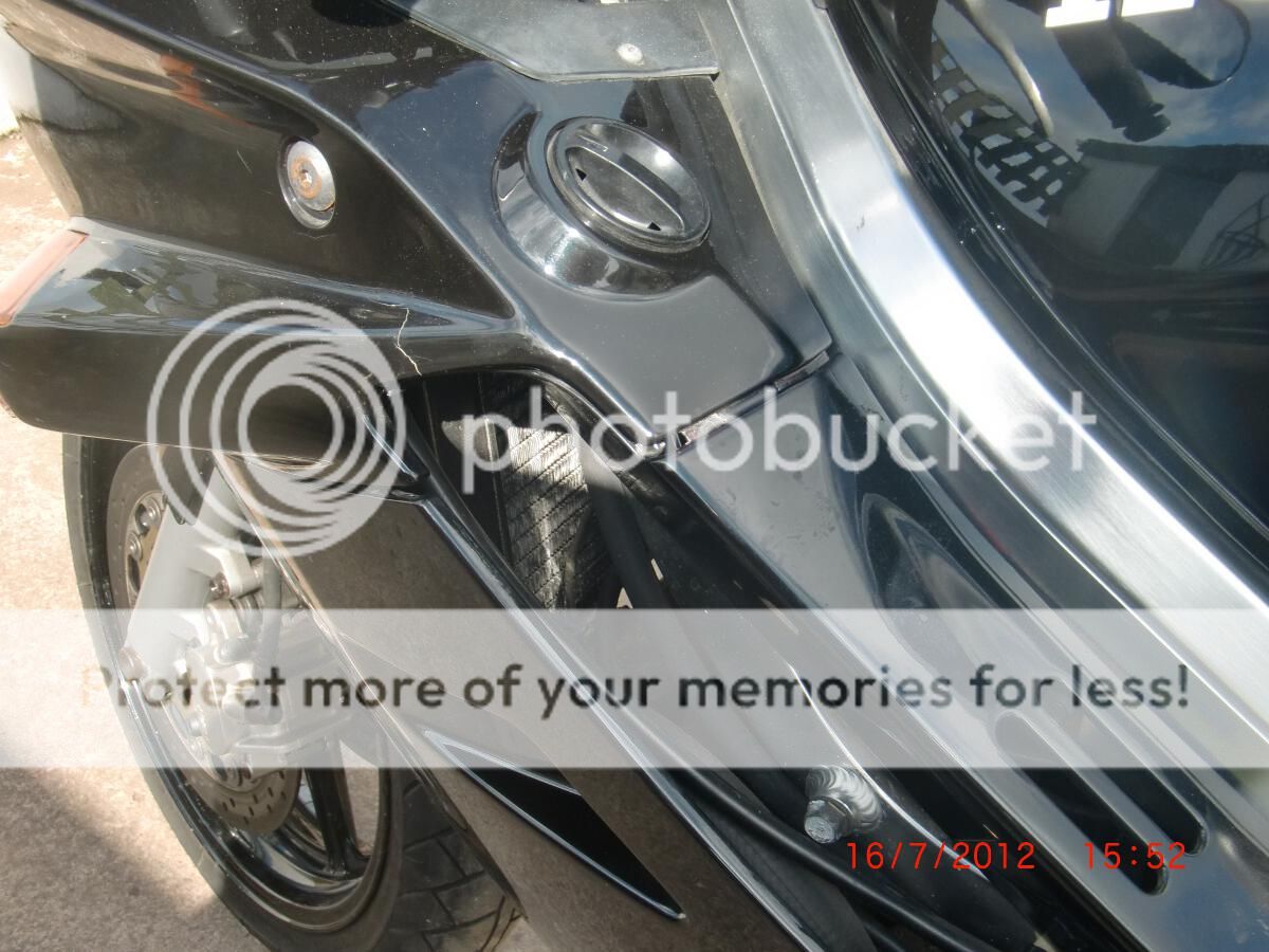

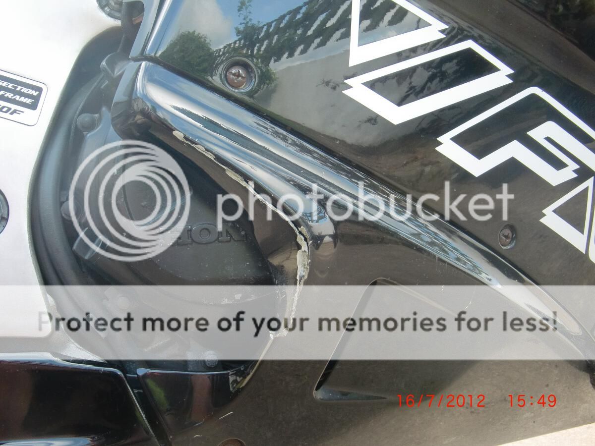

Ok, front fairings then.
Belly pan cracked and scuffed but no scuffing on the panel behind it. That's because it's new and has been resprayed:
https://i48.photobucket.com/albums/f216/stinkwheel/VFR/CIMG0633.jpg
https://i48.photobucket.com/albums/f216/stinkwheel/VFR/CIMG0634.jpg

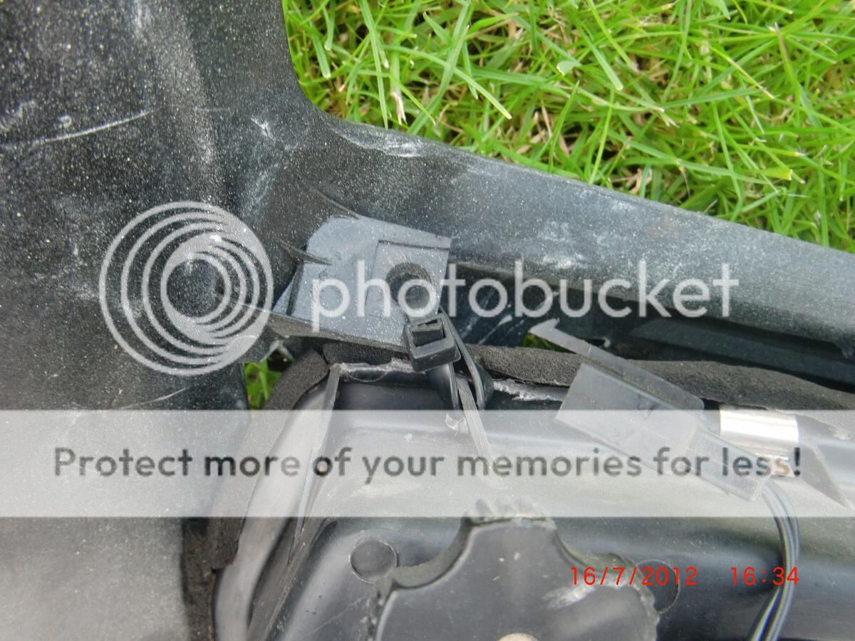

Right mid panel. Split to buggery, held on with PVC tape and that's a cavity wall fixing you can see on the centre infill.
https://i48.photobucket.com/albums/f216/stinkwheel/VFR/CIMG0637.jpg
Remove the panel and tape and the infill is in two bits with the lugs snapped off.
https://i48.photobucket.com/albums/f216/stinkwheel/VFR/CIMG0654.jpg
Left panel is a shoddy fit too. Honda didn't make it like that. It's a sign of a bent front subframe:
https://i48.photobucket.com/albums/f216/stinkwheel/VFR/CIMG0648.jpg
It's been forced into place and cracked when they tried to do up the Dzeus fitting.
https://i48.photobucket.com/albums/f216/stinkwheel/VFR/CIMG0650.jpg

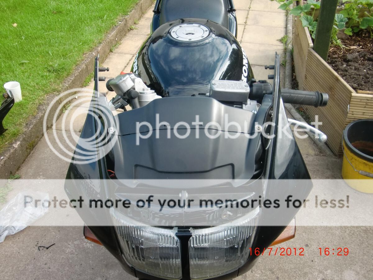

PostPosted: 23:39 - 16 Jul 2012    Post subject: Reply with quote

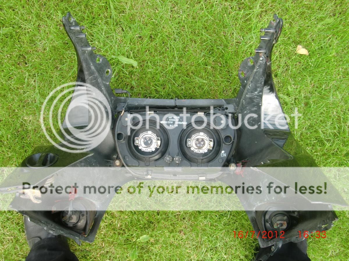

What about the top fairing then. That looks ok?
Or has the leg been snapped off it?
https://i48.photobucket.com/albums/f216/stinkwheel/VFR/CIMG0641.jpg
Actually, the headlight has been snapped off the inside of it too:
https://i48.photobucket.com/albums/f216/stinkwheel/VFR/CIMG0658.jpg
https://i48.photobucket.com/albums/f216/stinkwheel/VFR/CIMG0659.jpg
https://i48.photobucket.com/albums/f216/stinkwheel/VFR/CIMG0660.jpg
https://i48.photobucket.com/albums/f216/stinkwheel/VFR/CIMG0661.jpg
These clocks on the other hand, look remarkably new and cleaner than the reast of the bike. That's because they are and are reading at least 25% less than the actual mileage according to the MOTs.
https://i48.photobucket.com/albums/f216/stinkwheel/VFR/CIMG0657.jpg
So. There are a total of zero undamaged panels. The rear mudguard is missing as is a top infill panel. The radiator looks older than the rest of the bike, the clocks are newer as are the fork stanchions. Has this bike been crashed?

this is the least of the issues, but the reflector is not on the number plate in their photos. what's that about?
EDIT: sorry, just saw your second post. Isn't it illegal to diddle the mileage through any means even changing the clocks?
Also there's a scrape on the engine and a mis-match of scrapes where two bits of fairing meet. Have they had a crashed bike missing some bits of fairings left the fcuked ones on then replaced the missing ones with smashed bits from another bike?
Either it's been in a frontal and the old ones bent or they were so badly corroded that some previous owner had to recently replace them?
Edit: Fucked front fairing and lights and dodgy new clocks, definitely a frontal

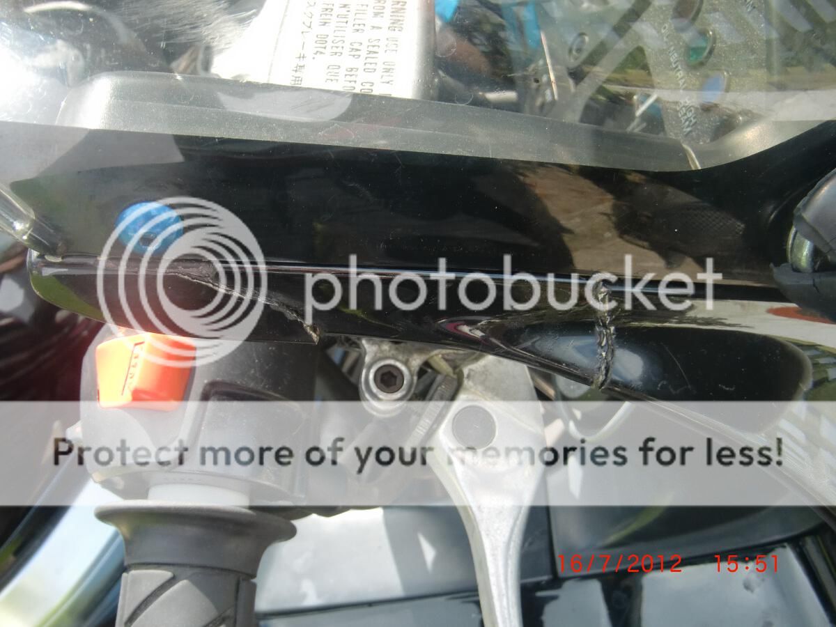

Crashed? More like flipped!
Scuffing on the top of the clutch master cylinder.
https://i48.photobucket.com/albums/f216/stinkwheel/VFR/CIMG0646.jpg
Bar end.
https://i48.photobucket.com/albums/f216/stinkwheel/VFR/CIMG0645.jpg

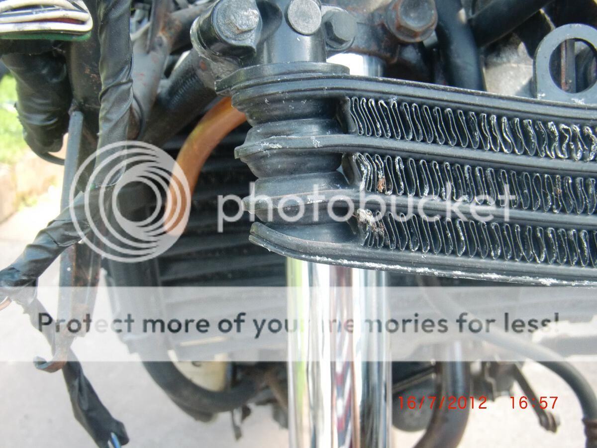

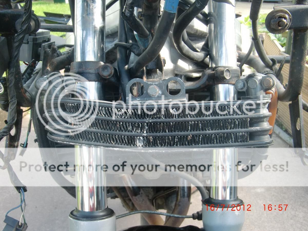

Think that's bad. Check out the shape of the oil cooler. I think this explains the new stanchions and old radiator:
https://i48.photobucket.com/albums/f216/stinkwheel/VFR/CIMG0665.jpg
https://i48.photobucket.com/albums/f216/stinkwheel/VFR/CIMG0666.jpg

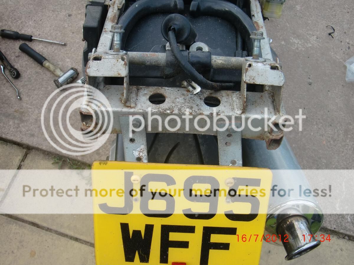

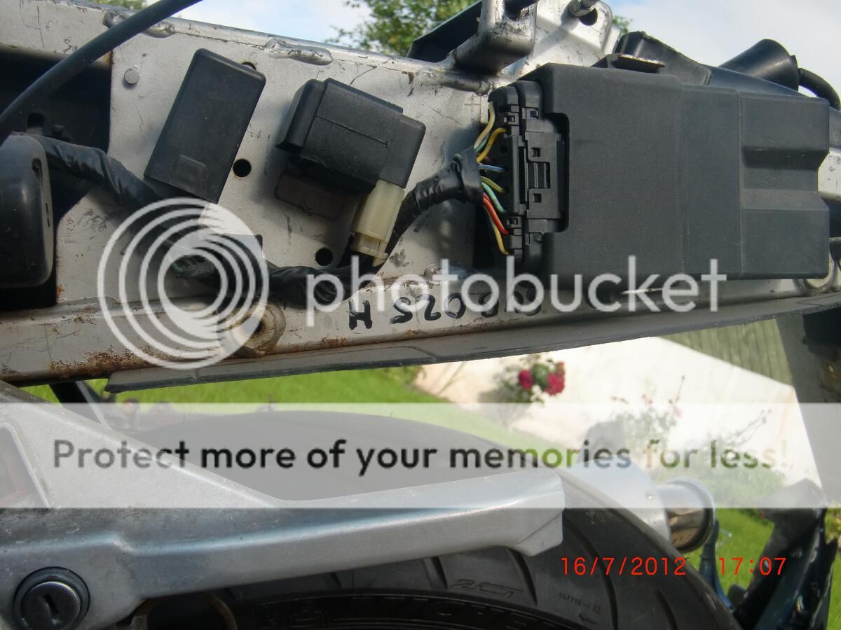

It gets worse. Are those breakers marks on the rear subframe?
https://i48.photobucket.com/albums/f216/stinkwheel/VFR/CIMG0667.jpg
What. The. Actual. Fuck?

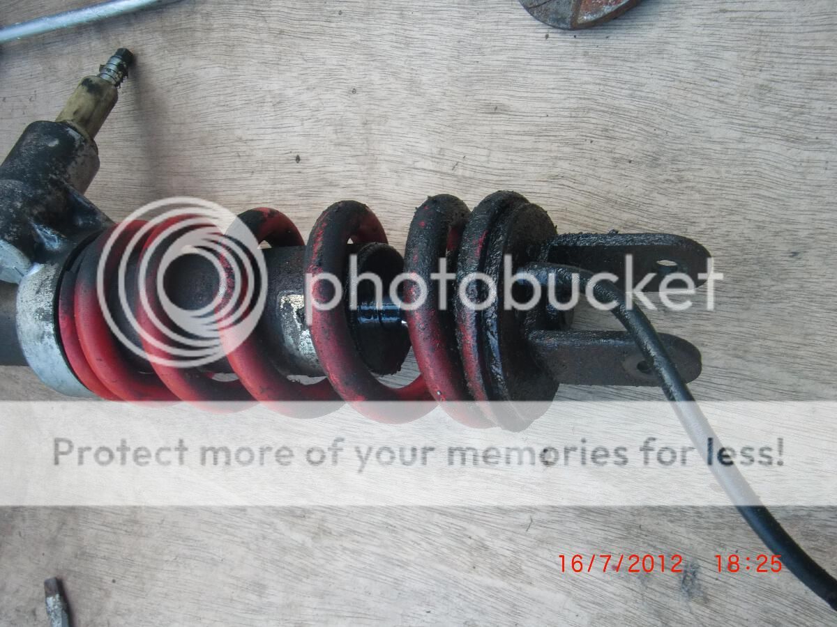

Icing on the cake. The rear shock has shat itself. MOT is 18 days old and the bike has done 10 miles since. It was delivered with a flat battery and not enough fuel to make it to the filling station a mile up the road.
https://i48.photobucket.com/albums/f216/stinkwheel/VFR/CIMG0672.jpg
