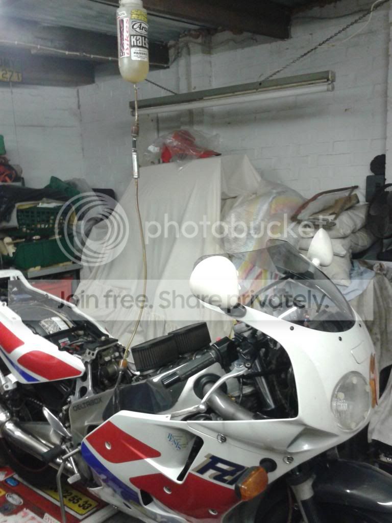

I also use an auxiliary tank
https://i666.photobucket.com/albums/vv23/WiNot_Rhencullen/Workshop/2013-11-14164634_zps4d7a6be8.jpg
