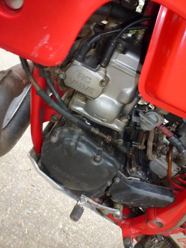

Okay - went round this morning for a closer look. Guy let me have a go, as luckily he lives on a private road. Yes these mythical by-ways do actually exist in some places. Wasn't much room to get going though cos even though technically speaking it was about quarter of a mile of surfaced road, it went round a block of houses with loads of parked cars. Still, did manage to get into third and got a teeny tiny whiff of what the bike might do if ridden in anger.
In the event it was fairly easy to kick it up and the bike seemed happy enough to start from cold and warm (obvs didn't get it HOT as such, but it was warmed through). Idled well.
Man - the brakes are pants. And I'm used to crap brakes - but these were the scary side of "adequate." But then, the discs are totty, weedy little things - to keep weight down, I guess. The whole thing only weighs 118 iirc. There's nowt to it. Front wheel will probably flip up like a right bar steward once its properly underway.
So yeah - all seems good, bracketing the small issue of the somewhat wimpish stopping power.

That chain is near the end of its stretch limit.
Brakes will probably need a little look at but nothing major.
The exhaust has been painted previously, but doesn't look AIDs ridden.
I'd probably get some £££ off for the chain (and sprockets Wink ) being close to dead.

Thanks man - good point. So I did actually ask him about those snail adjusters (as I haven't used them before), and said which way do they wind out because if it's this way *pointed to shortest part of adjustment* there's not much left at all. I'm assuming 40 is the max, it's on about 38-39 now. Teh guy claimed not to know which way they adjusted. Which felt a little bit like flannel to me - although I let it go.
As for the sprocks, he has the originals in a box - the ones on are geared for acceleration not top end, apparently. So I guess it'd be a matter of seeing what the originals look like to try and head him off at the gap if he said well actually the one's on it are a bit shagged but I am including you the originals, so don't try that one sonny.
Chain's definitely a good opportunity to chip away though. Thumbs Up

Yeah, that type of adjuster is nice, but that is showing it is near dead Thumbs Up

If the bike has been geared for acceleration it may well be that a smaller front sprocket has been fitted.Which may well mean that the chain is good but the adjusters are taking up the slack because of the change of sprockets.
The only way to see if the chain is goosed is to see how far you can pull the chain away from the back of the rear sprocket.
As for the brakes,the front pads look new as you can still see the red paint on the inboard pad.EBC pads at a guess.Maybe just need bleeding through with some new fluid.With the way that the hose loops up from the master cylinder,quite often air gets trapped in that loop and can be a biatch to bleed.I have had that problem in the past with the same loop on my XR400.
But this bike does look clean.Not sure what tyres they are on there.I have recently looked at a 2004 DRZ400S for a friend and it was in a terrible state compared to this CRM.

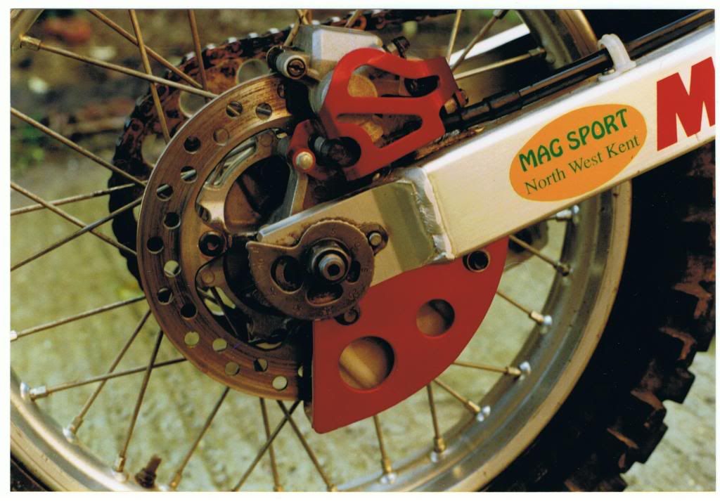

The standard rear disc on my XR400 worked well in the wet,in the mud or in the dry
https://i666.photobucket.com/albums/vv23/WiNot_Rhencullen/Dirt%20bikes/MyXR400001.jpg
But eventually it wore out and I believed the EBC advert and so bought on of their 'OEM' direct replacements.But whatever pad I used they just did not work until I used the Ferodo MX pad.It may well be that using an EBC HH pad on the rear would work,but I have a distrust of EBC pads and shoes that go back a long way.
But even using a decent pad material,the EBC rear disc did not have the same 'feel' as the OEM Honda one did.Maybe source a Honda one on eblay??
