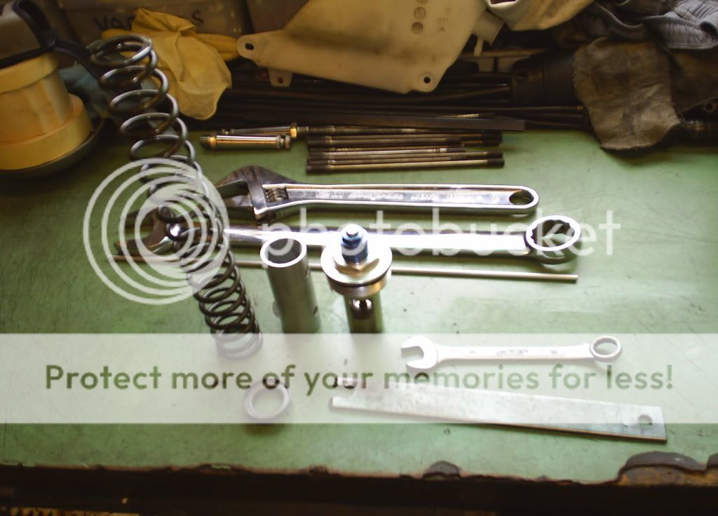

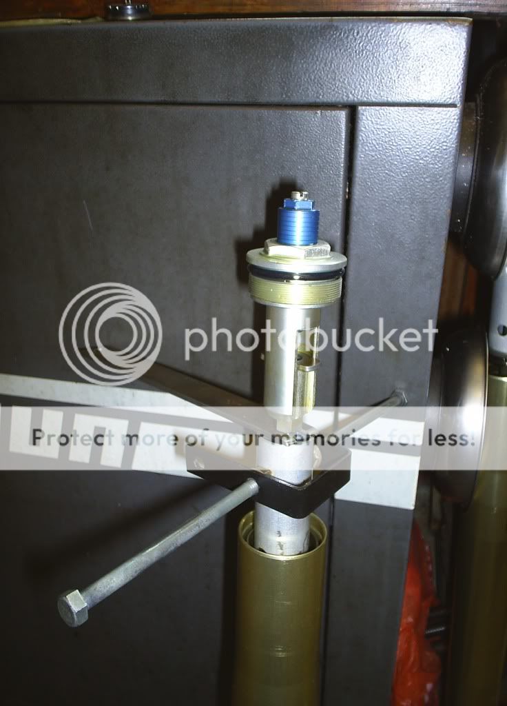

It is possible to make your own tools,as I have done for R1 USD forks
https://i666.photobucket.com/albums/vv23/WiNot_Rhencullen/Workshop/Picture476.jpg
https://i666.photobucket.com/albums/vv23/WiNot_Rhencullen/Workshop/Picture479.jpg
It is not rocket science.I always say - "If someone else can do the job,then so can I"

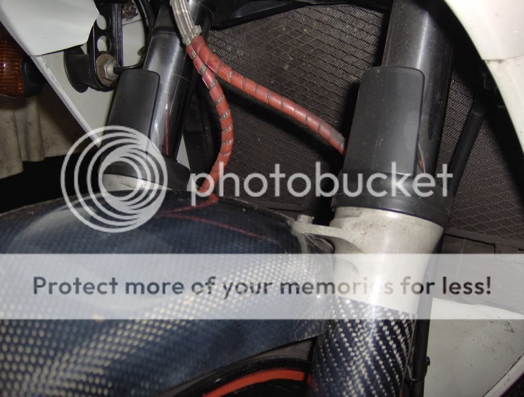

Just take your time.Keep things clean.Do not be afraid to admit defeat and take the forks to the shop.This will cut down on the time that a bike shop would otherwise charge you for doing the easy bit.
Once sorted,shop around to buy some fork gaiters or protectors
https://i666.photobucket.com/albums/vv23/WiNot_Rhencullen/Workshop/20091222_6.jpg
