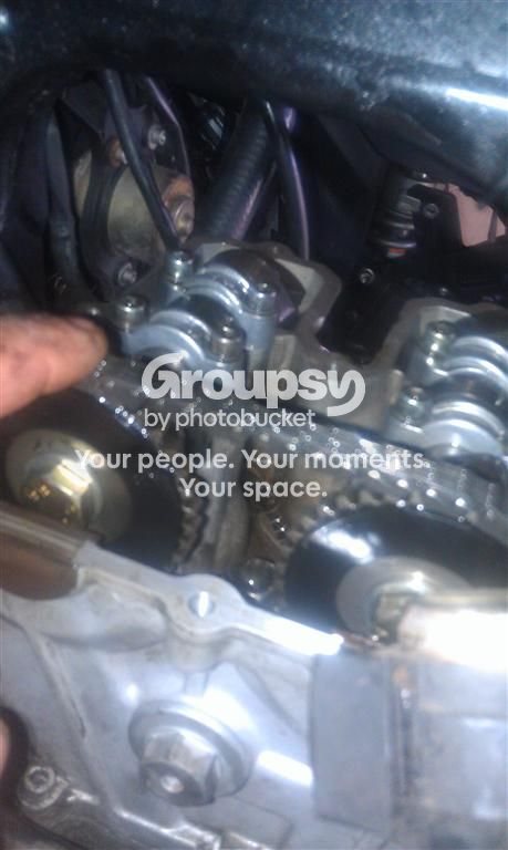

any way bike : rotax 5 valve engined aprilia pegaso 12k miles (20k kms)
the story: was riding home a few nights back, bike started making a knocking noise under load, fine when sitting still,
what ive done: pulled all the plastics and shit off and thought i'd do the clearances anyway, done the clearances all a bit tight, but nothing major, new shims etc,
what i noticed: when i was priming the oil feed tension'er (hydrolic tensioner) is that the chain gets loose and then tight on the 2 cams
eg
tight
https://i58.photobucket.com/albums/g257/hmmmnz/IMAG1251Medium_zps4bb4fbe3.jpg
loose
https://i58.photobucket.com/albums/g257/hmmmnz/IMAG1252Medium_zps5b97156a.jpg
https://i58.photobucket.com/albums/g257/hmmmnz/IMAG1253Medium_zps89a174c8.jpg
thats with the tensioner out, the tensioner can take up some of the slack, but it almost looks like its going to jump off the cam sprocket or skip a tooth,
its like the bottom crank sprocket is oval
what does the bcf massive think??

My hands-off guess is the slack between the two fixed distance shaft centres is changing because the cam chain tensioner is varying the amount of tension it applies to the chain allowing the secondary shaft to rotate and altering the chain length between it and the primary one.
However there's an outside possibility that if the sprockets are bolted to the shafts, they are somehow running eccentrically. Measuring the distance between the sprockets between tight and slack positions might yield an answer... as might inspection of the pump responsible for the oil feed to the hydraulic tensioner.

If your problem is the same as the one in the utube clip, it looks like the chain is knackered/stretched.

well i can tell you officially that my chain isnt stretched, its well within the rotax manual specs, its almost new,
those pics are with the tensioner out,
the point i was trying to make was that the chain gets tight, and as it rotates around it becomes loose, the tensioner shouldn't have to take that up, it should be there just to but pressure on the tensioner arms
oh and the tensioner is also fine and working as it should,

The knocking might be coming from somewhere else and this chain slack 'problem' a red herring. I cant make out the cam positions fully but this is what would normally happen.
In 3 out of 4 cycles one or both sets of cams make contact with the shims and therefore under resistance from valve spring pressure. So the chain is very tight everywhere except between the last camshaft and the tensioner. It's tight between the crank and the first camshaft being turned, then tight between the first and the second camshaft which is being rotated by the first, with all slack to be found between the second camshaft and the crank where it's reduced by the tensioner.
However during one cycle, top dead centre on compression; both cams are free to rotate because they are no longer subject to any valve spring pressure. So it is now possible to position that slack anywhere along the chain's length. Pressing down on the short run between the shafts simply moves all the slack from the front and back vertical runs to the horizontal one.
The chain slack should disappear once a correctly working hydraulic tension is fully primed and operational and would be subject to reappearance after any leak down suffered by the tensioner.

presumably, with the tensioner out, it would get tight again whilst one of the inlet or exhaust valves its being compressed by a cam then slacken off when not under tension.

If the chains a bit slack then the bagginess in it will move about depending on the loading from the valve springs on the cam lobes , sometimes the pressure will try and turn a cam backwards in certain positions hence you see the variance, this will not happen if the chain is tight, so really the question is why is the chain that slack? most cam chain tensioners can come out to tension the chain but then have a mechanism inbuilt to them to keep them out once they have moved to adjust slack in the chain. Also remember there is usually a little in built slack in the design to allow for expansion of the engine and subsequent engine tightening.
Tl:DR check the cam chain tensioner works properly.

The slack appears to be between the cam wheels, not between the inlet cam and the crank which the tensioner controls.
The chain tensioner cannot put any influence on the slack between the two cams because the engagement of the chain to the inlet sprocket should prevent this.
O.P. what; if anything; is in/on the underside of the cam cover.
Some engines have a rubber pad that prevents excess chain slop between the sprockets if it becomes extreme. In this type of engine it is not recommended to run the engine without the cam cover fitted, they chain can skip a tooth on the inlet and cause damage. The bike in the vid shows that it is very near to that point.
YBR Rick's explanation is most plausible.
