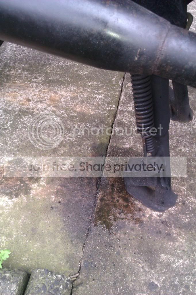

The exhaust is leaking a lot as in the photo below, not sure if its petrol or stanky moisture??

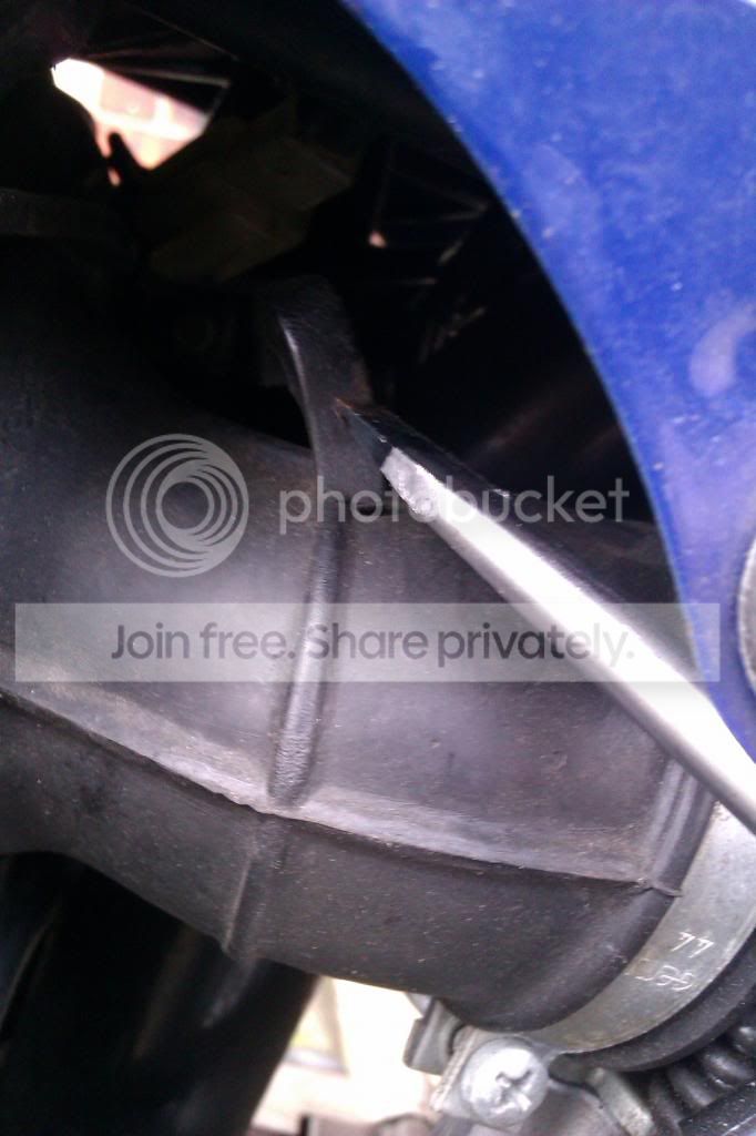

Also the rubber air inlet from filter to carb looks like the rubber hook at the top of it is rotting, not sure if its just the hook on top or if that hole goes right through, didnt care to push too hard on it.

I finally got the chance to remove my Carb, strip it and clean it.
Turns out this was the problem all along.
So a digital 12 pack of beers for you all for helping steer me in the right direction! Smile
Just to update for all the noobs like myself who may encounter this problem...
The loss of power was purely down to the fact I was riding on half choke at those times, as lately it wouldn't ride any other way.
It's hard to say *exactly* what the cause of the stalling was, as there were so many problems:
Sticking throttle slide (covered in black shit)
black shit on the throttle needle too
caked on yellow oxidation throughout the entire carb bowl
caked up jets
the list goes on, but it all revolved around shit caked everywhere
It seems that it all may have stemmed from the "mechanic" who has been the only person besides myself working on the bike, has thrown away my rubber gasket from the airbox (probably 6 months ago when he was meant to clean the carbs...), causing it to cake up, then the filters which were covered in what I can only describe as a mixture of Piss and Jizz.
But I cleaned it all up and refitted it, started fine first time, sounds healthier too (not that I would really know).
I can rev the tits off it now tho, so here's hoping its all good in the morning. Very Happy
