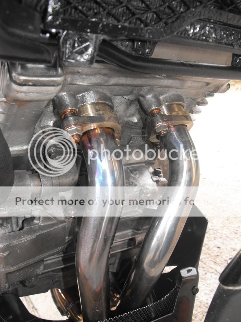

Now why do that ?
Not only will you have wasted money on a crap welder but you will need to fork out on headers,
Thin header collars are not the place to learn welding on .
https://i1159.photobucket.com/albums/p626/willandrip/TDM/TDM%20FINISHED/006_zps765455db.jpg
