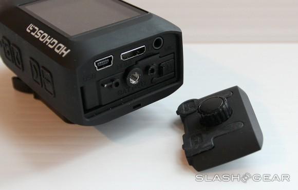

I think it might [cautious here...] be okay. The back-panels off the camera in the pics I posted here but i've got one of the ones with flip up easy-access tabs on its way in the post, so the tab should stop most rain whilst static, and on the move the rain should get deflected by the camera and battery pack, I hope Mr. Green

Not sure about The Ghost range but the Drift HD has a second back door which facilitates cable entry for a power lead and Mic Lead. I make them fairly waterproof by using a blob of this stuff at the point of cable entry https://www.actioncameras.co.uk/black-tack?
I do the same with GoPro's by using a Dremmel to make the cable entry on a waterproof case.
