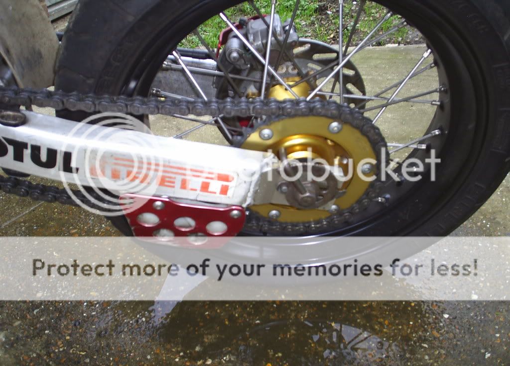

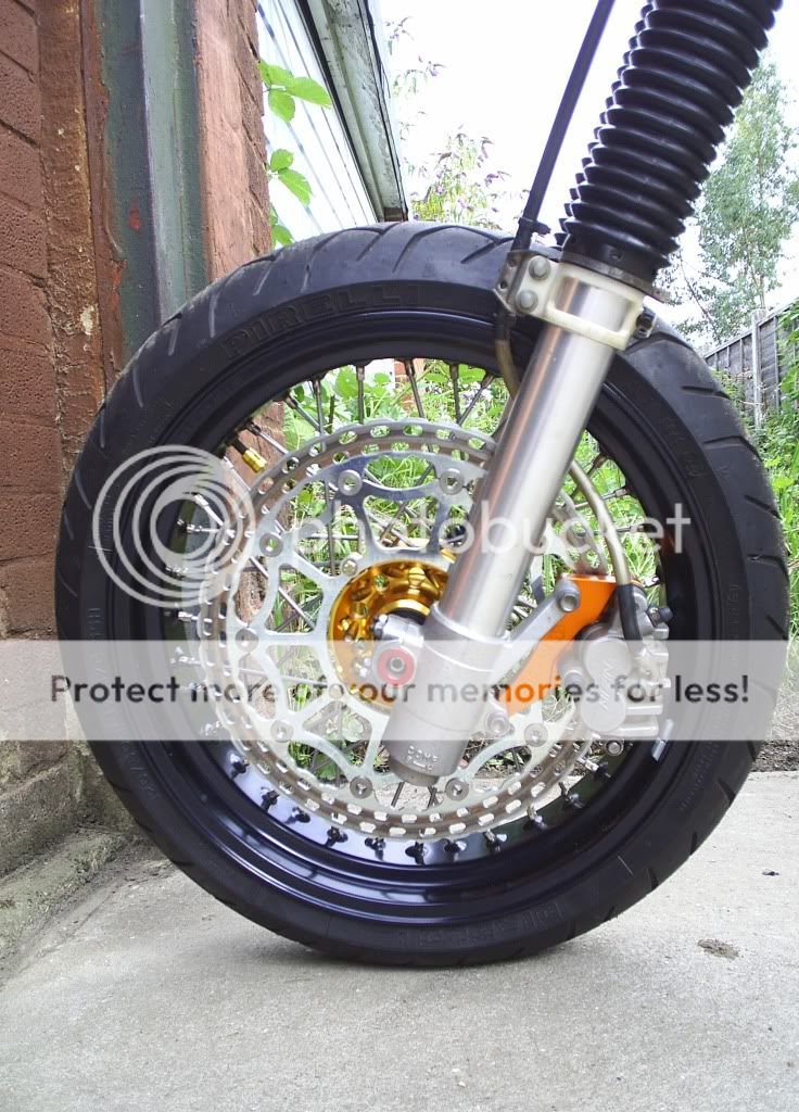

Pics from sale - will get better ones at weekend.
https://i116.photobucket.com/albums/o22/fv53wkr/_581_zps43a8ff7e.jpg
https://i116.photobucket.com/albums/o22/fv53wkr/_58_zpsc18b3cd2.jpg
https://i116.photobucket.com/albums/o22/fv53wkr/_582_zps6864e9cf.jpg
https://i116.photobucket.com/albums/o22/fv53wkr/_583_zpsf53a38f1.jpg

Look like standard hubs to me.Talon hubs are CNC machined from billet and serial numbered
https://i666.photobucket.com/albums/vv23/WiNot_Rhencullen/Workshop/2013-02-01_142907_zpse611d6d0.jpg
https://i666.photobucket.com/albums/vv23/WiNot_Rhencullen/Workshop/Picture012-1.jpg
https://i666.photobucket.com/albums/vv23/WiNot_Rhencullen/Honda%20750/My%20bikes/Picture243-1.jpg
Best thing may well be to install the wheels and,using a straight edge,see how much offset there is - if anything.Talon may well be able to machine a special front and/or front sprocket so that A)The offset is correct and B)There is sufficient clearance between the chain and the edge of the tyre.
As those hubs look OEM and may well be DRZ-S or E,there is no cush drive.So make sure that there is sufficient slack in the chain or the gearbox output shaft bearing can be ruined very quickly.I adjust the slack on my XR-SM by compressing the suspension and allowing about 25mm.

/\ Very useful, thanks. Took a while to get the chain tension right with weight on but got there in the end.
Tried leaving the bigger discs on, not a chance. Need an adapter plate for the calliper I imagine?
https://i116.photobucket.com/albums/o22/fv53wkr/Gixer/566B5201-4FFC-4B05-8C6D-6083DC66941F_zpsdaujdgyr.jpg
Same story with the rear disc, but it was much closer. 24cm Vs 22cm, so still had to switch them. Those allen bolts are a tad tight Laughing
Did a straight swap with the sprocket, I'll just have to see what the gearing's like when I take it out.
https://i116.photobucket.com/albums/o22/fv53wkr/Gixer/633A8706-061B-4A8A-B752-9CBE8D7FD6ED_zpsrlfkwr4l.jpg
https://i116.photobucket.com/albums/o22/fv53wkr/Gixer/122AE206-AF09-4E71-8304-612407C1743C_zpsqcxnoehy.jpg
