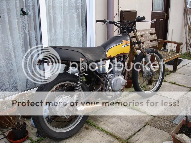

Here's how it was about 3 years ago...
https://i834.photobucket.com/albums/zz267/pdg555/bike/XL250K/bikeside.jpg
https://i834.photobucket.com/albums/zz267/pdg555/bike/XL250K/bikerearright.jpg
Later that day it looked like this
https://i834.photobucket.com/albums/zz267/pdg555/bike/XL250K/bikeminimal.jpg
Then I took it apart some more, put all the bits in various boxes and put it away thinking "I'll get that done soon."
About 3 years later and it's today. The only thing I did to it in the meantime is fit some different tyres to check clearances (which I never actually did).

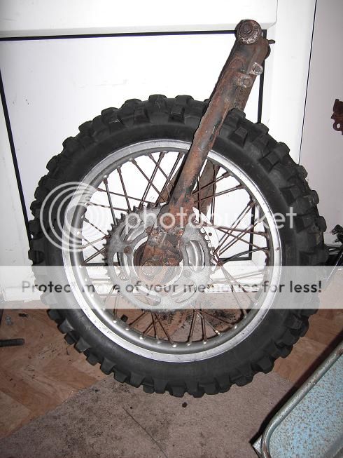

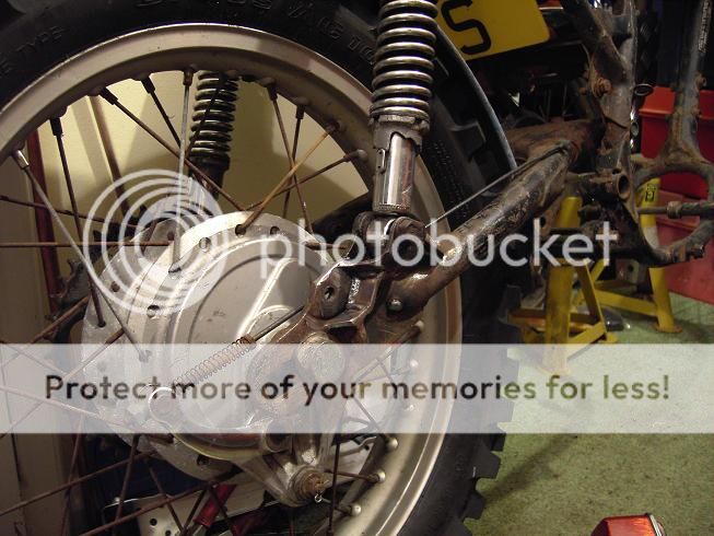

So, swingarm and wheel in:
https://i834.photobucket.com/albums/zz267/pdg555/bike/XL250K/PICT0714.jpg
https://i834.photobucket.com/albums/zz267/pdg555/bike/XL250K/PICT0713.jpg
Yes, that is a bit of wood instead of a rear shock, I've got the shocks in bits to clean up...

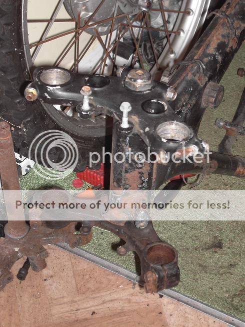

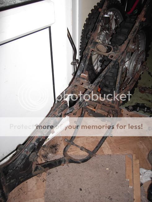

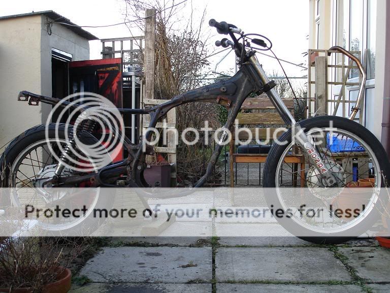

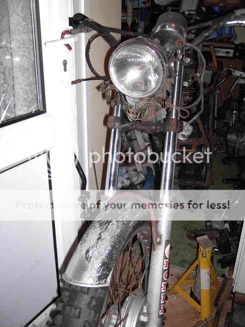

Then the yokes:
https://i834.photobucket.com/albums/zz267/pdg555/bike/XL250K/PICT0716.jpg

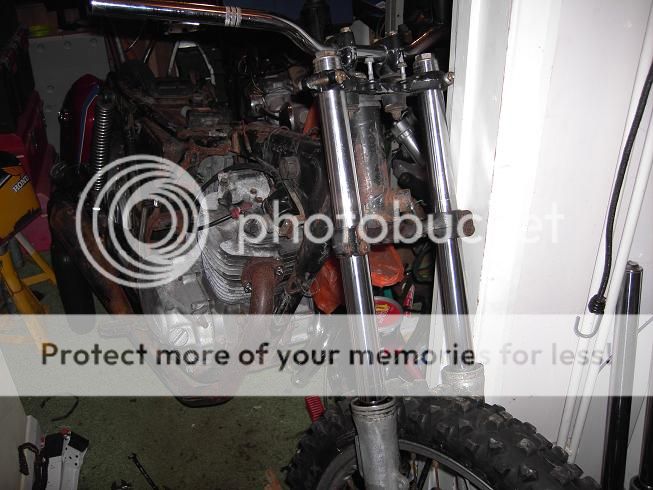

And forks, front wheel etc:
https://i834.photobucket.com/albums/zz267/pdg555/bike/XL250K/PICT0717.jpg
Now I've created a problem for myself - the handlebars are too wide to fit through the door! I think I'll stick a narrower set on while I'm messing for now, at least I'll be able to move it easier then.
At least it's now rolling Very Happy

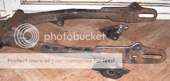

One of the things I wanted to sort was the low back end. The shocks I have are shorter than standard and stock length units seem to be a bit difficult to find and/or expensive for the quality. So, a much easier prospect than buying new shocks was to make new mounts....
Before with mounts prepped:
https://i834.photobucket.com/albums/zz267/pdg555/bike/XL250K/arm_before.jpg
And then after, these aren't the shocks I'm using, but they are the same length:
https://i834.photobucket.com/albums/zz267/pdg555/bike/XL250K/PICT0724.jpg
As it is, I've now got about a 10mm lift on the back over stock, which makes it sit much better.

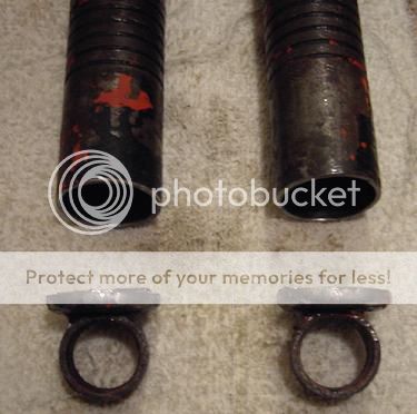

I cleaned up the ones I had a bit and as it turns out they are a bit worse than I first thought.
https://i834.photobucket.com/albums/zz267/pdg555/bike/XL250K/oldshock.jpg
So, time for a newish plan. I got these.
https://i834.photobucket.com/albums/zz267/pdg555/bike/XL250K/newshock.jpg
Which I could do this to:
https://i834.photobucket.com/albums/zz267/pdg555/bike/XL250K/internals.jpg
Right, so I have springs that I can fit to these but there is the continuing problem of length - but for this I have a cunning plan..........

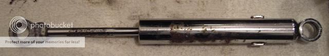

I had one set of slightly knackered shocks that were too short anyway, and one set of serviceable shocks that were also too short. What to do......
https://i834.photobucket.com/albums/zz267/pdg555/bike/XL250K/cutshocks.jpg
https://i834.photobucket.com/albums/zz267/pdg555/bike/XL250K/shockbottoms.jpg
That.
https://i834.photobucket.com/albums/zz267/pdg555/bike/XL250K/mockupshocks.jpg
Look at that, they're longer Laughing

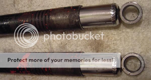

Got the shock bodies welded up:
https://i834.photobucket.com/albums/zz267/pdg555/bike/XL250K/shockbody.jpg
Got about an extra 35mm on there now, I might also change the top rings to match the new bottoms.
