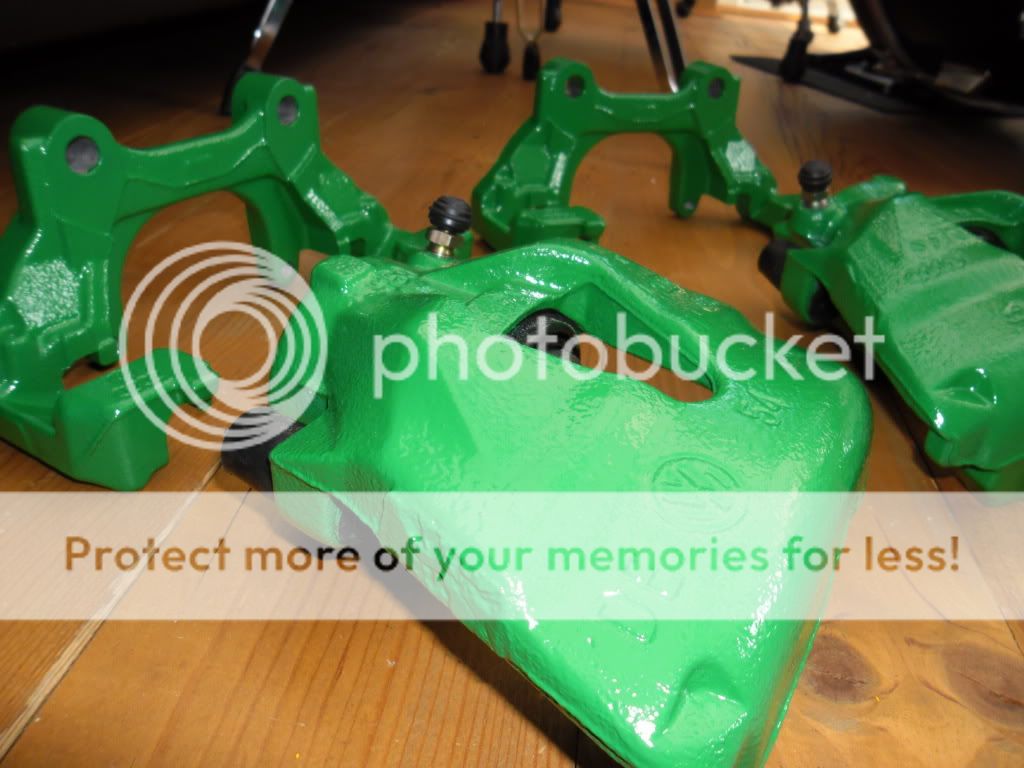

PostPosted: 22:17 - 05 Aug 2014    Post subject: Reply with quote
Ben90 wrote:
I've painted my car brake calipers with it and after 2 years of heat, brake dust, road crap, caustic wheel cleaner and pressure washing they still look as good as the day I painted them, finish isn't amazing but really good for a coat-and-forget application.
I did mine off the car and by brush too.
I baked each coat on in the oven and did about 10 coats altogether.
Pretty happy with the finish on mine I must say.

grr666
Joined: 16 Jun 2014
PostPosted: 08:45 - 07 Aug 2014    Post subject: Reply with quote
Ben90 wrote:
I bet Mrs grr loved that Laughing
Nope.... Mr. Green
https://i832.photobucket.com/albums/zz250/grrthefearless/Brisky%20shots/SAM_0398.jpg
https://i832.photobucket.com/albums/zz250/grrthefearless/Brisky%20shots/SAM_0397.jpg
Laughing Laughing Laughing
