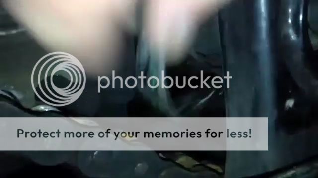

so after speaking with bike nut on how to adjust clutch cables and other things i got to the point of giving up.
i managed to get the bike in a position where as i could go into first and move to about 5-6MPH Before bike cut out again.
so as you do, i lay down with my hands in my head and as i looked toward the bike could see something upon the chain.
non the less was a beyond mangled wire Shocked Brick Wall
followed wire and it was for the side stand switch.
so i bypassed the side-stand safety switch un-mangled said wire checked nothing chain wise was was injured and hey presto bike worked woo! Mr. Green
(also had to fix wiring for indicators as when i was previously checking electrics like others suggested i got one snagged on the metal frame behind the centre console)
none the less so pleased, as a mechanic was gonna come out and charge me £20 for picking the bike up then aprox £30 for doing the work
so saved £50 win win really.
anyway cant believe i didn't spot this before, i even sat and had a look at side stand switch. but wasnt until i was laying down with a view of underneath the bike that i noticed,
anyway.
damage video below
chains been tightened as per manual lubed and gave it all a good clean
https://vid123.photobucket.com/albums/o320/DEZ_1991/IMG_2845_zpsuend9lv1.mp4
