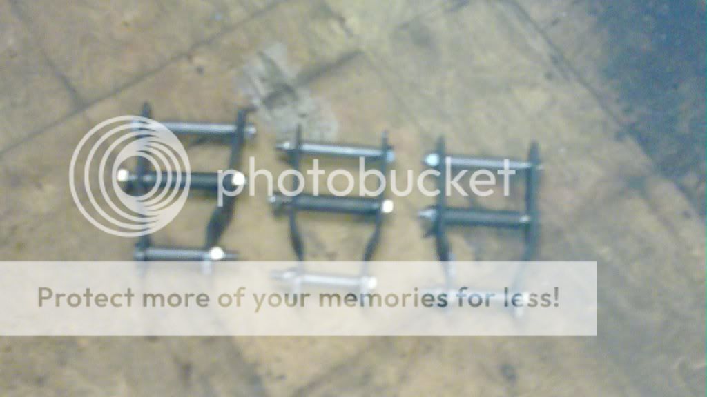

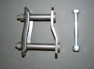

I thought about that, but when I googled the images of the existing shackles there seems to be some sort of brace bar on lift shackles & an awkward bend on the standard ones.
OEM
https://i.ebayimg.com/00/s/MTE4N1gxNjAw/$(KGrHqJ,!hIE7S9(i99)BO1lTo2bR!~~60_35.JPG
2" lift
https://i766.photobucket.com/albums/xx307/n00dle247/suspention%20lift/20101029_002.jpg

If you dont go too long a brace bar is not needed. Gives better flex without them anyway.
dont worry about the bend. 2 flat bars go on and just taper together anyway. They are rubber bush mounted.
Will try to get some photos of mine.
