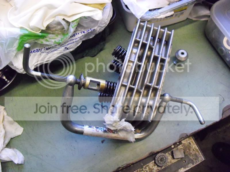

I modified a standard adjustable valve spring compressor by utilising a scrap length of old Renthal handlebar tube.I originally used this method for use on my Exup1000 but found it just as useful on a friends XR250 cylinder head
https://i666.photobucket.com/albums/vv23/WiNot_Rhencullen/Workshop/CIMG2952.jpg
I used the same device for removing the valves from the head of a Yamaha R1
https://i1073.photobucket.com/albums/w384/Rhencullen5/Picture014.jpg
