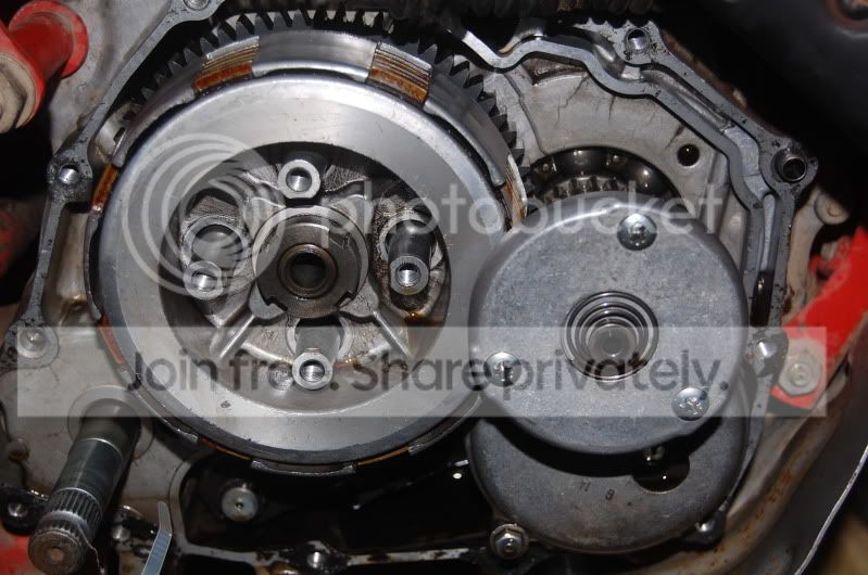

Had a look at my spare engine, the cases have to be split to get at the K/S mechanism.  On my engines the whole mechanism is enclosed by part of the crankcase, the earlier engines have the mechanism exposed!
Not my photos
Older engine:-
https://www.xl250k3.com/photographs/revealed.JPG
Newer engine:-
https://i558.photobucket.com/albums/ss22/Snorkelmb/DSC_0006-1.jpg
