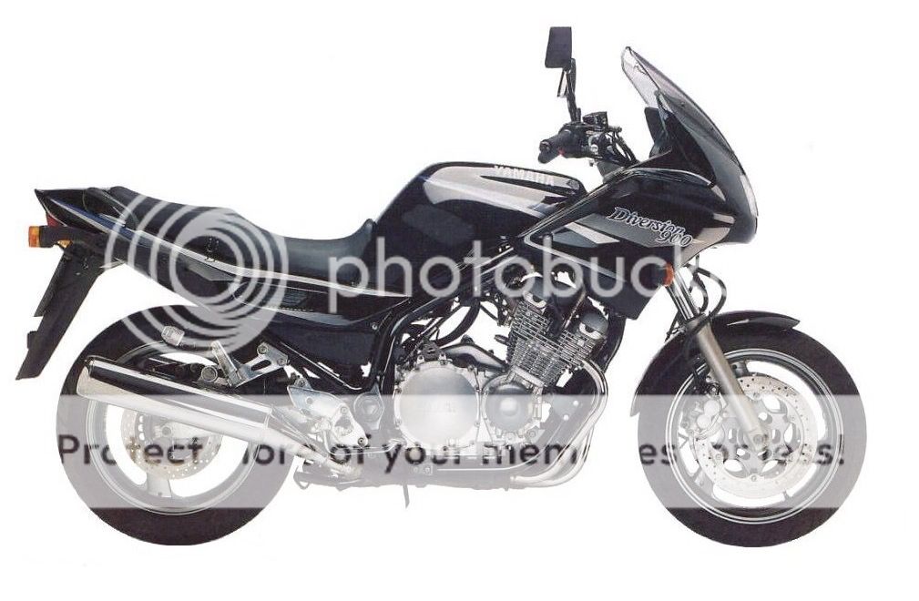

Have you looked at 900 divvys? Cheap to buy reliable shaftdrive. Center stand and they usually have luggage to Thumbs Up
https://i1128.photobucket.com/albums/m492/sidewinder11/55539329e981fb49cf73bc78565846ca_zpsc4233220.jpg

The Divvy 900 is a good call. Slightly less weather protection but good enough. Faster, obviously, and another of my favourite bikes.
If you do go down that route, watch out for bikes with a ropey rear shock. Very hard to get a direct replacement although, as per the Divvy forum recommendation, I installed an early Fazer 600 (red one) and it was fine.
Centre stand failures are very common and hard to replace.
Otherwise a great, well built, bike that should easily see off 150,000 miles. Still a very under-rated motorcycle and cheap as chips.
