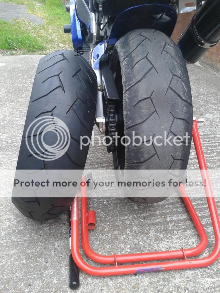

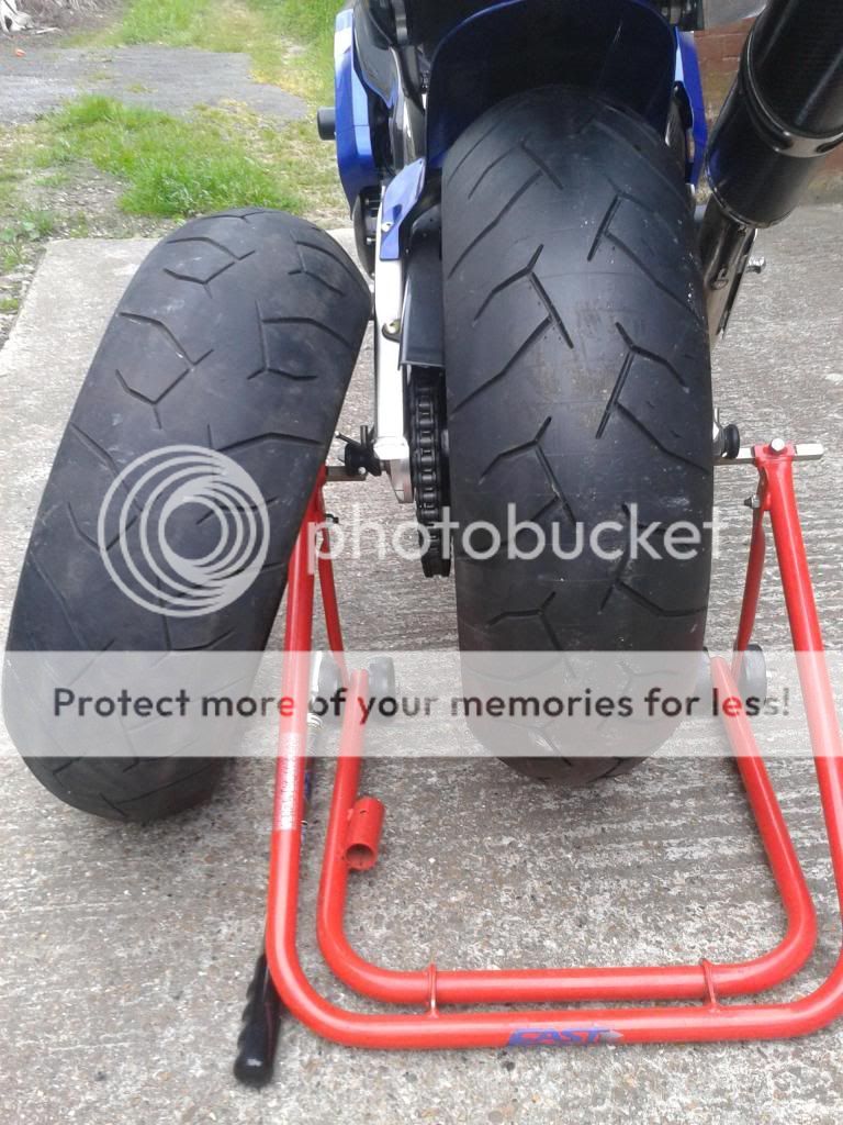

These levers are recommended
https://i666.photobucket.com/albums/vv23/WiNot_Rhencullen/Workshop/0014614_michelin-type-tyre-levers-15-inch_300_zps0485af63.jpeg
When I got a puncture the day before last years Mayday Run I luckily had a spare to hand and it only took about 35 mins to change them over
https://i666.photobucket.com/albums/vv23/WiNot_Rhencullen/Workshop/2013-05-05180802_zps1d7bcb5d.jpg
https://i666.photobucket.com/albums/vv23/WiNot_Rhencullen/Workshop/2013-05-05192034_zps1a1c1a4f.jpg
I did not bother to balance the rear afterwards,but if it had been a front tyre I use a rig that I bought from Hein Gericke for £40,which does the job
https://i666.photobucket.com/albums/vv23/WiNot_Rhencullen/Workshop/2014-11-15163656_zps7a23eee7.jpg
You can buy tyre soap from most on-line places and I would find it quite difficult to change a tyre without using this stuff.It is possible to use a footpump,but as I bought a good value for money compressor a few years ago,then I use that to seat the tyre correctly.
If anything,I now find it easier to change a tubeless instead of a tubed tyre,because the sidewall of the enduro tyres are far stiffer and it is a bit of a bugger to get the valve stem of the thick inner tube located through the hole in the rim Evil or Very Mad
