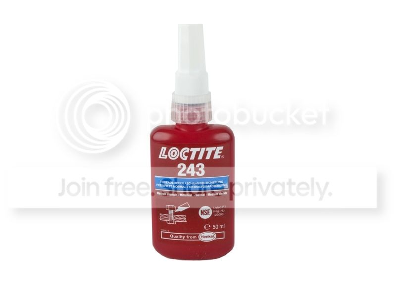

Use a torque wrench and loctite.

https://i37.photobucket.com/albums/e85/motorcyclesJZ/Random/Art88000012_zpsfsgk6v0f.jpg

Don't overtighten them though, you'll strip the threads in the engine. I did that on my TT600, and I had to helicoil it.

+1 for Loctite - but tighten the bolts when the engine is hot.

Take care when using loctite near fairings. My mate had three front mudguards crack around the bolt holes after he started using loctite to fix the bolts in. Turned out that the curing vapours were making the lugs go brittle.

I've torqued them up to 40nm as per the instructions. Just surprised they are undoing so quickly.
I shall invest in some loctite i think. it doesn't touch the fairings, just pops through the vent on them.
