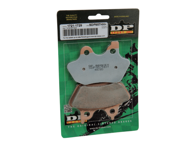

I've currently got Dunlop DP Sport pads fitted to the divvy (I have blue spot callipers on it).
https://assets.suredone.com/1744/media-pics/17211729-dp-brakes-sport-hh-ceramic-sintered-metal-brake-pads-05-07-harley-twin-cam.png
They're a vast improvement over the previous EBC pads IMO, but a bit like tyres brake pads tend to come down to individual taste. Still, I wouldn't hesitate to recommend based on my experience.
