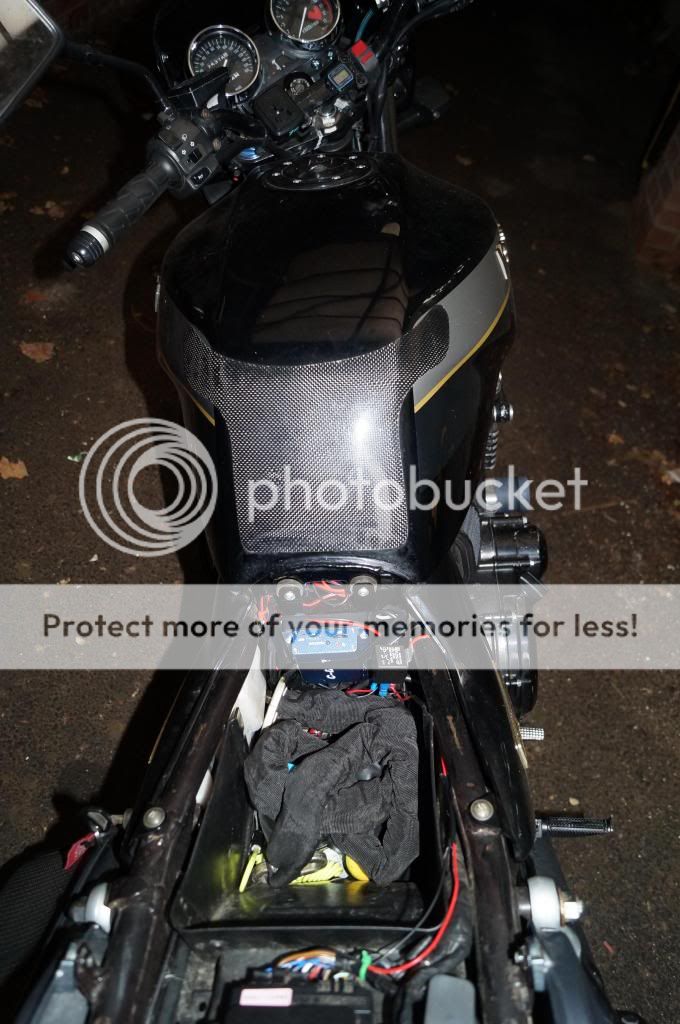

I've posted it before but I rigged up my own version of this. Used a mini DVR off ebay wired in under the seat and a cctv bullet cam, powered from a relay that switched off of the rear brake light (I think). This was fed through a rectifier board to keep everything at 12V, and the camera positioned under the headlight at the front.
Everything records 640x480 to a mini SD card when the ignition is on - 2gb card gives around 3 hrs footage but this can always be bumped up.

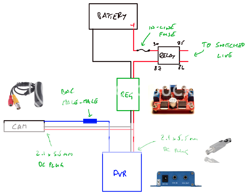

What you'll need:
Arrow mini-dvr
Arrow 12v cctv bullet cam
Arrow BNC male coupler
Arrow 12v regulator
Arrow 4 pin relay
Arrow in-line fuse holder
Arrow box to put everything in
Basic circuit diagram to work off:
https://i1125.photobucket.com/albums/l598/gazzam1/diag_zpsorlzw4md.png

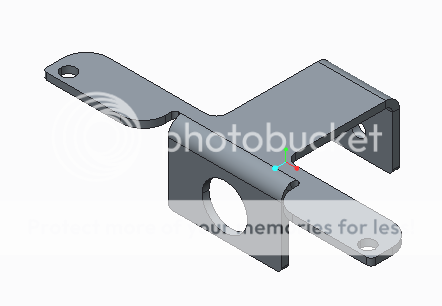

First thing I did was make sure I had somewhere to mount the camera - ended up bending up a piece of acrylic that I cut out at work and bolts to the bottom of the headlight mount on the bike. To be fair this could be anything, I was just lucky! Camera slots through the hole at the front (facing left) and a bolt holds it in at the back side through the smaller hole. (It'll see if I can get a better pic of it on the bike later)
https://i1125.photobucket.com/albums/l598/gazzam1/Capture_zpslcmsxjkl.png
Once I had that sorted I made up some cables to run 12v to the dvr and camera. Conveniently they both used the same 2.1x5.5mm dc plug which made things easier - soldered those on to some wire I had making sure I got the polarity of the pins the right way round with the outside barrel of the plug being neg-, pin inside pos+. The video connection was done using the BNC cable provided with the dvr - there was just enough space to run the cables direct together with a BNC male coupler between them.
Next was to sort out the regulator - this means that a constant 12V is supplied to the camera/dvr rather than the 14-ish V you get when the bike is running which could fry the dvr. I wired it through a fuse and relay to the battery (check out Stinkwheel's relay thread). I got the bike running and measured the output across the 'out' side of the regulator. This can be adjusted by turning the little screw on top of the blue unit on the board. Once this was set to 12V I put it inside a small ABS box I had kicking about and bolted the DVR to the top of that. I then put the whole thing under the seat out of the way and voila! Video quality isn't fantastic but it does the job.
https://i1125.photobucket.com/albums/l598/gazzam1/DSC03758_zps56cd9f35.jpg
