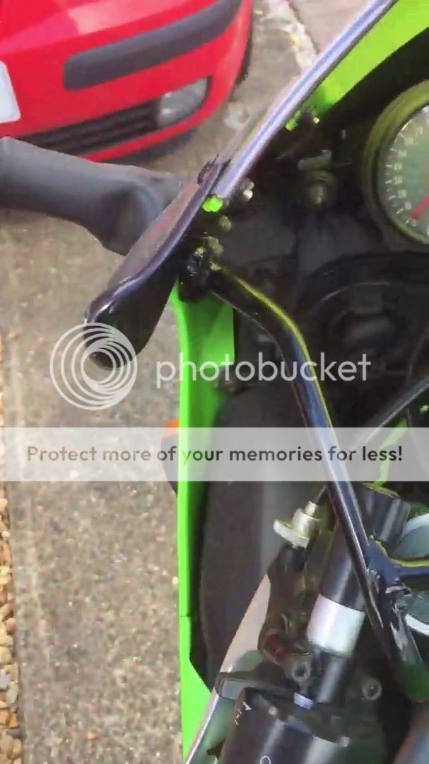

Apologirs, try these
https://i300.photobucket.com/albums/nn31/mikey123999/Mobile%20Uploads/th_trim.57DD9E26-E2FB-4F0F-857B-E74BE7CFA111_zpswivwxcdj.mp4
https://vid300.photobucket.com/albums/nn31/mikey123999/Mobile%20Uploads/trim.57DD9E26-E2FB-4F0F-857B-E74BE7CFA111_zpswivwxcdj.mp4
I don't think it would be anything electrical from the noise Sad

Yeah that's definitely a mechanical noise. Doesn't sound too clever.
Could be that a valve has hit a piston, it sounds like it's running on less than four cylinders as well, so it might be two cylinders affected.
Sounds like something in the top end. Could be the cam chain as it seems louder on the right? Maybe it has jumped a few teeth, then bent your valves, which could explain why it went from a quieter tick to a louder one.

that does not sound nice, expect engine out and major strip to locate issue.
