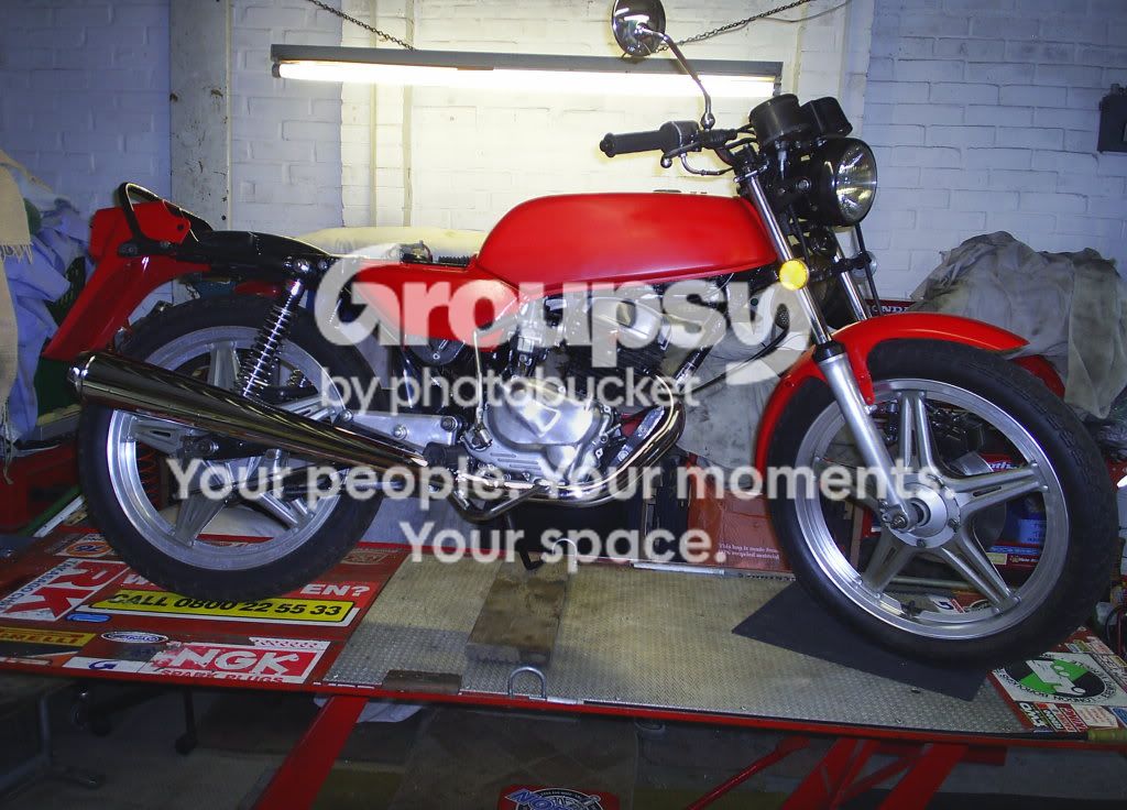

Once the engine is hot,perform a compression test.Then drop some engine oil down each spark plug hole and do the same test again.If there is a big difference between the readings then the piston rings may well have not been run in sufficiently.
Also,check the resistance of the plug caps.On my CB125T2 the plug caps that were on the bike when I bought it were seriously leaking some of the coil output.So I installed new NGK caps and this cured the problem.
